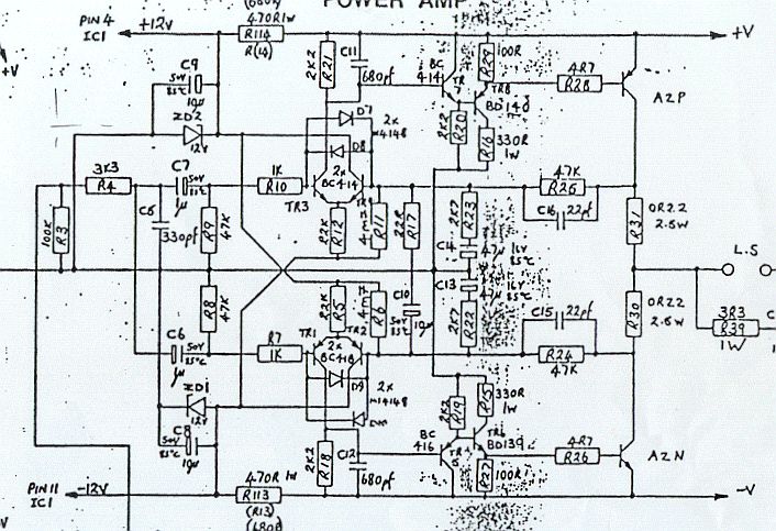

Anybody familiar with these monoblocks? One of mine keeps blowing the fuse on turn on, so I'm trying to diagnose where the problem is. A schematic of some sort would help but I can't seem to find one. Any help would be much appreciated.

MF A1 and A100 are great amps and despite their problems, schematics and useful hints are widely available on the net – mhennessy site is first choice…
I would like to know more about M50 too. Is it just A1 with serial or parallel output connected transistors or something else?
Pictures will be useful.
About repairing, usual hints for A1/A100 like changing all el-caps do apply, but you first must find all shorted transistors and all open resistors. When you have one good channel or mono amp, just open it and measure. There aren’t too many parts, so you will find faulty components in no time.
I hope for the best, and here a schematic from the net that may help you.
Chicco

I will refer to Mark Hennessy's schematic here as it's the most comprehensive one. It says it's for the A1 but the MA50 is just an A1 with no preamp.
http://www.mhennessy1.f9.co.uk/mf_a1/a1_schematic.jpg
D1-D4 are not zener diodes, these are standard rectifier diodes. If you've put zeners in here, you need to replace them with standard recovery rectifier diodes such as 1N5403.
Check the VDR (the resistor with S-shape through it on the schematic, just after the power switch) to see if it's closed circuit. If it is, desolder it. You can get away with not replacing this, it is for protecting the amplifier against power surges.
Check the power supply capacitors for any signs of bulging. At this point I would remove R1 and R2, then power up and check if the fuse stays intact, and that you are getting +24 and -24V on the supply before these two resistors.
If your output transistors blew, I would also replace the driver transistors. These are the BD135 and 136 transistors. Personally I would replace them with BD139/140.
Bridged A1 output stages, at least it was on the MA50X.
The board of the MA50 not only has all 4 output devices, but both front ends of the output stages.
MF used four 63 volt/6800uF electrolytic capacitors in the MA50, but rail voltages were the same as the 20 watt A1.
MF did not even bother to change the A1 printing on the boards for the MA50s.
Because the channels were bridged was a reason why the MA50s blew up so many times.
