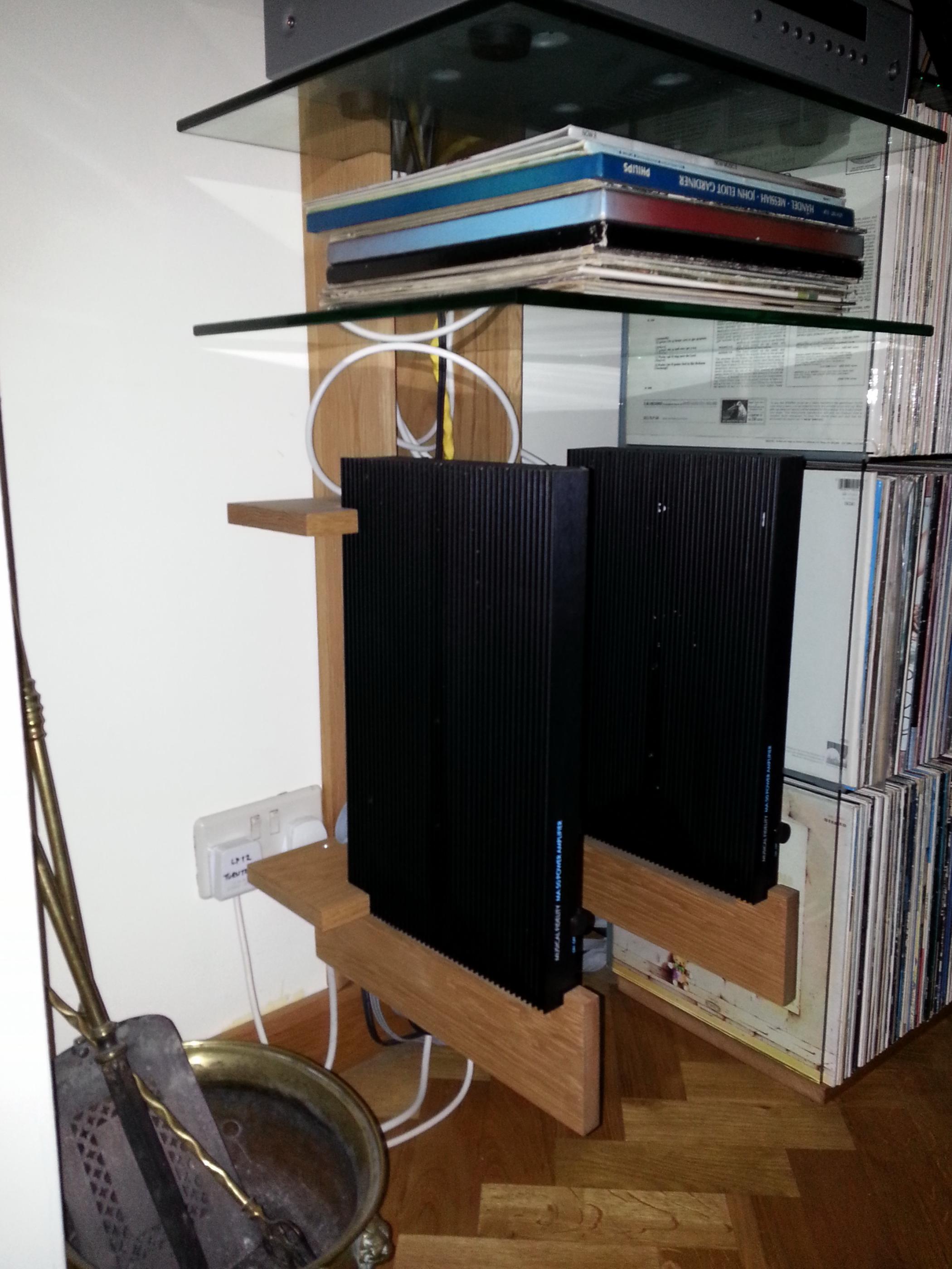

Incidentally, I normally run these amps mounted vertically to aid heat dissipation through natural air flow. I made a rack specifically for them.. here's a pic.
