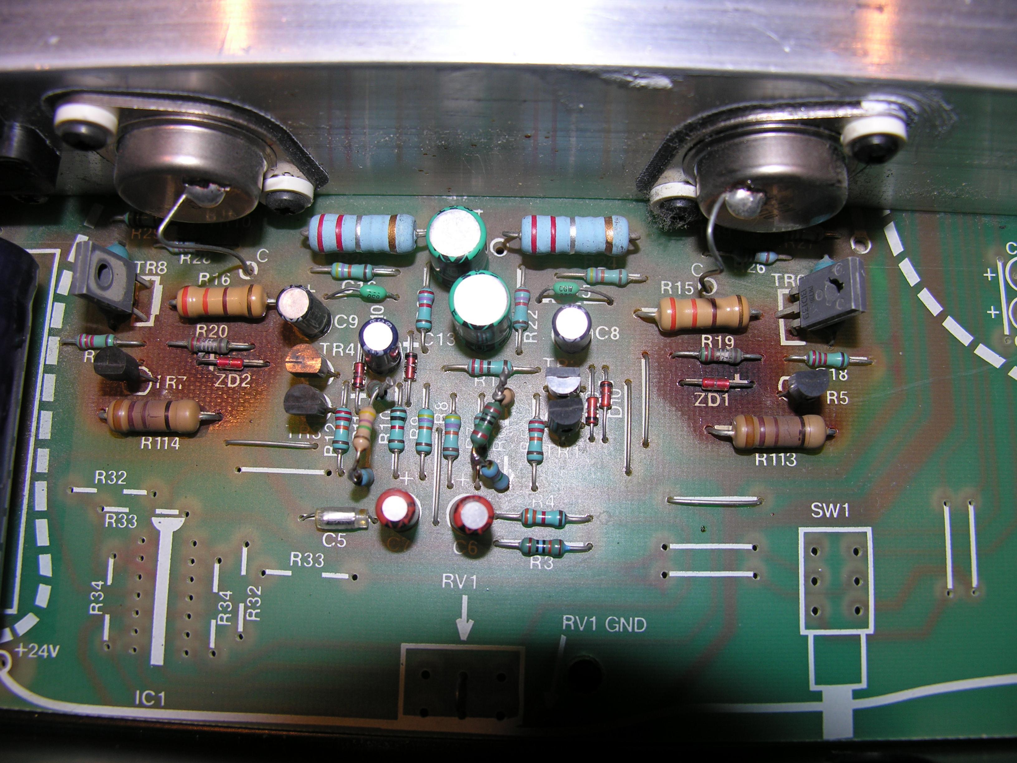

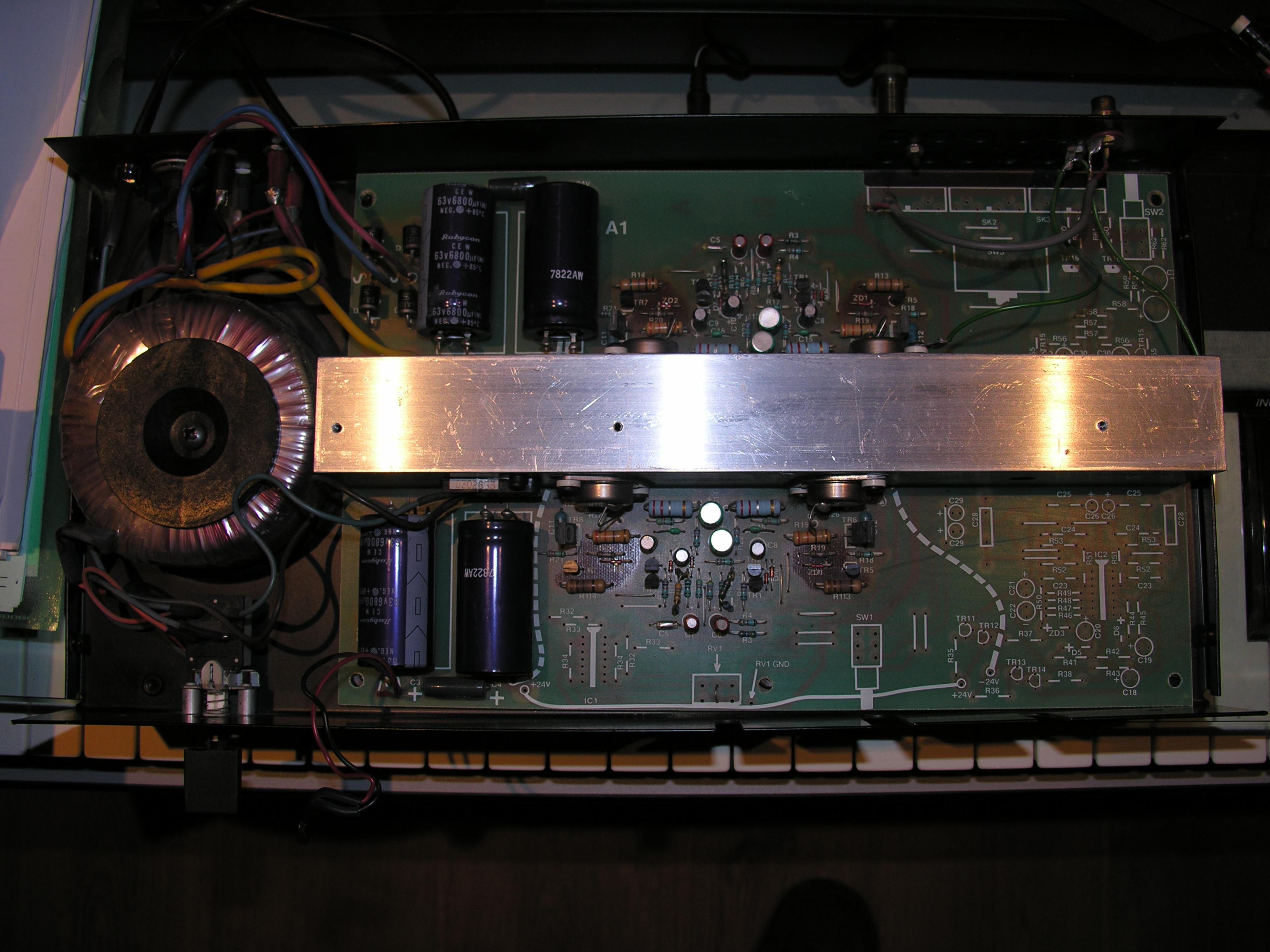

Ah. As that worked, I'll try a photo or two. These are "befores" general layout and heat marks close to the output transistors.

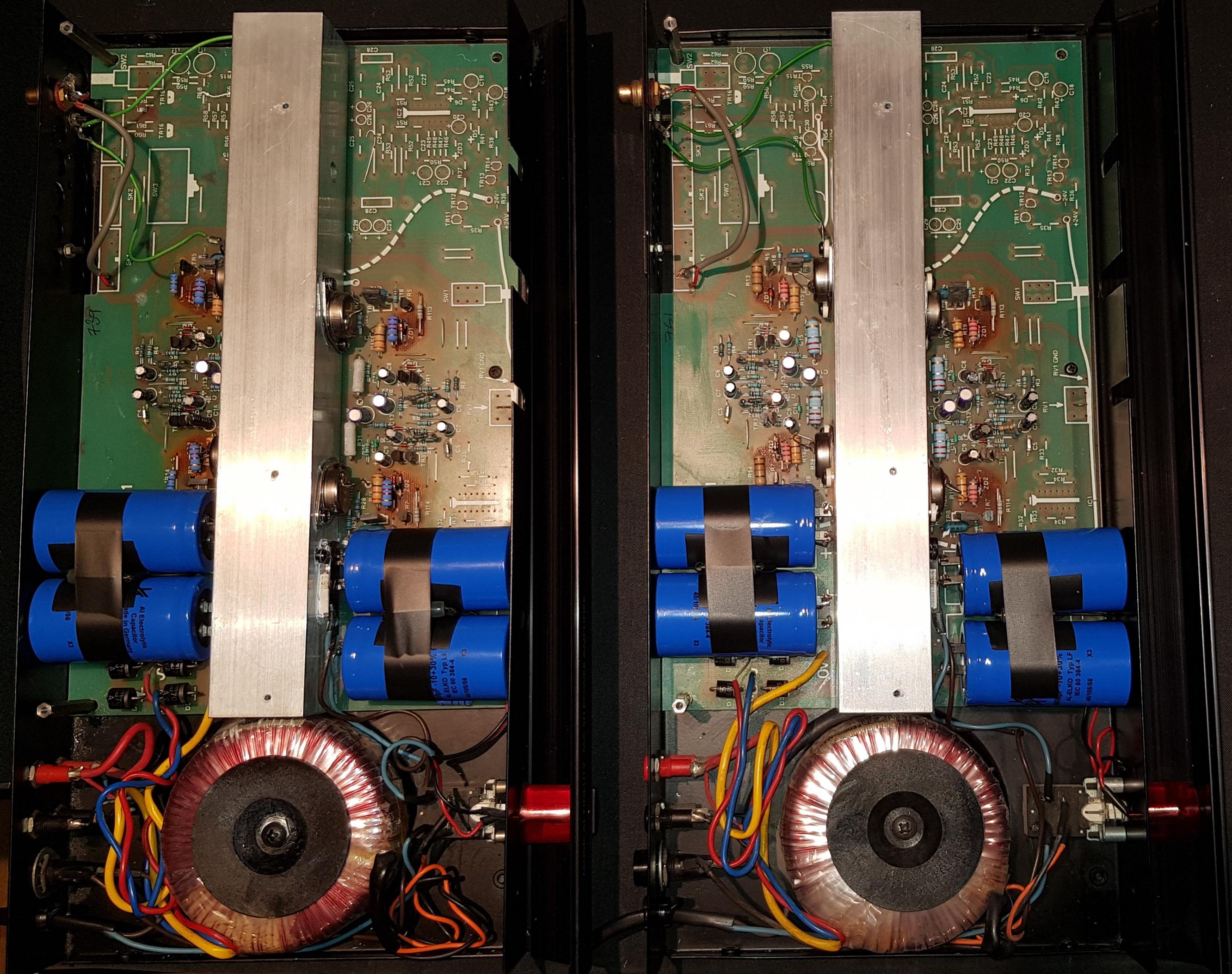

20190822_203329Crop.jpgOkay, so if anyone is stil interested, I have made further discoveries and changes and I also need some help. Firstly, the changes: The areas I mentioned before which look brown and burnt in both amps that I thought was from the output transistors: wrong. The problems causing the brown areas were under-specced resistors and Zener diodes both of which were very much overheating. Resistors 13, 14, 18 and 19 on the right side and 113, 114, 18 and 19 on the left side were all massively overheating as were ZD 1 and 2 on both sides. They were replaced with uprated wattage in each case. Then I found that the resistor used with the mains LED was also shot on each amp. Again, replaced with an uprated wattage silencing the buzz previously heard when the amps were on. I also re-routed and tidied up some scruffy wiring and rubbed down and reprayed the casing (tops and sides) which really made them look good.
Here's the bit I need help with: They sound good. Better than ever before, but one sounds less good than the other. I have searched around until I am going cross-eyed but cannot see what could be causing the problem. It sounds like there's a 6db loss in treble on one amp. Yes, I've tried swapping them and it's definitely one of the amps. Could it be that some other component is no longer working right? Could the transistors in the "hot" areas have been damaged? Until recently they have been very similar one to another but sice all the fettlin' this difference has become really apparent. Any ideas?
