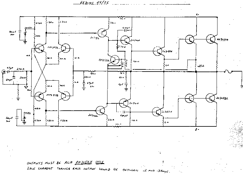

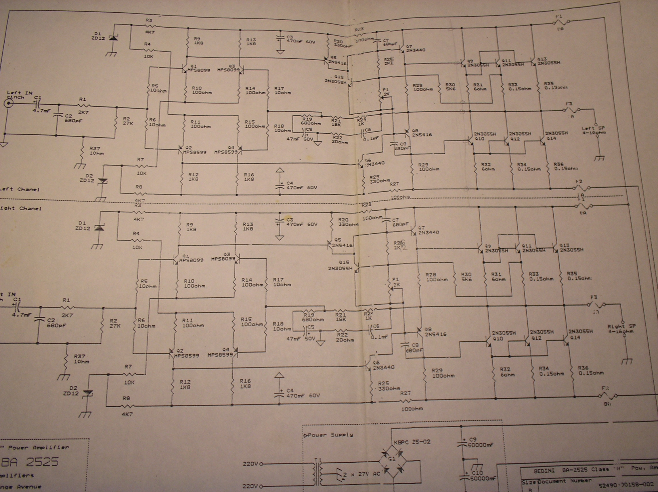

but I have a Bedini 100/100 staring me in the face with a bad offset and a hum coming from it. Can't move around transistors because it's all on the one side, and hum will remain.
Anyone have any ideas, or could possibly provide schematics for even any of the amps from 25/25 up just so I have an idea of what I'm looking for? Thanks!
appear to be in good condition? Visually??
Hardly necessary to shotgun the amp... the amp will run with just one pair of output transistors... into no load and a scope, or maybe an 8 ohm load, and not pushed on the bench...
So, you can identify the good or bad transistors that way.
Of course look for the requisite "0.6vdc" between the emitter and base of each device. If it's not there, then there is reason to suspect a bad device or something in that area being fried.
Any burnt resistors??

best and everything Bedini related I have
not checked , at least not by me
if anyone can check/compare this with own amp , and post updated schematic - I'll be grateful
