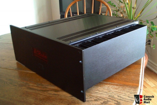

bit of an update
Well I know I keep bumping this thread, but I'm pretty sure my problem no longer lies with the bias. I did a break down of it today. Heres a laundry list of what I did manage to do on this monster.
-Checked all semi-conductors
-Checked all caps
-Swapped power supply from the other channel to see if that would clear up the hum. Offset is reading at 147mv. Still a slight hum coming out of that channel. Unit appears to power.
I did want to go back maybe tomorrow and check the zoner diodes, as I was getting a bit of a low reading on one of them.
Anything else I should check or look for?
I went ahead and touched up the jack grounds too, as that thing was hanging by a thread. The original solders on these units scare me. 😱

Alright, started to sort through the zoner diodes, but I haven't come across anything too unusual.
Kinda stumped again.
does it amplify properly - do you have a 'scope?
Is the ~0.6vdc between base and emitter present on all devices?
You say "checked" how did you check??
Is this a dual mono unit? You say you swapped power supplies??
How about a jpeg of the unit and the innards?
What happens when you short the input?

There's a picture of this beast.
I believe it would be a dual mono.
I checked all the Zeners, and had one reading 28v. I replaced it with a corrective 30v one. The offset then went from 142mv to 180mv. What?!
Still has that slight hum too.
I've also measured the ripple on the main caps. It's definitely a bit higher on the defective channel than the other.
the only thing I really am unsure of is the power boards on this unit. There's so many damn connectors on it, that I'm not too excited to start pulling those off, just to check a longshot.
I may have to do it however. Just wish I had the schematics to do a full sweep of that board without being blind.
