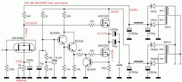

Today, I found another of his creations.
In a Bulgarian forum Daniel started a topic 2007-03-27 ( 27th of March )
Link:
Еднотактен клас А с полеваци
It is a 10 Watt Single End, JFET input - Lateral N-MOSFET output amplifier.
As can be seen in my attached schematic
it features very good, but still not hard-to-find transistors:
- 2SK389BL .... hifi low noise jfet for input - paralleled for 12 mA in first stage
- TL431, BC550C, BC639 for good Output Class A bias control and PSRR (supply insensitivity)
- Two 2SK1529 Lateral MOSFET for Output Stage
- No global feedback from output to input stage
2SK1529 is a Toshiba Lateral MOS of same series as 2SK1058.
But with a bit higher power:
- 2SK1058, rated 07A, 100Watt
- 2SK1529, rated 10A, 120 Watt
See amplabs.com POWER MOSFET data: http://ampslab.com/components_powermos.htm
Here below is is the attachment of this nice
- True Class A
- Single END
- ZERO global Feedback
- Toshiba Lateral MOSFET output
- 10 Watt
- Easy to build Power Amplifier
- Separated input-output power supply
- CLC filtered supply, a la Nelson Pass
Regards

And why only 10w outout but a 250vA Transformer, seems like a Big waste of power even for Class A....Seems like it might be a good space heater......
I"m no expert but it seems a few Changes to the design would probably greatly increase the output power, Like a Bipolar Medpower stage before the Output stage would actually give the Mosfets a good signal to drive the output stage, which is Probably why it is only 10w output and such a big Xformer......
I just finnished building a 30w Guitar amp (into 4 ohm or 18w into 8 ohms) and it uses a simple Opamp to drive a complemtry Pair of Small signal devices (BC550C/560C) which drive a Tip41/42 Pair of 6A devices and only uses a 50vA Transformer, and NO Output Caps, There shouldn"t be any output caps if useing a Dual Polarity PSU, Unless there is a Huge DC Offset, In which case the design should be looked at again as to eliminate any DC offset....
it seems Like a Pretty flawed design even for a space heater...But what the hell do I know.....

Lineup is absolutely right. This Daniel Petrov is very clever.
The answer to the criticisms lies in the fundamental law of physics; loosely explained, more of this means less of that.
If you want highest possible sound quality, Class A is generally the way to go. There are exceptions, but it sounds pretty damn good. Petrov's design is economical, but looks old fashioned, and is inefficient electrically. But before commenting on these all too obvious flaws, it's a great idea to build it - there is sufficient information there although the choke size is not specified - try 1H for the jfet supply and 25mH for the output supply.
I think once you have heard this, even with a dc blocking cap on the output, you will smile, click your fingers and wonder why you'd not given it a try years before.....
How do I know? I built something very like this (my own design, also with an electro at the output) about 12 years ago and it remains my benchmark. Nothing I've done since manages quite to pip it.

Thanks Leolabs Minion & AKSA.
1. Leolabs:
if you have only single supply 25V and output is at 12.5V something
I would NOT recommend attach speaker direct. ( will give 12.5 VDc across terminals )
If you mean, 'why doesn't he use dual supply?'
Well, that wouldn't make sense if you are after SE, Single END performance, 'sound'.
We can experiment with different quality and values OUTPUT CAPS.
I might try, for 6 Ohm LSP-ers
2x2.200uF in parallell or parallell two 4.700uF.
It should be noted, that Good Standard Electrolyts ( for example low impedance version )
of today,
are very superior in quality, than what was available at the time back
when these SE Amplifiers, Class A or Not, were the main stream.
2. Minion:
You are not sure you understand or know why to 'use only 10 Watt max output'.
True, it is not impressive in compare to 50-100 Watt rated.
For a young DiscJockey to use at his Disco-club, 10 watt no.
But here is more about not overdo, do more than we actually really NEED.
Class A can get TOO HOT
For a small to normal livingroom and non-disco, non-rave, non-techno music,
Maybe even Jazz, Blues, Soul or why not some interesting Classical pieces.
YES !!!
10 Watt into a normal LOUDspeaker ... is almost too much.
Even in the peaks of songs.
About Nelson Pass,
an old designer, his 'kitchen-table' effort and his 'First Watt' project:
He is using lower powers, 10 Watt and less and often in Class A output.
Info:
http://www.firstwatt.com/

Yep, Hugh, I also burried the "electrolytics on the output sounds bad" myth with some simple mosfet hybrid heaphone amps... I am yet to match that quality of SOUND in a loudspeaker driving amp...
If memory serves right, then the lower the impendance of the load, the larger the cap's value needs to get, in order not to form a knee in the audiable range...
being a perpetual beginner it took me while to figure out that there can be DC (silent) as well as AC (audiable) on the same signal wire... once that much is known the remedies are multiple... but, I for one will not have a problem with a good cap on the output.
I am not saying go and put them where there is no need... but don't expect them to suck the same way they did in the seventies....

Mmm,
me no likey the iron core coils at 2.8 amps bias level and the SK389 in parallel mode currently looks like a bit of a waste.
(Minion's post made a jolly moment)
2SK1529 no same series as 2SK1058 !
Both have gate, drain and source in the horizontal plane but the
Hitachi 2SK1058 is grandchild of 2SK135 and Toshiba 2SK1529 is afterbirth of 2SK405.
Rds-on of the Toshiba is somewhat lower, 0.83 ohm, 1 Ohm for the Hitachi's.
Not exactly sure about my memory database, but there's an image inside of the Aurex 2SK405(+2SJ) in the 100 watt Bower &Wilkins MPA-1 monaurals.

Hi Lineup, Nordic,
This output coupling cap is interesting. What is often not realised is that speaker earth return current passes through filter caps on direct coupled amps with bipolar supplies, and that in this instance such currents must compete head on with charge pulses coming off the power supply rectifiers. This causes intermodulation, and particularly damages very low level signals which give the necessary spatial cues for good imaging.
A coupler does not suffer charge spikes, and if the supply is unipolar, the power supply caps pass earth return currents on one half cycle only. This does not completely eliminate the problem, but it does ameliorate it.
Another advantage of these coupling caps is the opportunity afforded to hot bias the tweeter/midrange cap on the crossover. You can connect these drivers direct to the output rail at a potential around half Vcc, and thus get the benefit of better, more linear operation for the mid and high frequencies. This is a huge advantage. Then the electrolytic coupler has only bass duties; and a quality electrolytic, with a polarising voltage across it, is actually extremely good sonically.
