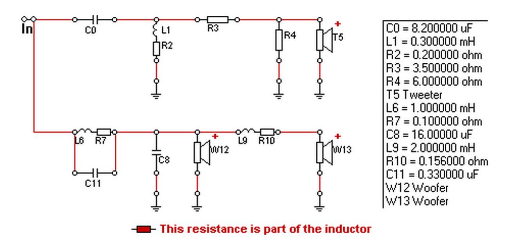

Would someone be able to guide me on how to go on about working the crossover for better impedance?
I'm sure lots of us can ... but I think this should be moved to the Multi-Way speaker forum to continue.

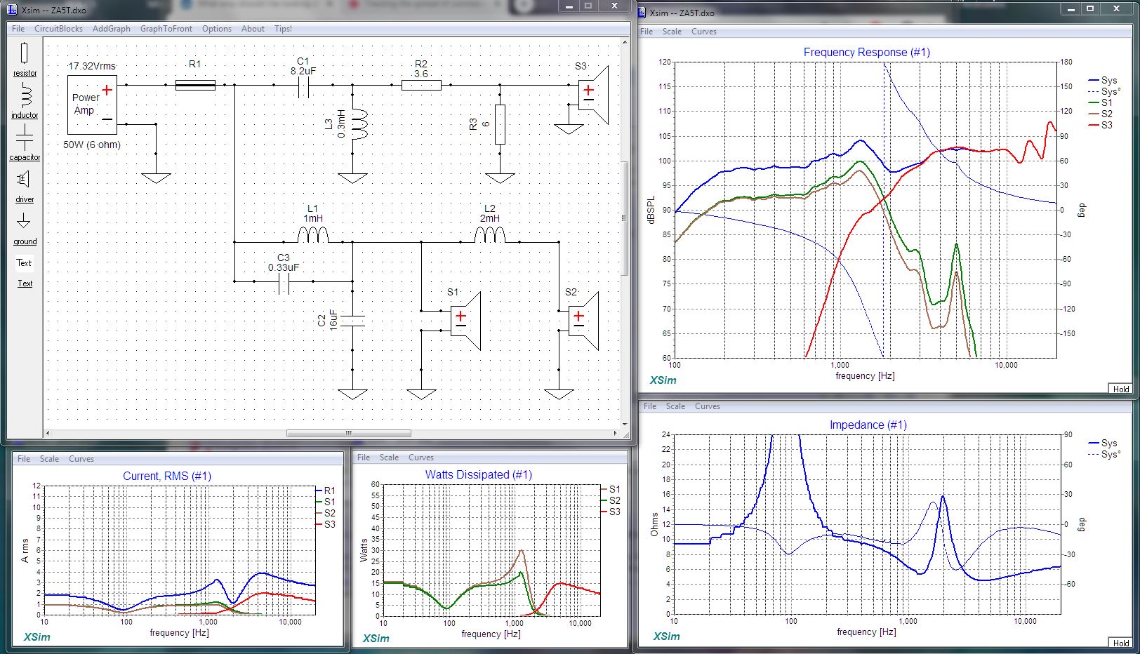

To get us started, I've copied the crossover from the link you gave me and set up an XSim file for it. The XSim file does not have the exact driver specs, so I'm hoping you can fill this in for us.
The same will need to be done for each of your satellites as well.
The 5.3T appears to be a 2.5 way design where one of the woofers is reitired early (about 150 hz) which is interesting. Typical of this design the lowest impedance is in the deep bass region rising as the second woofer fades out but it also has a pretty deep dip just above the crossover point that may warrant some attention.

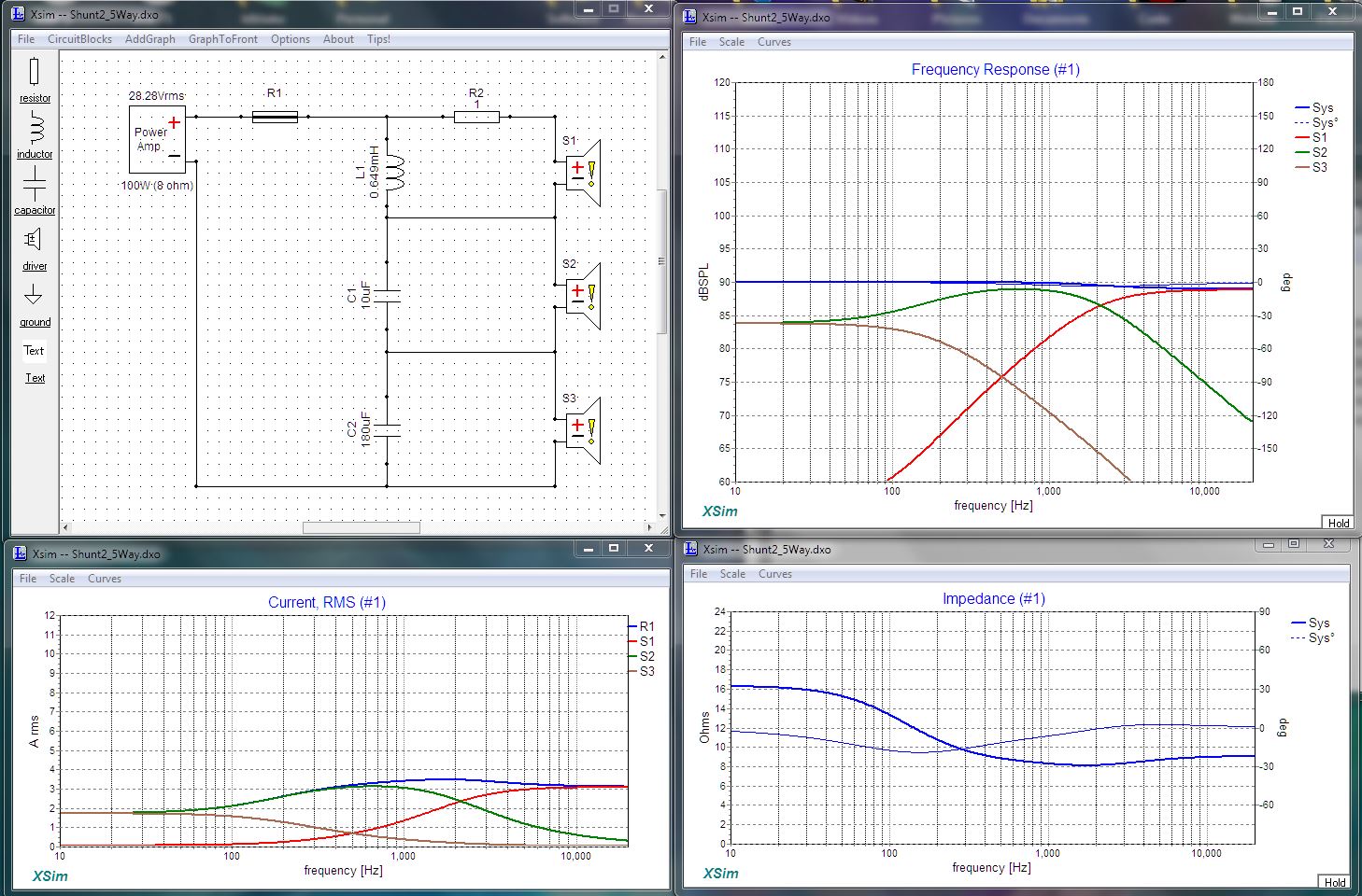

I thought you might like to see what can be done with an alternative crossover design for your 2.5 way speakers.
Please note this is not a final design as I still can't locate the files for your specific drivers. This is an example using 3 8ohm "perfect" drivers that are the default in XSim ... please note the impedance curve never dips below 8 ohms.

I hope you got it right too ... The thumbnails and DXO are for the "stock" crossover with your files. Nothing is changed.
