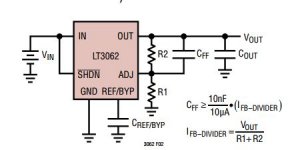

Gentlemen, I have started a group buy for ROENDER's (Mihai's) FC-100 amplifier a couple of days ago and am in need of a stable, low-noise PSU to drive the frontend
of the FC-100, giving approx. +/-37 VDC.
I can of course use the shunt-regulator that Mihai originally designed for the FC-100, but I am wondering, if a shunt is still "up-to-date".
I came across Linear's LT3062, built a prototype (image 1) and did the layout for the "final" PCB (image 2).
The prototype can be adjusted to +/-37VDC flawlessly.
My question: does anyone of you have any experience with the LT3062?
I myself am not able to "measure its performance" (for example: Low Noise: 30μV RMS).
How does it compare to a shunt-regulator?
Best regards - Rudi_Ratlos
P.S.: The 39V Zener is only needed, if somebody's transformer exceeds the allowable specification.

Yes you should measure it*, AC analysis wont give real results for sub optimal designs and layouts. BTW shouldnt you have had a design review before the 2nd PCB is built and tested? (I can see a few issues even without a schematic posted.) BTW nothing wrong with shunt regulators per se in the right apps. E.g. low current, and stable input DC.
*beg, borrow an analog scope with a LN pre-amp should give some usable results.
Rudi reconsider using ground planes. This is infact counter productive for isolating power stages esp. AC-DC rectification to LN regulators.
band gap noise is multiplied up by the ratio to the output, so old fashioned shunts can often beat series regulators for lowest noise.
reading the data sheet the 30uV is spec'd only for Vo = 0.6V ( gain of 1)I myself am not able to "measure its performance" (for example: Low Noise: 30μV RMS).
your noise will be ~ 30uV (Vo/Vref) ~ 2mV RMS it wouldn't surprise me if you can measure 10 mV p-p at 37V DC.
or about 2 divisions at x1 on a good scope using a peak hold function.
with all the lt the new lt regs improving transient response
for output voltages greater than 0.6V By adding Cadj cap - CREF/BYP = 10nF
( I usually use c0g/np0 caps for Cadj )
dazz thanks for mentioning Cff , is not only for transient response.
Cff also bypasses the adj pins bandgap noise. Please note the multiplied low frequency noise will not be attenuated until Cff dominates R2. By inspection the Lf corner frequency -3dB can be determined when X(cff) = R2 , Cout >> Cff.

Gentlemen, I have changed the Dual LT3062 PSU - layout (image 1) to:
- accommodate a "bigger" input-buffer-cap (grid: 7.5 x 16)
- decouple the buffer-cap's GND-track from the "Signal-GND-track"
- include a fix SMD adjustment-resistor, the value of which can be temporarily determined by use of the pot
Moreover I have measured the "hum" on the prototype's LT3062 output by means of my old scope.
The output of the LT3062 is loaded by a 1K resistor, resulting in an output current of 37mA.
The "hum" is smaller than one division on the scope, which is 5mV.
I myself think that this dual LT3062 based PSU will do a good job as an amplifier's frontend PSU and will offer it in my FC-100 group-buy.
Thank you, INFINIA and DAZZZ, for your suggestions.

Determine frequencies on random noise. It may be just a ground loop 50Hz or residual 100Hz rectified component and possibly some nearby SMPS HF spikey stuff. Use the 'line trigger' setting to see if truly random. E.g. is hum (line related) or hiss (random noise)?
notes on layout
1) reroute minus connection to 1000uF terminal ( disconnect short trace coming from the rectifier side) This makes a difference E.g. avoid noisy grounds ) ideally it then goes to 1 uF cap which then defines the ground heaven point or ground plane if any.
2 ) route feedback sense lines from gain setting resistors to the output connector or 100 uF cap..
notes on layout
The best cap From my experience )in/output) is
Vishay Solid Tantalum Chip Capacitors, TANTAMOUNT™,
LT often specifies tantalum on their data sheets, BUT lots of folks have had really bad experiences with them from the seventies and early eighties.🙁
I find modern Al electrolytics picked wisely with smart layouts can often beat "better" parts.
sense lines to output > less important for low current supplies, but a good habit nonetheless.
