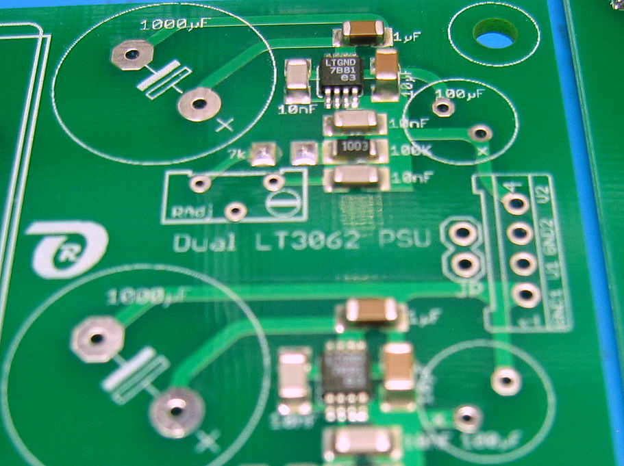

11 of the 12 PCBs are now spoken for.
Let's see how my testing goes next week. If there is more interest I can always order more boards.
My BOM (only the first 6 lines are SMD/included/populated):

Ammel,
I am currently checking, if a 2x12VAC print transformer will do the job.
Well Rudi, what's the verdict? Will a 2x12VAC do the job, or not?
I don't see any reason why that voltage transformer will not work since there will be roughly 16.8VDC after rectification going to the LT3062 regulators.
That should be more than enough voltage for these LDO regulators and even enough for the LM317/337 regulators.
Thanks Rudi!
Ammel, I have received and installed the ordered EI38-12VAC transformer, manufactured by HAHN, having 2 secondary 12VAC windings @ 2.25VA each, today and have measured.
Both +/-12VDC and +/-15VDC can be easily adjusted with this transformer.
The proposed 50K potentiometer for adjustment showed a value of about 4.05KOhm, after I have unsoldered it.
Maybe it would be wise to use a 10KOhm potentiometer (instead of the 50KOhm), if you want to adjust the LT3062 to "low" voltages and like it "smooth".
Best regards - Rudi_Ratlos

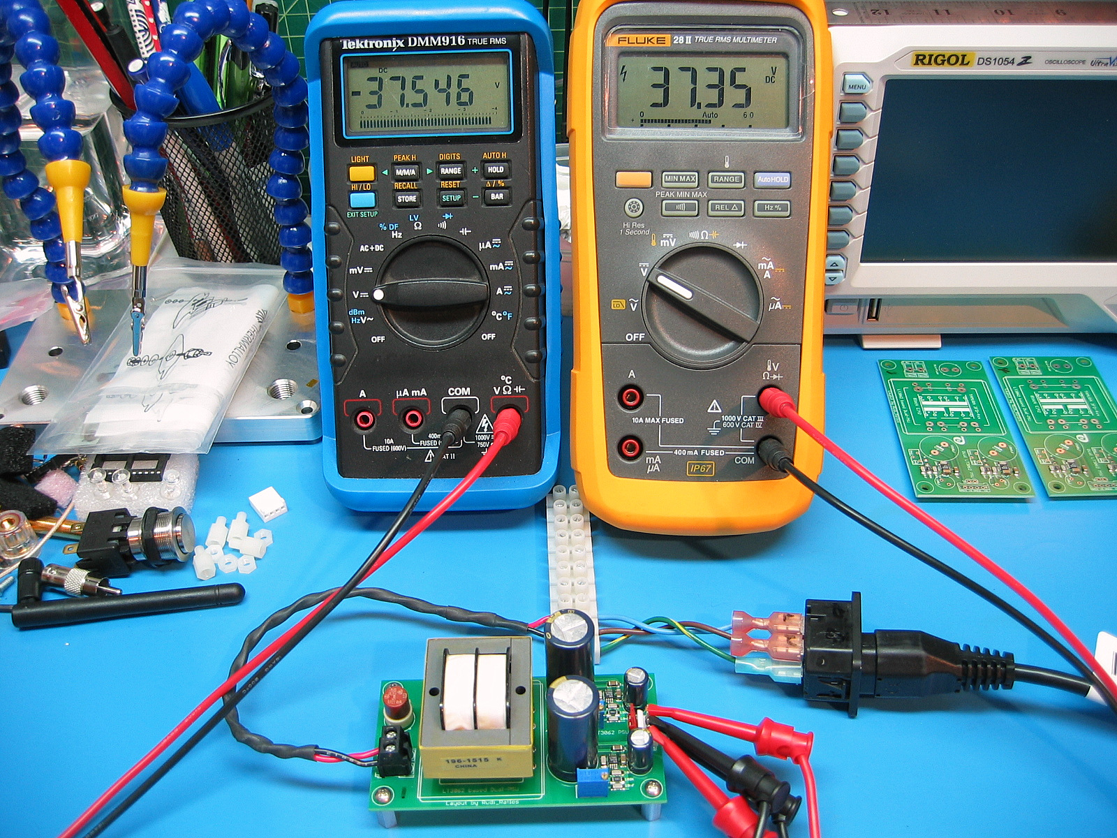

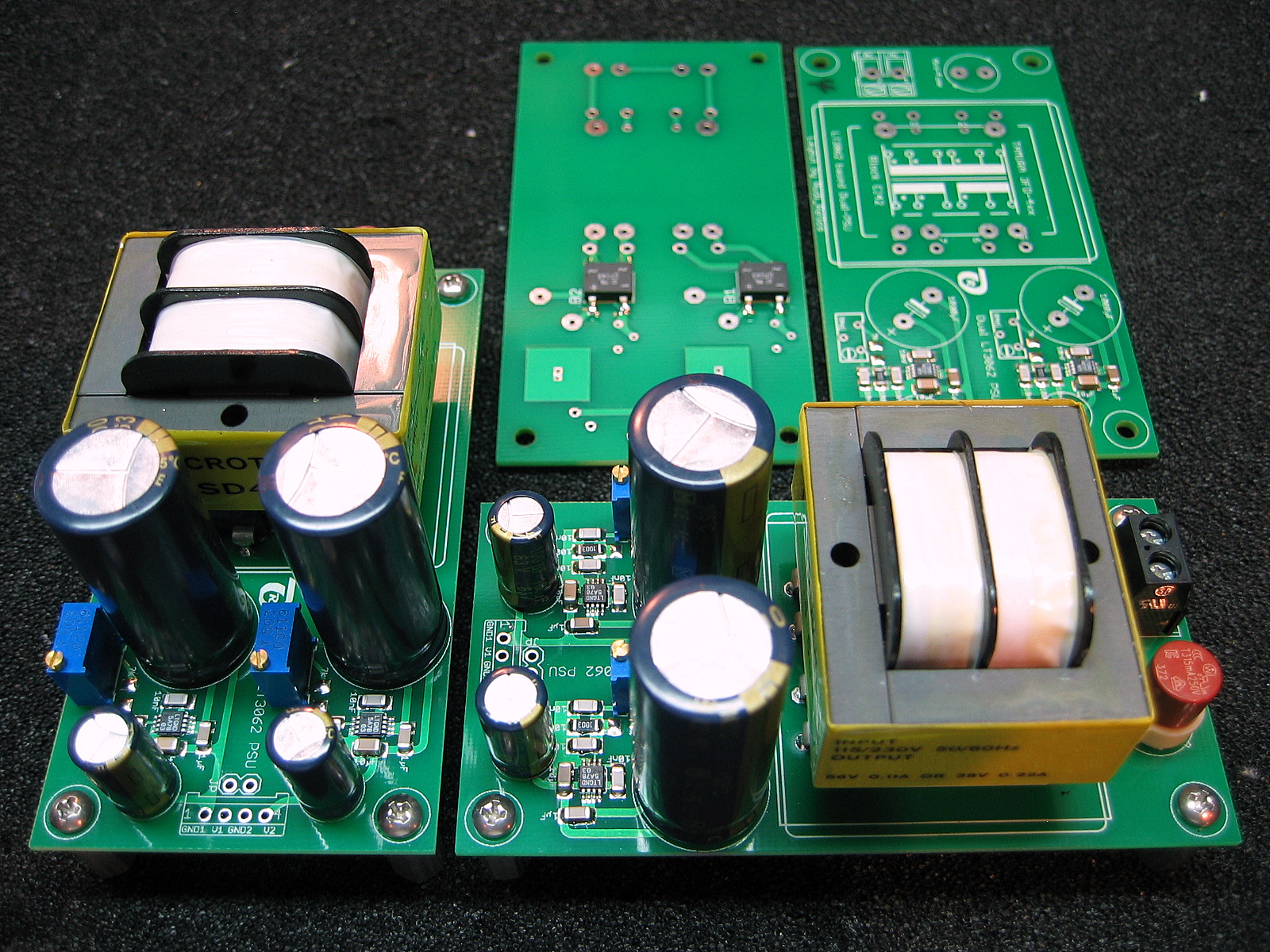

Built up two boards and everything checks out, so I consider this batch proved.
I have them adjusted for 37V, but could easily get to ~40V. The Tamura transformer is putting out 33VAC on the secondaries (unloaded) with my 115VAC paralleled primaries.
The other two boards shown are what I can provide to folks - smd parts installed by stencil/reflow. These particular boards are for Rudi.

Nice work BK.

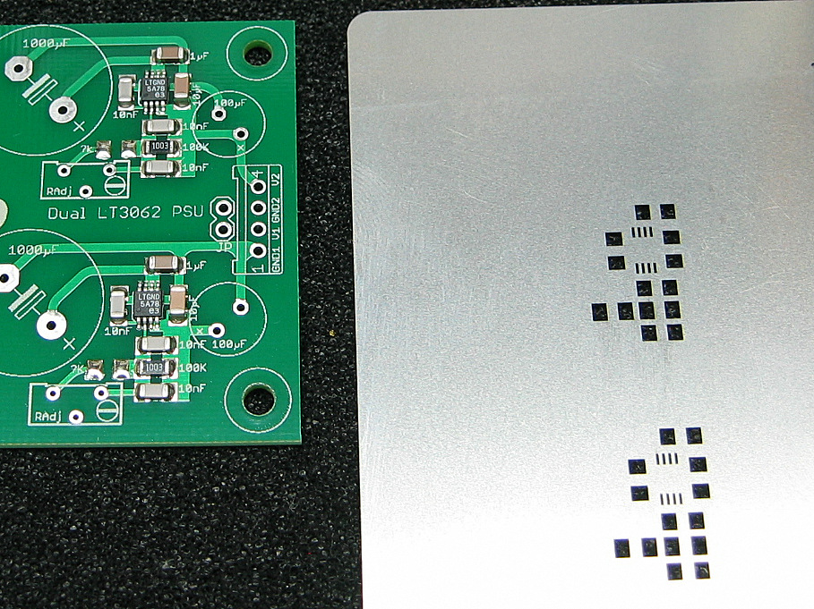

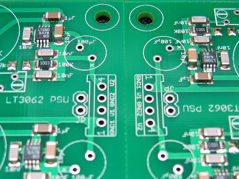

I'm still NOT clear on how to use a single board as +/-(dual) supply.
I see clearly see GND1, V1, GND2, V2 on the output pads.
Is V1 the positive voltage or negative voltage?
Do you connect the GND1 and GND2 together for the ground?
Ammel: you can customize the PCB to provide two independent output voltages:VoltageV1 with GND1 and VoltageV2 with GND2.
This is one way to do it.
If you put a jumper cap on jumper JP, the jumper cap connects V1 and GND2. This connection can be considered as "common GND".
In this case V2 is a positive voltage, whereas GND1 is negative when compared to the "common GND".
You then have a "dual LT3062 +/- PSU".
Configuring the PCB as a "dual +/- PSU" works, as long as you are using a transformer with 2 independent secondaries.
Has my explanation been clear enough?

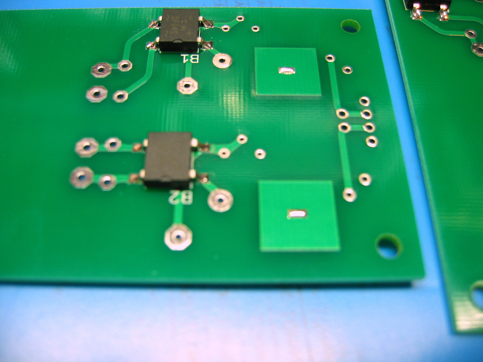

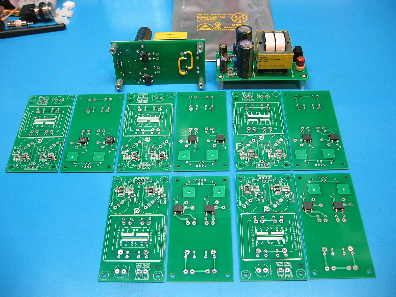

All boards are reflowed, cleaned and ready to go. Will try to get them out soon.
Underside of the LT3062 is soldered to the PCB/ground plane.
On my fully built PS, I did some under-board connections to parallel the inputs for my 115V mains + Tamura (yellow wiring).

I spent some time yesterday load testing my own fully built boards at +/- 37V with a 1k ohm passive load on each side (aka, 37mA/side) and didn't uncover any issues. LT3062 heats up to just a few degrees over ambient via thermocouple measurements and with my new 400MHz 10-bit R&S scope I'm seeing 370uV Vp-p noise, which I believe is pretty much in the noise floor of the particular setup. I have to add a disclaimer that PS testing is an art and I am NO EXPERT by any stretch, so I'm not making any claims here - just verifying basic function and robustness. Lower Vout should measure even better. I think everyone will be happy with this very flexible little unit. Thanks to Rudi for the layout!

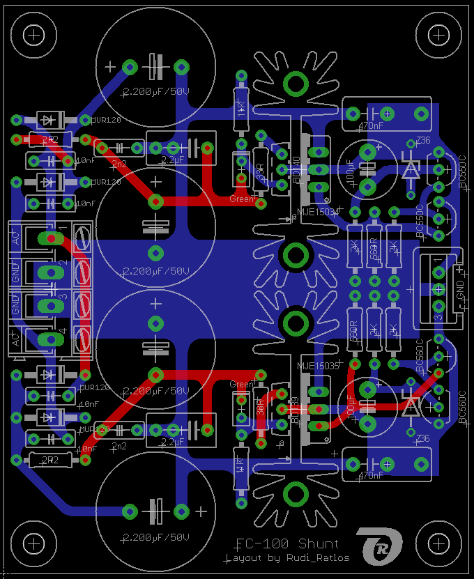

Florin, you can at least start with the SYMASYMs backend PSU to drive the frontend!
I have taken a look at my "stock".
I offer you Mihais FC-100 shunt-regulator that will fit perfectly for 2 SYMASYM frontends for 1€ + shipping.
Tell me, if you like to have the PCB.
Best regards - Rudi
