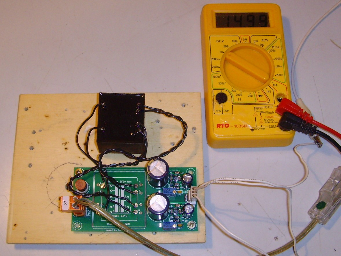

Rudi, will I be able to adjust the output voltages down to +/-12VDC with the 50k trimmers using a 12V dual secondary transformer?
Also, what value and type of cap is needed for JP1 for bipolar operation?

You will be able to adjust to +/-12VDC by means of a transformer with two 12VAC secondaries and a 50K potentiometer.
Best regards - Rudi_Ratlos

Ammel, I came across the LDO regulators from LINEAR, when I was looking for a "clean" PSU for Calvin's phono pre that needs a +/-18 VDC PSU.
A "simple" LM317 / LM337 PSU didn't do it: it generated too much hum.
A LM3x7 tracking pre-regulator "behaved better", but I finally chose a LDO regulator from LINEAR.
Be aware that it can handle a maximum of 200mA of output current.
You will of course be able to adjust the LT3062 PSU to +/- 12VDC.
The image attached shows the PSU being adjusted for +/-15VDC to operate a MUSES volume attenuation IC.
I am currently checking, if a 2x12VAC print transformer will do the job.
Best regards - Rudi

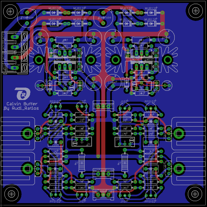

I have improved my LM317/LM337 PSU by a tracking pre-regulator (see attached image - regulator is on top) and have read the substantial articles.
After all my choice is either the LT3062 or the TPS7A4700.
