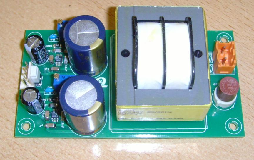

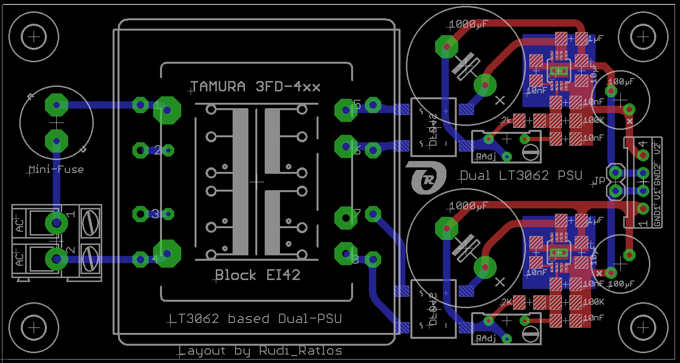

Find attached two images of my "Dual LT3062-PSU" - prototype.
It could be easily adjusted to about +/-36VDC.
I have already connected it as "frontend-PSU" to my SYMASYM - and the LT3062 does quite a good job.
Best regards - Rudi_Ratlos

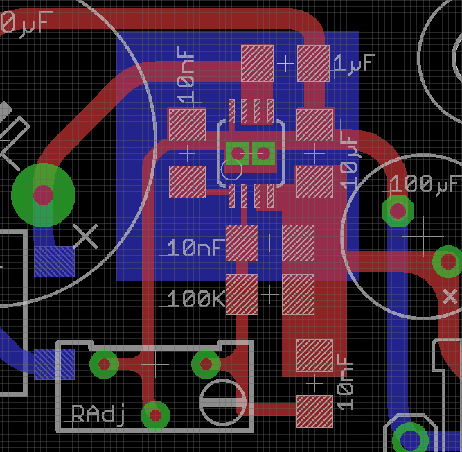

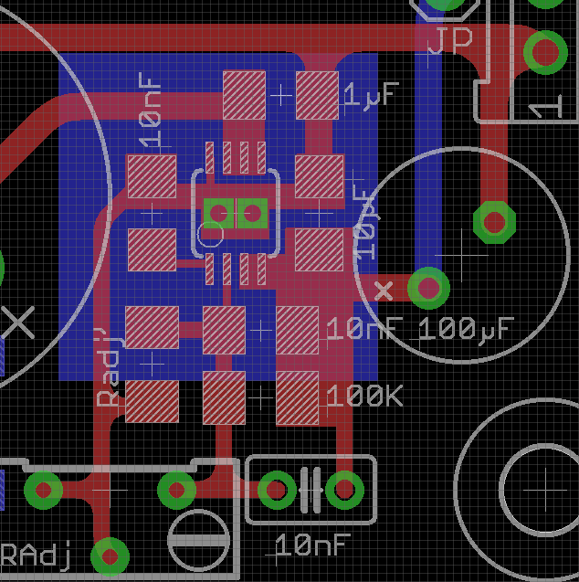

This is how I connected the LT3062' back to GND (see the image).
I have layed out a GND-plane(blue) beneath the IC, inserted 2 holes (VIAs) into it and put 2 little drops of solder tin into these holes.
The solder tin then connects to the back of the IC.
In this way the GND-plane provides some cooling.

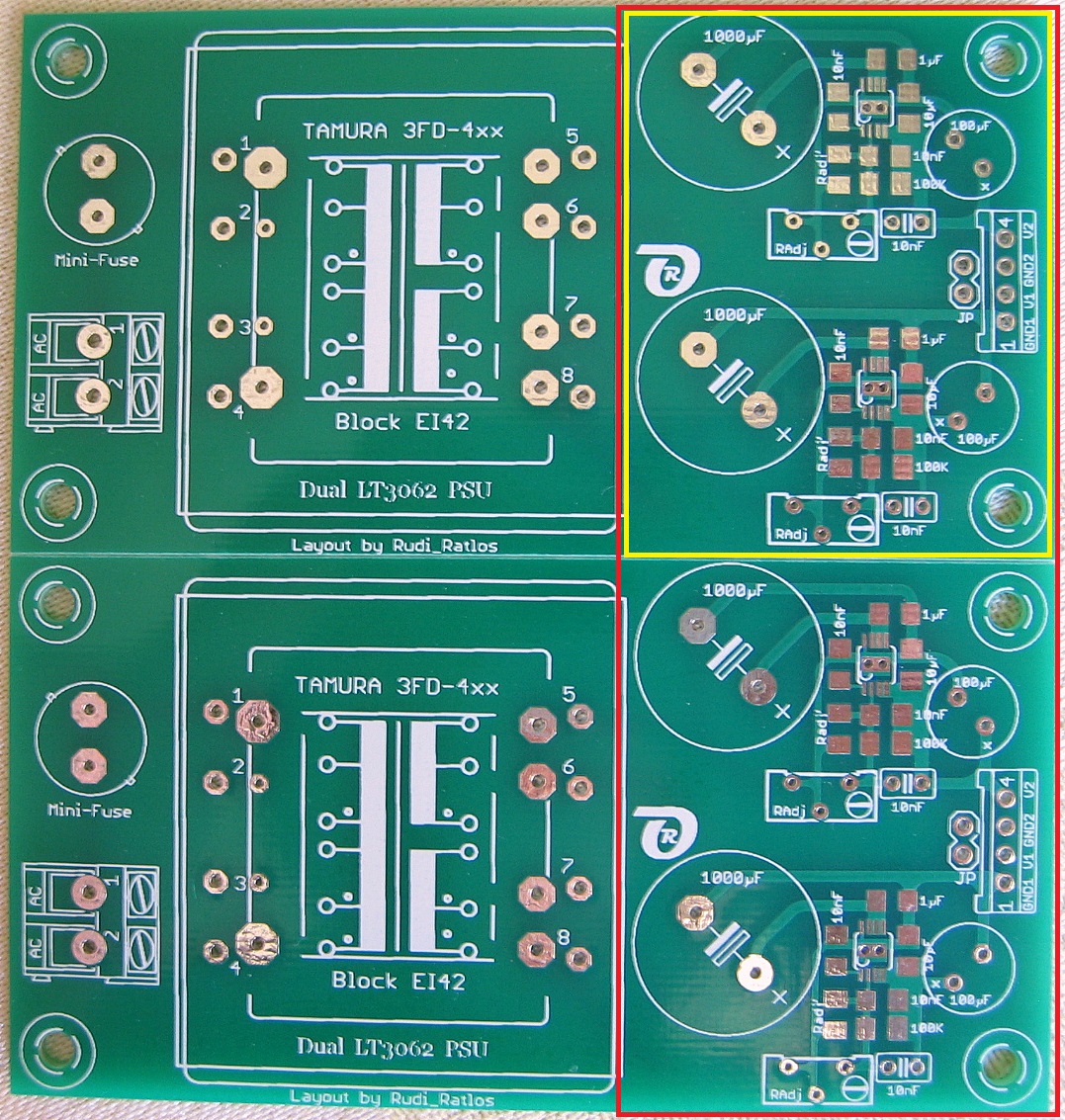

BK: compare the two attached images.
Is this, what you want?
P.S.: I do not know, which revision of the LT3062 PCB you own.
Best regards - Rudi
Rudi: see the pic below of the PCB I have (previous gift from you).

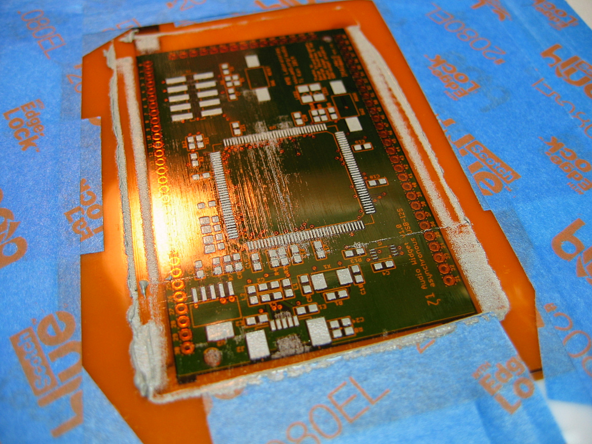

I could get a stencil for either the whole PCB, or just the parts with surface mount components to save some money. But, there needs to be enough surrounding area for me to tape down, etc. See the red and yellow boxes for examples for reflow of complete or separated PCB, respectively.
BTW, I use OSH Stencils. Also below is an example of a previous project with a polyimide stencil. I might use a stainless steel stencil for this.

Ammel, since I myself am not able to solder the tiny LT3062 in MS-8 package, I have given Bob the Gerber files of my layout and asked him to order a couple of these PCBs.
The PCB implements two independent LT3062 - PSUs, but by putting a cap across JP1 you can make it a +/- PSU: for example: a +/-37VDC PSU to drive the frontend of your FC-100
or a +/-15VDC PSU to drive a Muses chip. You need an appropriate transformer though (for example: Tamura 3FD-456; the PCB also supports EI42-case print transformers).
There is one reservoir electrolytic cap (1000µF) on the input and a smaller one (100µF) on the output of each PSU.
For the sake of convenience I am using a 50K potentiometer to adjust the output-voltage. You can as well use the SMD-resistor labelled "?K", if you do not like the potentiometer.
If you ever need a PSU with output voltage 20VDC < Vout < 40VDC and "nice" load and line regulation characteristics, I recommend this one to you.
