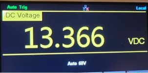

The C3M0065090D did not disappoint. Lowest THD as expected
The Candidate:
Gate Voltage - 6.2V
Drain Voltage - 13.366V (adjusted for lowest THD, not symmetrical clipping)
THD @ 1W into 8ohms - 0.0986%
I am worried about the profile of the distortion for all the Cree devices as they show less H2 and more H3. FFT testing will be helpful here (next) as well as proper listening tests.
