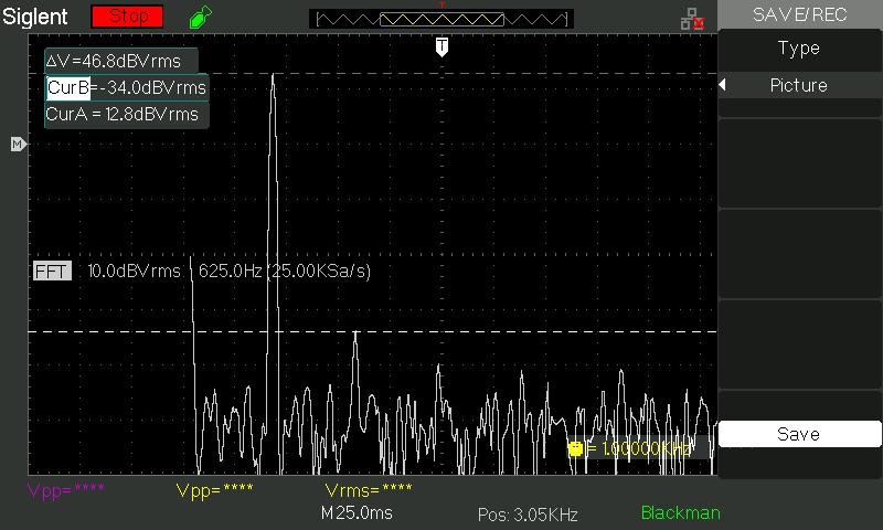

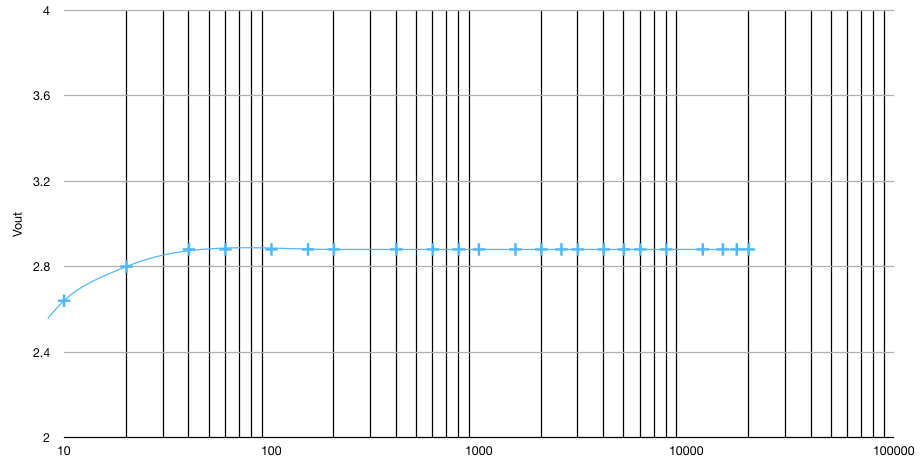

I tried to take both measurements tonight. I am using the built in sound card on my computer and the generator in REW to create the signal. I am running an 8 ohm dummy load and measuring at the input to the amp.
To get an idea of the frequency response I varied the input frequency to the amp and measured the voltage of the output - I did not see any variation in the output voltage of the amp from 20 Hz to 20,000 Hz, but it did drop off a little at 10Hz. A pretty crude test, but the results seem ok.
I am having some trouble obtaining the FFT measurement, probably due to my inexperience. The questionable measurements I have now show that I need to have a 5 Vrms output on the amplifier to get a second harmonic peak make it above what I think is a -50dBV noise floor. I'll try again tomorrow.
The images below show what i am measuring for frequency response and the best I can do for the FFT.
The frequency response starts to drop off below 20 Hz, but is flat from there up to 20,000 the highest frequency measured.
The FFT shows a ~47dB difference between the fundamental and the second harmonic. These measurements were taken at 1000Hz and 5.2 Vrms or about 3.4W output. If I am getting the math right, this is about .45% distortion. The First Watt distortion chart for the F2J shows about .6% THD at this power level. So allowing for an increase due to higher order distortion, I think my amp measuring .45% seems like it is in the ball park.
Any recommendations of what to try next? I was considering trying a different C3, maybe making a 12,000 uF bank of Nichicon KZ or Silmic II? Anyone know what type of capacitor was used in the real F2J?
Is it possible that this amp/speaker combo just is not a good pairing?

any other amp as comparison , trying other source ?
I just biased up my BA-3 last week and it sounds great! Not as much bass with the Vulcans as the F2J, but much clearer. It also sounds great with some 4 ohm Vifa/Scanspeak 3 way towers I built years ago, the bass is so clear and precise that it makes me think I never had an amp that could handle the low impedance 10" woofers before.
Eventually I will build the DCG3 preamp that I have parts for, maybe that will help with the 10K input impedance of the F2J. Although I though the B1 would have helped with this too...
Do you think there would be any value in changing the output electrolytics, or is this just a waste of time and money?
Thanks for the input Zen Mod, as always you are very helpful.
changing caps can only bring it closer to your taste, but can't cure-it-all
find a reason why you're not satisfied - it's either source side or speaker side
for starters - try feeding it with anything which has headphones output with volume
I remember having some amps in Yore, and I was happiest (then) feeding them ditto from crappy Technics CD headphones out
that will tell some ......

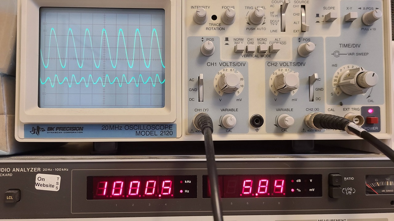

Long story short - it works and I have a Cree F2J with C3M0160120D alive for at least 3 hours of running and it hasn't melted into nuclear waste pile yet. Cree actually has SOA data for these but I did like a good greedy boy and read the NASA paper so understand that this means nothing for a device meant for to be used for switching ... but weren't the Tokin parts meant for switching too? 😉

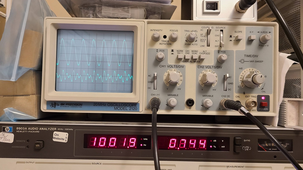

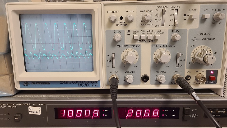

Anyway, the experiment is a success if the intention was to build an F2 with much lower distortion. With IRF and about 16V (p-p), I was seeing about 5.8% distortion and now with the Cree (higher input voltage due to lower gain) but still at 16V (p-p), the distortion is down below 1% at 0.744%.
It sounds nice but it's still on parole - it's not allowed to play on the Frugalhorns until I have 2 channels built. For now I'll continue testing this to make sure it doesn't create a black hole.
F2 (R6 100K - IRFP240) THD 5.8%
attachment.php
F2J (R6 20K - Cree C3M0160120D) THD 0.74%
attachment.php
In both pictures, the bottom trace is the residual. It looks like F2 was 2nd harmonic negative phase and F2CJ (Cree-J) has mix of 2nd and 3rd.

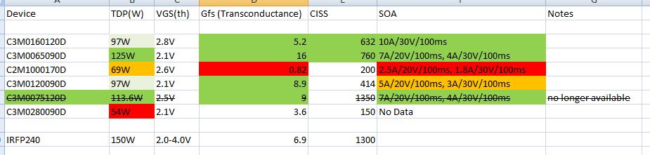

Summary of Cree data for the devices I have:
attachment.php

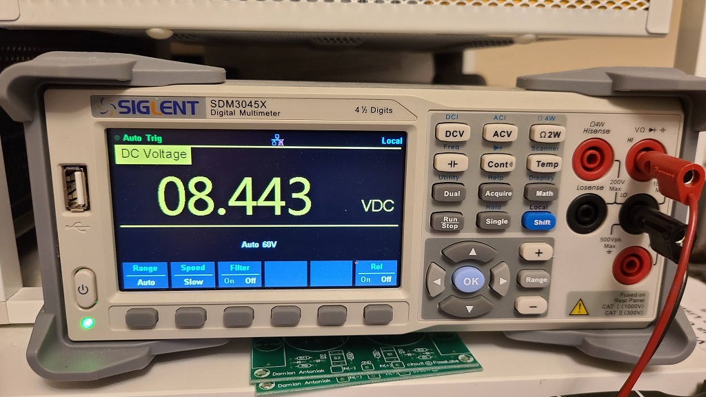

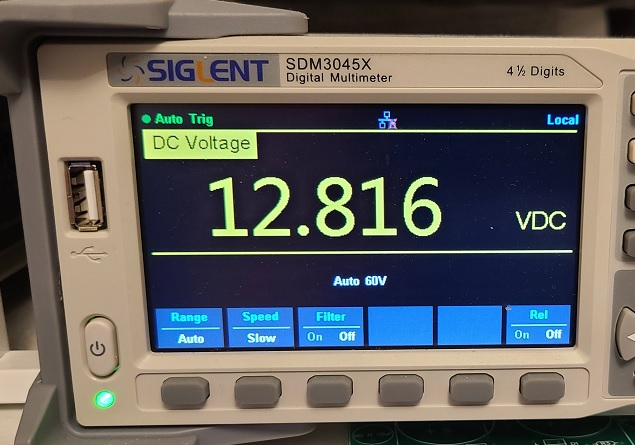

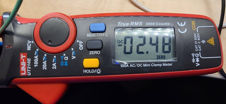

Had some time to set it back up to take more measurements. Have not changed any values but have not adjusted for symmetrical clipping yet. The low gain means I have to feed it with more than 4V on the input to drive it into clipping and I'm afraid to do that. On test speaker it plays plenty loud so I think I am going to keep it like this but Dennis is asking me problematic questions so I have to dismantle it a few more times 😉
So gate voltage (still moving as it warms up - it drops so negative tempco?) was around 8.5V and Iq on ZM recommended clamp meter was 2.55A and stable as it warmed up.
More pictures, less words
Life savers - must have for lazy greedy boyz

Gate voltage at temp - 8.44V
attachment.php
Drain voltage at temp - adjusted for minimum THD, not checked for symmetrical clipping but looks pretty close to 1/2 rail - 12.81V
attachment.php

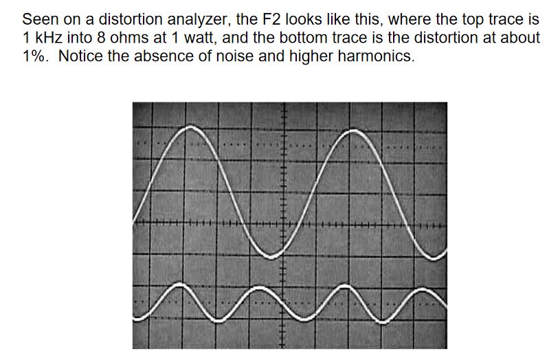

What Papa said about F2 - about 1% @1W into 8 ohms
attachment.php
In F2J article, Papa says new device has about 1/3 of the THD of F2 and in this thread or somewhere, Papa says SS/F2J has about 1/5 of THD of F2. So the target is anywhere from 0.2-0.3% THD @1W into 8 ohms
We have a winner! - 1/5th THD or 0.2% @1W into 8ohm
attachment.php
For whatever reason, I don't get a trace when I connect + to OUT+ (GND) and - to OUT-(C3/output) so my connections are actually reversed ... this means positive phase 2nd(ish) becomes negative phase 2nd(ish). Papa is a genius! 😀
