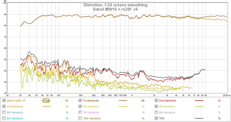

Those are excellent distortion figures, -45dB to -50dB is about as good as these drivers get. What this means is that the EVA foam is not vibrating and contributing too much to the HD. I think you mentioned you are using rubber cement as the glue between sheets of EVA. That may be key as it is viscous when dry and performs a constrained layer damping (CLD) between the layers.
I have to think about what is causing the ringing. Take a cursor and get the exact time between the ring peaks and back out the frequency. Look at freq response plot to see if that is a diffraction or resonance, or electrical DSP induced.
It looks like you might be able to use a tad -2 or -3dB of baffle step compensation to balance out the bass and highs. Looks very good though. Nice work.

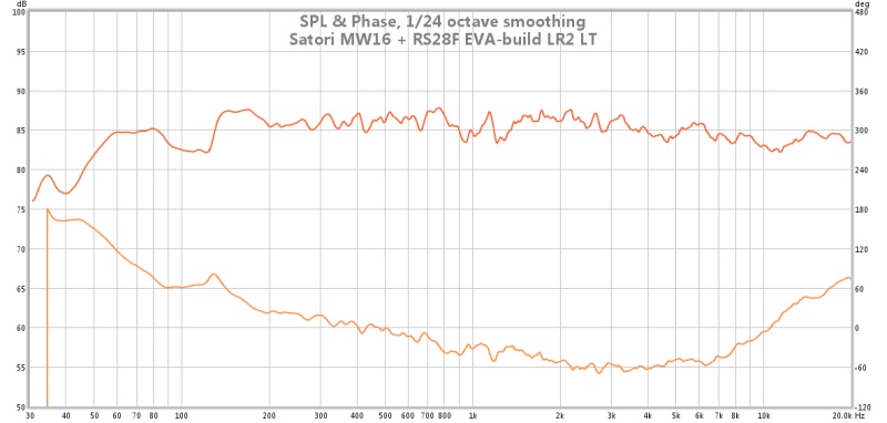

Seems you thought that LR2 supposed to have flat phase and explain you haven't cared what you sum plot presented. In IRR domain seems all filters for a two way speaker higher than 1.order (BW1 phase linear when summed on axis) when summed and on axis adds distortion to phase by turning it when compare (before XO) I/O (acoustic sum) signal. xrk971 suggestion to try harsch XO type is good compromise to have a close to linear phase in XO region from IIR filters, else it seems we need FIR filters also to help get pure perfect flat phase (miniSharck can do FIR too). For info i used RePhase convolution FIR filter to correct the 360º phase turn in reality a LR4 IIR XO filter distort my phase posted at comparison thread round 2 where we talked 10F/8424 http://www.diyaudio.com/forums/full...3in-5in-drivers-round-2-a-46.html#post4397112.
Your published measurement is okay you just need to push a buttom in REW to have correct phase plot for the summed plot, FR won't react to pushing that buttom only phase will, and by this i mean don't go back to a previous alignment that showed a look more as it was supposed to because it's only a small time alignment in IR placement on time domain that makes fault. When REW do a measurement it aligns IR peak to timing point zero by itself and no problem when measuring single driver that only have one peak but a problem for LR2 that present it to a IR that go both positive and negative way and sometimes it align to the wrong one. Therefor with "Impulse" plot view window for that old measurement sum of speaker hit "Controls" icon at right side in REW and then "Estimate IR Delay", this should move your IR on time line so negative going peak align instead of positive peak, and now go back to phase plot and it show the correct absolut phase for your system and if this is true and want saved remember to save mdat once again 🙂. Learned this myself from others here at diya and another good advise is always after a measurement take the first plot look at "Impulse" window because if it show weird figures then forget this measurement and make a new one, some temporary acoustic or electric noice probably had messed with session. Below you see orange is correct timeline aligned having negative going peak correct and at green REW had set positive going peak aligned, in next picture with phase this makes quite a change and now as a LR2 in reality turn phase 180º around XO frq point the 90º turn is correctly reflected at 2300Hz. Would love to see your plot again if you try above : )
These are great tips Byrtt. If one has only a positive main peak (since drivers are all in phase) does one still need to click "Estimate IR delay" prior to viewing phase?
Take answer with gran of salt but my logic says yes so the math for phase based on IR gets 100% true reflecting absolute phase. If DUT performance quality is high and environment plus gear is good think peak is so sharp that REW get it 100% aligned on the fly most times, that i notice often and then if hiting "Estimate IR Delay" one only gets the pop up message "Estimated delay is zero". Use IR alignment for summed system measurements, but for single driver measurement midranges and woofers and especially if XO filter is at place too for midranges and woofers then never use that bottom because peak is often so wide and soft that it goes wrong for REW that then align to sharpest point actual the rising start of peak instead of soft top, if alignment needed for those soft peaks do it manual toggle the arrows in the tool under "Controls".

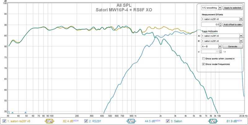

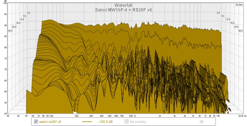

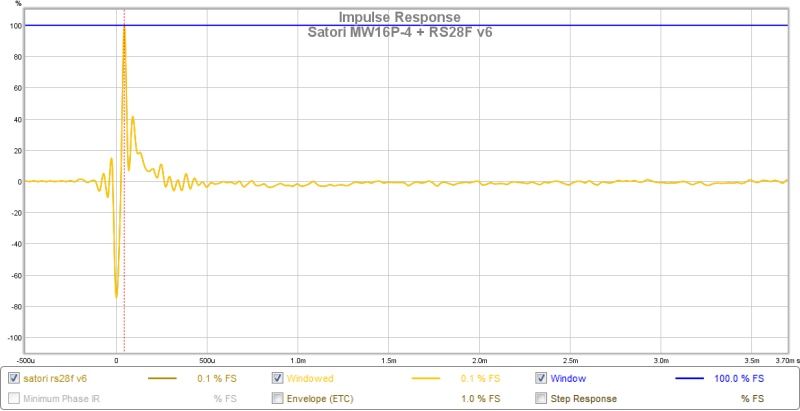

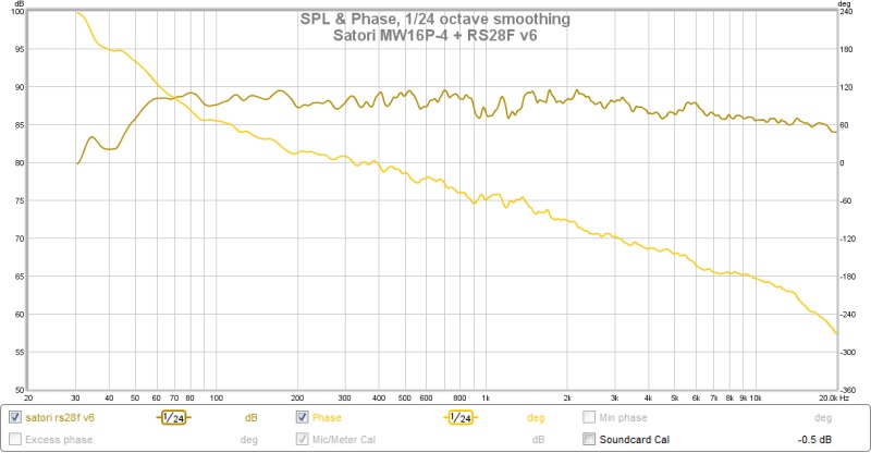

Made some adjustments to the XO and eq. I think this looks and sounds much better. Still an LR2 alignment around ~2000
frequency response and phase look flatter now.
Distortion is a little better too, especially in the midrange and around the crossover point
here is the new crossover. again the waveguide makes the actual DSP XO filter and the final acoustic crossover point different.
IR and CSD look about the same, but are still good
Here are the specs of the DSP (calling this v6)
rs28f high shelf 9000hz +2.5 q0.7
rs28f peak eq 11500 +3 q2
satori level -0.4db
satori peaks 1344 +6.4 q5 / 1011 -7.5 q7.9
satori peaks 142 -5.3 q3 / 121 +6.8 q2.8
satori LR2 2300hz
rs28f LR2 3000hz
LT + BW12 27hz

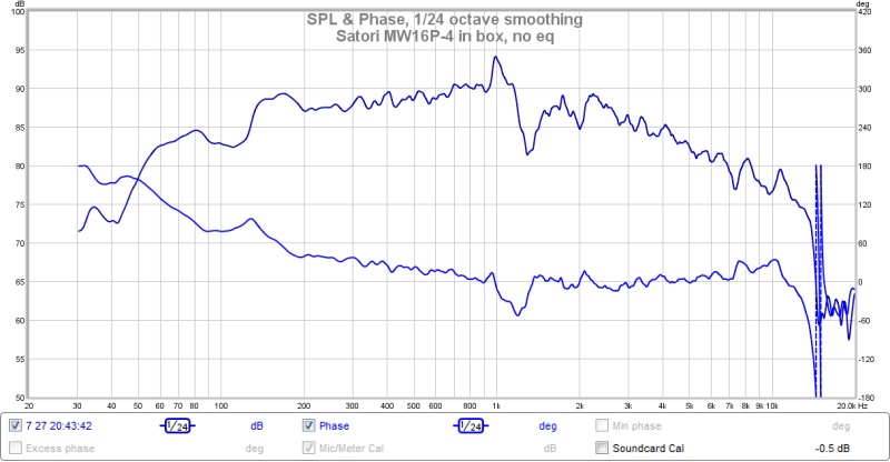

The satori has two regions of glitches. One is around 1200hz which shows up on zaphs plots and the offical FR. Mine come out a bit stronger. The other is around 130hz. Does anyone think either of these can be cleaned up with changes in the enclosure (baffle-diffraction, chamfer...)?
But with the new DSP eq and crossover the final result is very pleasing.
