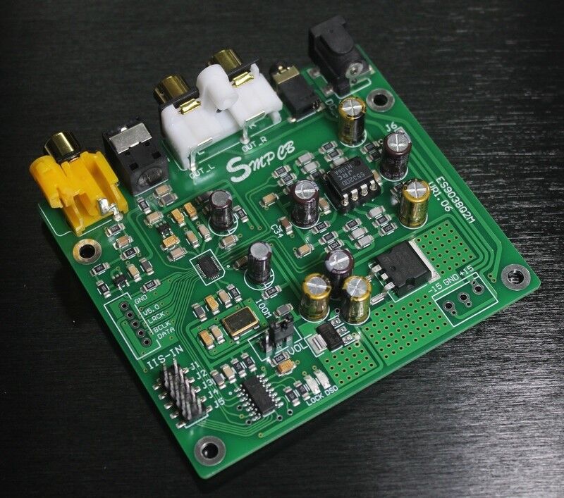

Are these canned DACs worth modding, or should one start over with one of the boards in this thread ?
None of the pics you posted look very suitable for modding, at least not to me.
If you do want to mod an ES9038Q2M board then I would suggest starting with one like we use in this thread. The reason I say that is because the particular board's layout leaves room for you to work. The more densely laid out boards don't have much extra space on them. They usually don't have a very good ground plane on the back side either, and a good ground plane is something really useful to have.
Got it.If you do want to mod an ES9038Q2M board then I would suggest starting with one like we use in this thread. .
But as I noted, this thread is a bit overwhelming, being over 631p long. So where exactly is the best post to start?
You might try going back post #2795 https://www.diyaudio.com/forums/digital-line-level/314935-es9038q2m-board-280.html#post5557498
...maybe read it and then follow the links from there.

let's simply life for once .... so, let's make this multiple choice (please select the best answer):
You asked for a post to start with and I gave you one. I hope you understand this isn't a kit project.
Of the three boards you linked to, the second one is a version of one that was known to be a cheap knock-off of the recommended one.
Second one linked to:
YJ-ES9038 Q2M I2S DSD Optical Coaxial Input Decoder USB DAC Headphone Output | eBay
The better one we prefer:
ES9038Q2M DAC Decoding Board Coaxial Fiber Audio Decoder Module DSD DOP 384KHz | eBay
That said, either one is probably useable.
Markw4 said:You asked for a post to start with and I gave you one. I hope you understand this isn't a kit project.
From a learning/educational stand point what is better or worse on the YJ knockoff?
Are the component quality/choices better or worse? [Capacitors? Regulators? Op Amp?]
Is the layout better or worse?
Is the bypassing for the supplies better or worse?
I would like to learn more about what to look for. On an AK4396 I measured yesterday I saw a significant improvement by not modifying the board but instead feeding the board +/-18V from LM317/LM337 instead of AC. The LM317/LM337 DIY kit was only $5 but perhaps it is more effective than enormous capacitors soldered onto the board?
Everything except the dac chip is cheaper on the cheaper board. The PCB quality itself is cheaper. That's how the get the cost down and still make a profit.
That said, even the better board probably sounds best with very extensive rework. Modding one all the way is big, long project. Not a one weekend thing. However, very few people decide to go all the way. They go as far as they want and are satisfied to stop there.
