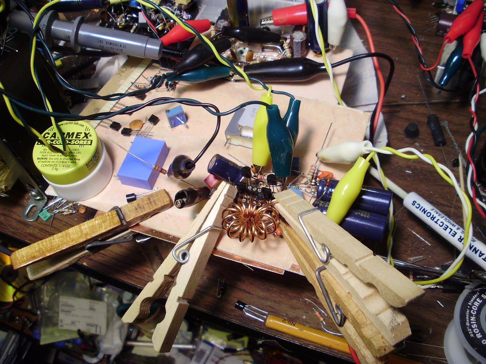

Any recommendations on what to use for the coils L1 2uH ?
I just use an air wound coil. Here is a build photo showing what I did:
I'm not sure whether it actually sounds better with a toroidal coil, but any 2u inductor will do really. I haven't experimented with many different coils.
