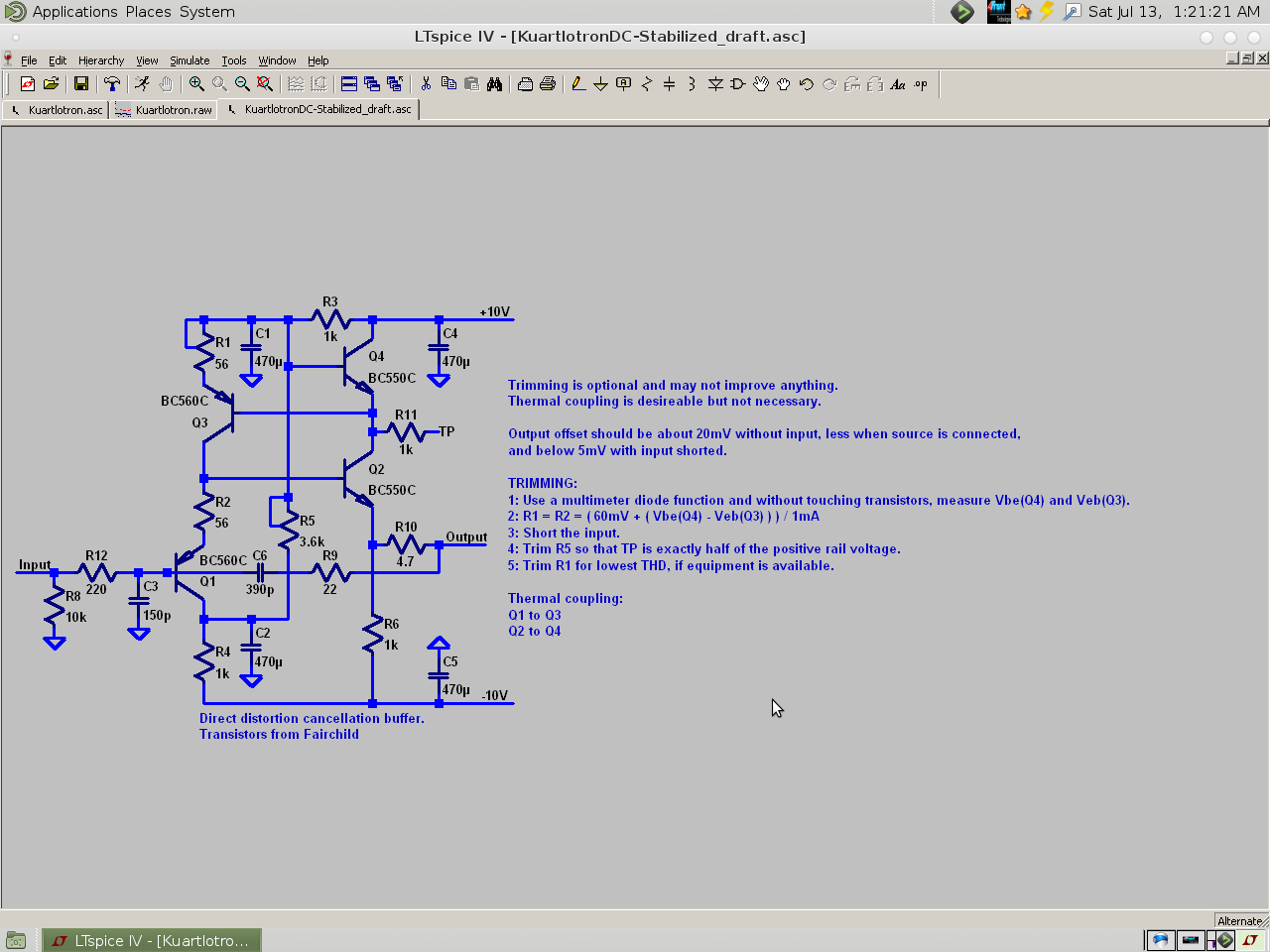

Can we have a show of hands on which type of supply you guys want? The original version was made for DC for Joachim, but I've had a few requests for a single-rail supply version. I want to stick with dual-rail because that makes capacitors optional, but I understand a single-rail option would be convenient for many.

I just simmed it with + - 17V & it looks fine.

The simulator won't show the thermal mismatch which is what the biasing arrangement is for. That's why I put the TP node at half the positive supply. If you change the supply voltage you probably want to either remove the bias circuit or adapt it to the new supply voltage (ideal solution).
Other reasons for +-10V:
1: It keeps dissipation and therefore dynamic and static thermal drift to a minimum.
2: I found going over 10V had a harsh sound that I couldn't track down, and wasn't even necessary. Perhaps after all the improvements since then it will be fine? I don't know.
The Kuartlotron doesn't draw enough current for the Kmultipliers. You would need 470R resistors from power to ground to draw about 20mA to put the KM's in a good range.
If I wanted just the extra PSRR of the Kmultipliers, I would just use BC3x7-40 C-multipliers, potentially with zeners for regulation, and possibly choose the ground references strategically depending on the ground topology of the system.

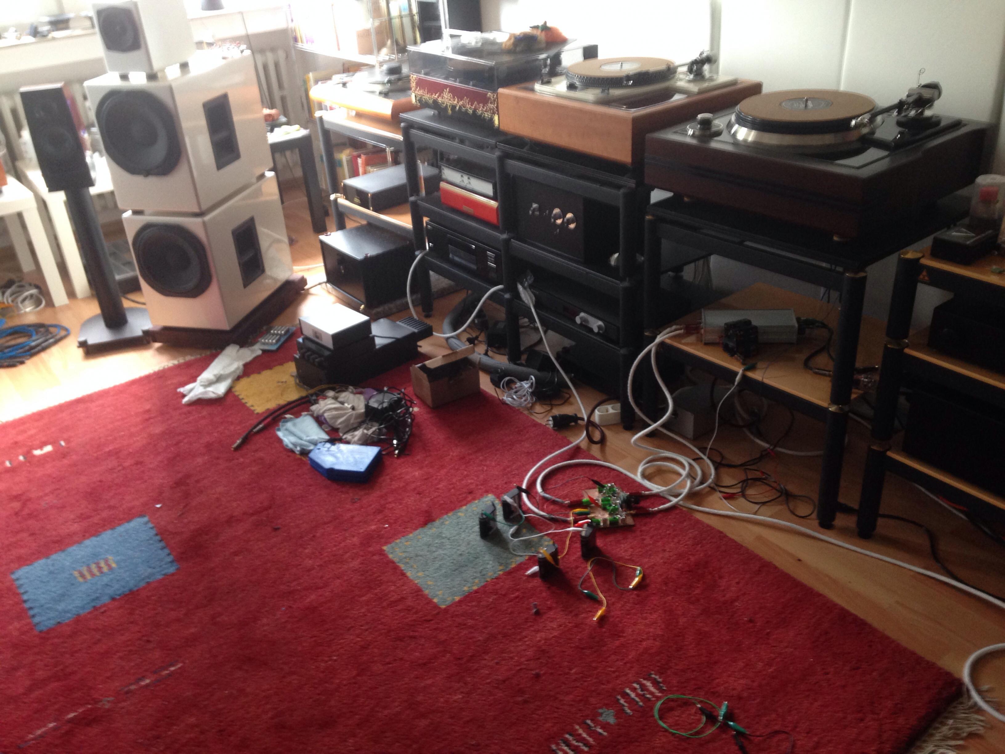

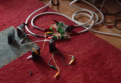

just give you a picture of my working place and a "certain " 😀😀
buffer in it
The sound has a level of undisturbed, clear information, that is only mached by the very best line stages I came accross in my "Audio Life"
the "musical correctness" in tonality, dynamics, punch, details, focus and imaging is just striking! - in my system the height matters and now, with the newer version its there and also 3D is there ( soundsources/instruments are placed before, behind, above and in between my speakers)
and when this happens a lot of things went into the right direction...
( I use a ZDL 5 way, time correct, and " almost" phase linear speaker as my main monitor and played this weekend with the Kiso speakers - which created a lot of fun - actually real "Joy")
Thanks for your work ....
and my "Amplifier" thanks you too, as it loves being provided with signals from such a wonderful source

Martina, the pictures are a bit small. Can you generate a PNG ?
Martina, you can try my floating idea.
Just cut the ground wires from the batteries that go to the copper ground plane.
REDUCE THE VOLUME BEFORE YOU DO THAT:
