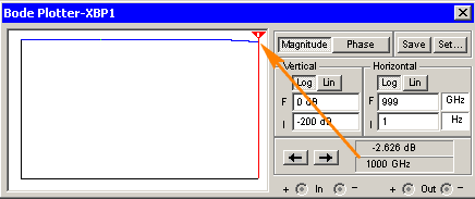

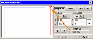

HF Booster
I tried various Caps in the following position, & the 1nf boosted the HF -3dB up to over 1GHz ! THD was still below 0.001% @ 20kHz with 1V RMS 🙂
Whether this would be stable etc in Reality ? Even if it's OTT for audio, it "might" be a useful technique for video ? 😉

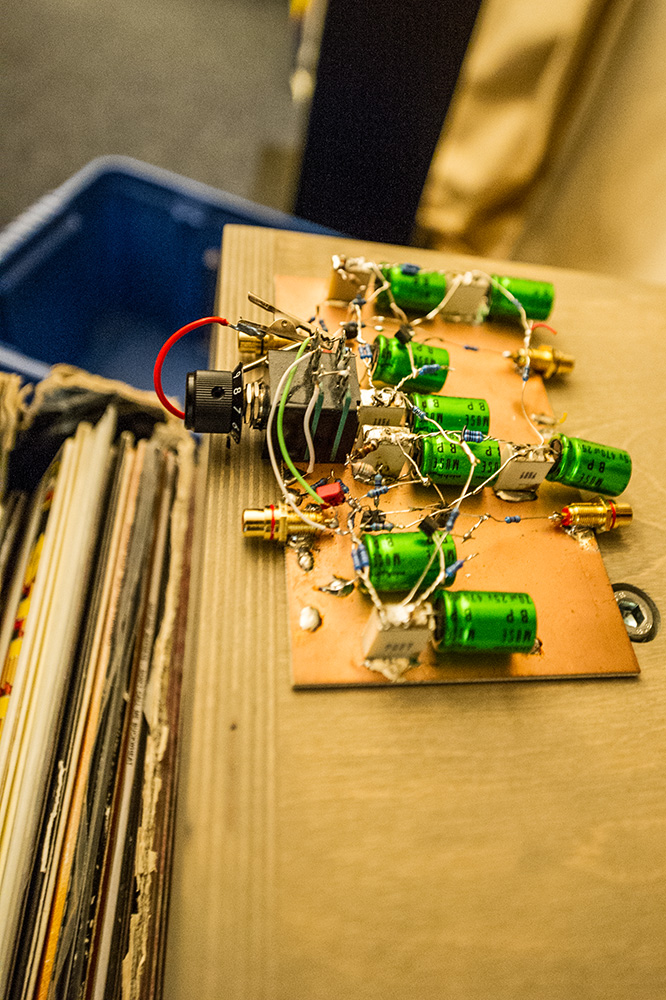

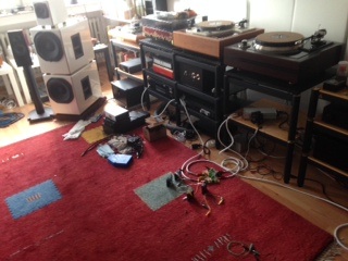

hi MartinaView attachment 400501Hallo Joachim, hallo Keantoken
just give you a picture of my working place and a "certain " 😀😀
buffer in it
The sound has a level of undisturbed, clear information, that is only mached by the very best line stages I came accross in my "Audio Life"
the "musical correctness" in tonality, dynamics, punch, details, focus and imaging is just striking! - in my system the height matters and now, with the newer version its there and also 3D is there ( soundsources/instruments are placed before, behind, above and in between my speakers)
and when this happens a lot of things went into the right direction...
( I use a ZDL 5 way, time correct, and " almost" phase linear speaker as my main monitor and played this weekend with the Kiso speakers - which created a lot of fun - actually real "Joy")
Thanks for your work ....
and my "Amplifier" thanks you too, as it loves being provided with signals from such a wonderful source
Martina

That works great with low source impedance, and a source that's willing to drive the entire buffer at 1GHz. But it causes negative input resistance which turns your input cable into an RF transmitter, or at the least cancels the loss of the preceeding wiring and boosts RFI reception.
