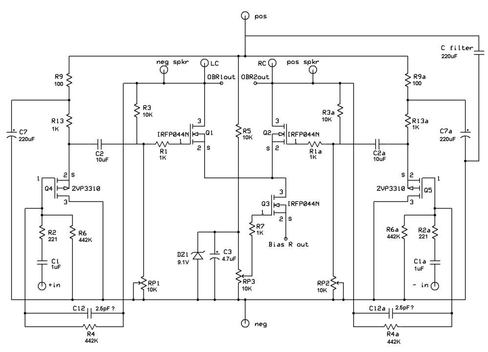

I couldn't wait until tomorrow...
So, just now, I utilized babowana's idea--it works like a charm.
I used a couple of nice 1 uF film caps on the input. Then I added 442k resistance to ground at the buffer gates (R4 was already 442K). I reduced R2 to 221 ohms. I also reduced R13 to 1K.
The buffer source voltage is now 15.7 volts. This is almost midway between ground and positive supply.
The results are wonderful. That missing body of midrange sound is back. The micro-detail is slightly less, but still present. It's probably harder to pick out because the mids are stronger.
I'll rewrite the schematic and post it at a later date.
John🙂

Now we could have good advantages, IMHO.
As far as I understand, P-ch ZVP and N-ch IRF have opposite
characters of Vgs-vs-Id curves, which co-operate to
cancel distorsion to certain degrees.
As you know
If we reduce R6, the Vds goes down, and vice versa.
If we reduce R13, the buffer biasing current inceases, and vice versa.
Using the Vgs-vs-Id curves or using our trained ears,
and by adjusting R6, or R13 or both, we could find out
the most beautiful result, I think . . .
:drink:
I think you are correct. I plan to install two-ganged potentiometers (audio chassis style with knobs) in these two locations so I can do just that. I may utilize a four-gang pot to include R4 alongside R6. This way I can adjust feedback to taste. Or, maybe I should use three two-gang pots to adjust all three variable independently. The sound can be varied to a large degree.

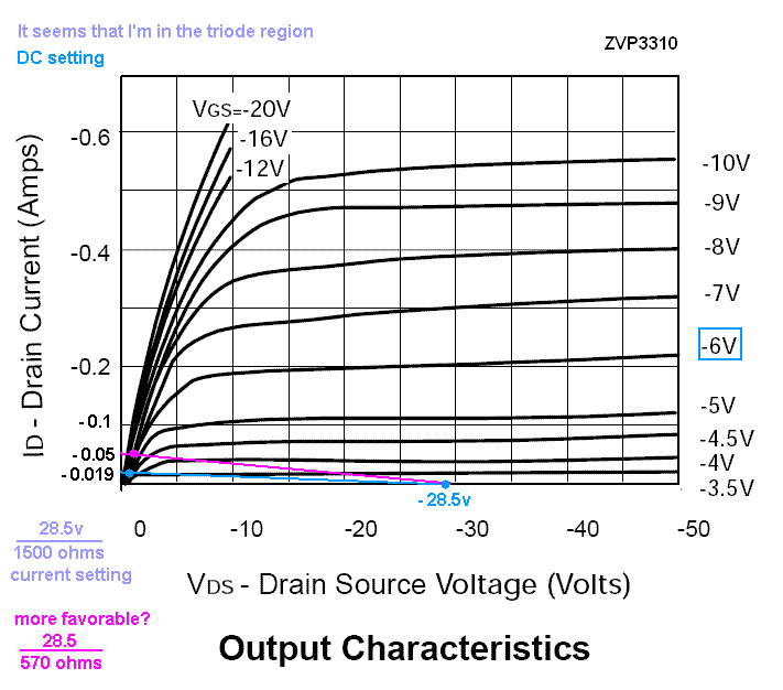

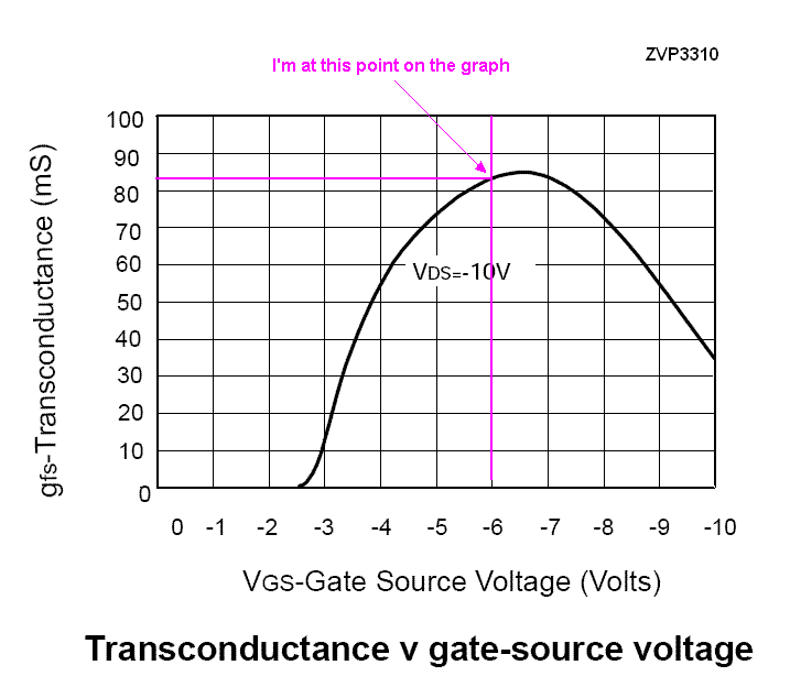

In my continuing attempts to optimize my ZV7-T, I've made adjustments to the gate voltage. I used this chart as my guide.
As configured in the previous schematic, the gate voltage comes in around 12v. This is too high according to the graph I'm presenting.
I managed to lower the gate voltage by reconfiguring R13 to 1.5K and R6 to 147K. This netted me 6 volts at the gate and 9.5 volts at the source; it's interesting that the source voltage always remained exactly 3.5 volts above the gate voltage in my reconfiguration attempts. 🙂
How does it sound: just perfect--until the next reconfiguration makes it better. Diana Krall's band really impresses me, as does Diana. I can hear sounds that have never, and I mean HAVE NEVER come out of that CD. It's the coolest thing...
Edit: R6 in the previous schematic really should be converted to trim pots. This way the outputs can be adjusted to be perfectly symmetrical. I'm almost of the mind that the sources can be linked and given a constant current source at the junction.

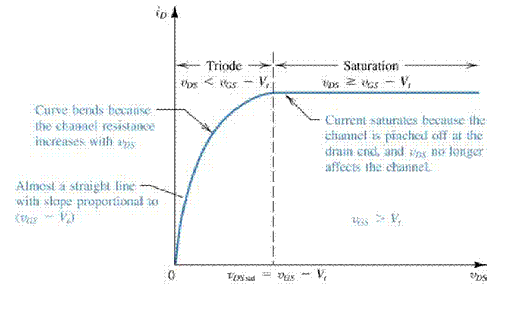

In this illustration, I'm left feeling confused--what else is new😀 --as it seems that I'm supposed to subtract the VGSth voltage from the actual gate voltage. If this is the case, then I'm left if far better shape with regards to the load-line I posted previously. Instead of having a VGS of 6 volts, I'm closer to 3, or so. This places me somewhere around mid-center of my load-line. I think...
Help?

Carpenter, Yes, your voltage gate to source on your 3310 is always going to be about 3.5 or so. In the original ZV4 buffer, the Drain was at ground and the gate effectively was too. Since you have a voltage at your output (23V I think, ZV4 had 0 Volts at the output) you need an R to ground at the gate and your feedback loop also acts as a voltage divider. Some of that divided voltage will pull up your gate. There will still be 3.5 Volts from gate to source though. And that gate voltage will be applied to the output of whatever you drive this thing with so you need the input cap on there. The input signal will also see the gate to gnd resistor and possibly loose some input level. All of this needs to be taken into account for proper operating point of the follower and the overall gain set-up.

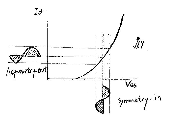

babowana, I just opened the little graphic your sent on post 233. Nice piece of info on a load line. Is that the transfer characteristics curve? Please explain how you did that. 😀
Hi, John
The curve was an outcome of my non-distilled work. Means that it is not on the actual scale. Anyhow, I think that it is good enough to represent the characteristic of MOSFETs. As you know, the transconductance is non-linear, which is the cause of distortion.
The correct curves could be obtained from the datasheets, hopefully . . . 😀
