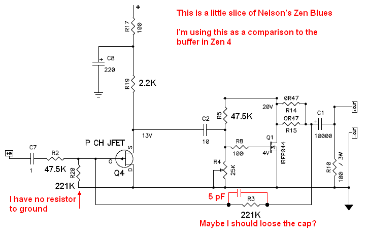

You are giving dc feedback to ZVP3310 gate, on purpose . . . ?
I just wanted to thank you, babowana, for pointing this observation out to me. In Nelson's "Zen for Blues" I see that you can send dc to the gate, but only if you reference to ground. Your suggestion made me wake up and explore the entire feedback loop.
You're a gem🙂
John
Well now... I just soldered in a 221K resistor from the gate to ground of both ZVP3310s.
Now I have the most realistic sound of the ocean coming from my horn!
Back to the drawing board.
btw, the gate voltages are not the same. One is 3v the other is around 15v. The resistance value at one buffer gate is 110K, the other is 37K. Perhaps the 37K fet is blown?

John, I was just wondering, why did you go to the buffer input anyway? I went back and started re reading this thread but, I just thought it would be quicker to ask😀
And as long as I'm asking, what are you currently using as the load L😕
Also have you had any destruction you might attribute to the big chokes doing a flyback thing? Have you always had those 36 ohm Rs in there?

carpenter said:How do I lower the input impedance of the buffers?
John🙂
I think that the input signal sees
47.5K
ZVP3310's Gate (Very high R so ignorable as an open)
221K (to the ground)
221K (to the output)
Therefore the answer might be
Reduction factor x (each of 47.5K, 221K, 221K)
Papa's values are not absolute
We could cook them for our taste, maybe better taste 😀
By the way
Now your Vdc across ZVP3310's DS is about 23/2+4=16V
Mmm . . .
30-16=14V
14/1.6=9mA (ZVP bias current)
You could increase this ZVP bias current a bit higher if you want
by reducing R13 of 1.5K
And
I recommend to have input coupling cap in front of 47.5K (R2)
Hi babowana,
I added a parallel resistor to R2 so that value is now 23.75K. I'm also thinking about lifting the R4 resistor (as an experiment). Now, if I do that, then I probably need to run a resistor from the buffer gate to ground. But, I remember the static I created when I added 221K resistor gate to ground earlier today. Maybe that's not such a good idea...
I might just add a series resistor to R4. Wouldn't this eliminate some of the feedback? Feedback reduces gain; yes I remember that this is a unity gain device.
Making R13 a smaller value will create more amperage, will that make a stronger signal to the IRF044ns?
I am rambling a bit here...
You know what? Maybe I should add drain resistance, draw from the drain and just make the buffer a gain device.🙂 Can the N channel IRF044 use a drain signal from a P channel mosfet?
John
John
carpenter said:Now, if I do that, then I probably need to run a resistor from the buffer gate to ground.
I think that you need to run a resitor to the ground in any case
Otherwise, the buffer gate will always see all DC of +23V
Then, we will lose good chance to control the DC level across R9 and R13
carpenter said:I might just add a series resistor to R4. Wouldn't this eliminate some of the feedback?
I think so because greater R4 gives more fb-ac voltage drop
carpenter said:Making R13 a smaller value will create more amperage, will that make a stronger signal to the IRF044ns?
I think it would provide enough (or more than enough) current to the input capacitace of the power mosfet, and might improve high frequency response
And again I highly recommend input coupling caps
I always protect source seeing DC directly through the input node
