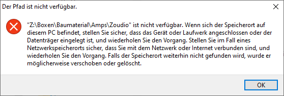

Moreover v 2.2 of the config tool can't read files from my NAS (every other program can including v 1.14 of the config tool.)

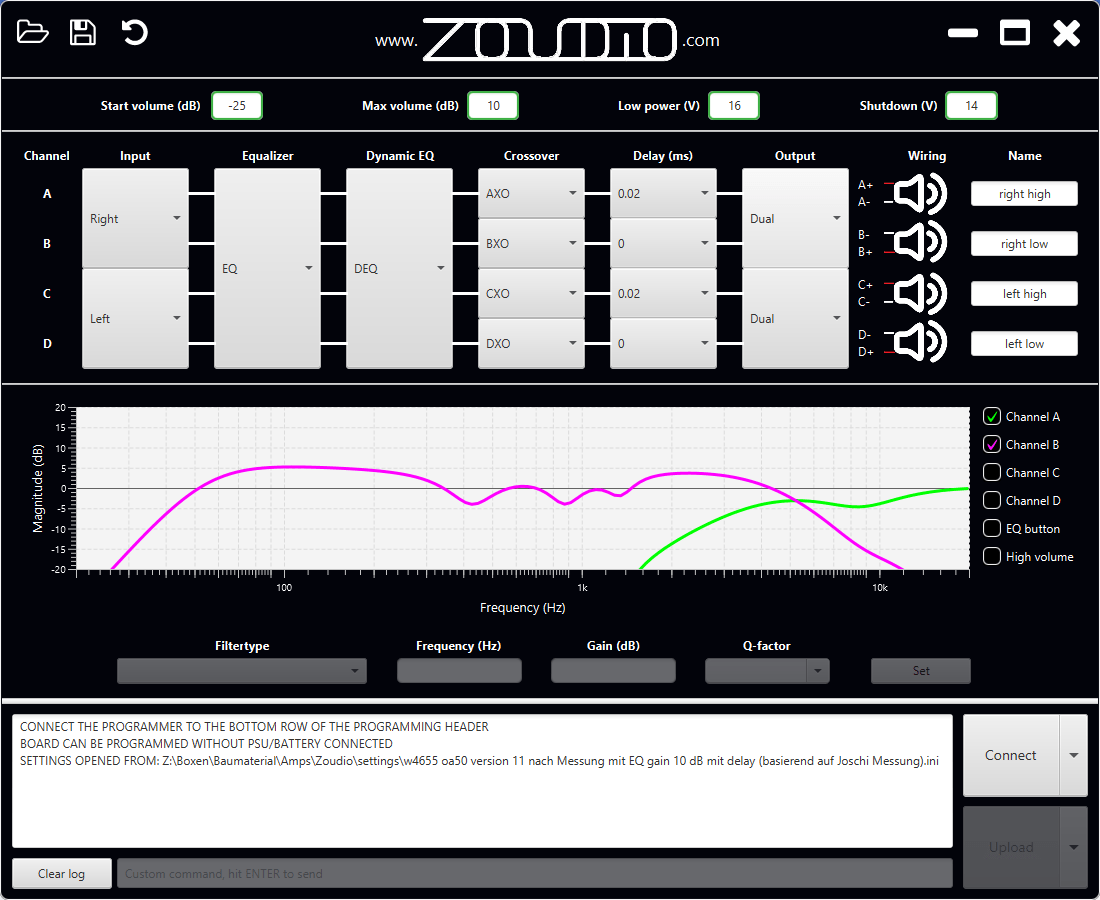

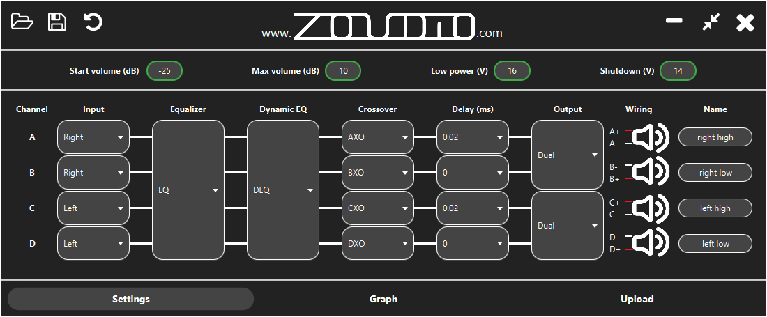

I have to correct that statement, it can visualize the general frequency graphs but not the EQ button, DEQ works too (in visualization). But I found a way worse bug: My saved setup which I imported changed even if the settings stayed the same. My left channel input outputs to both tweeters and right channel input outputs to both woofers.Also v.2.2 of the config tool can't visualize EQ settings or dynamic EQ settings, but v 1.1.4 can. So I guess v 2.2 can't program AIO4CH properly concerning dynamic EQ or EQ button?
Here is how it looks like in V. 1.1.4
and here it is in V 2.2

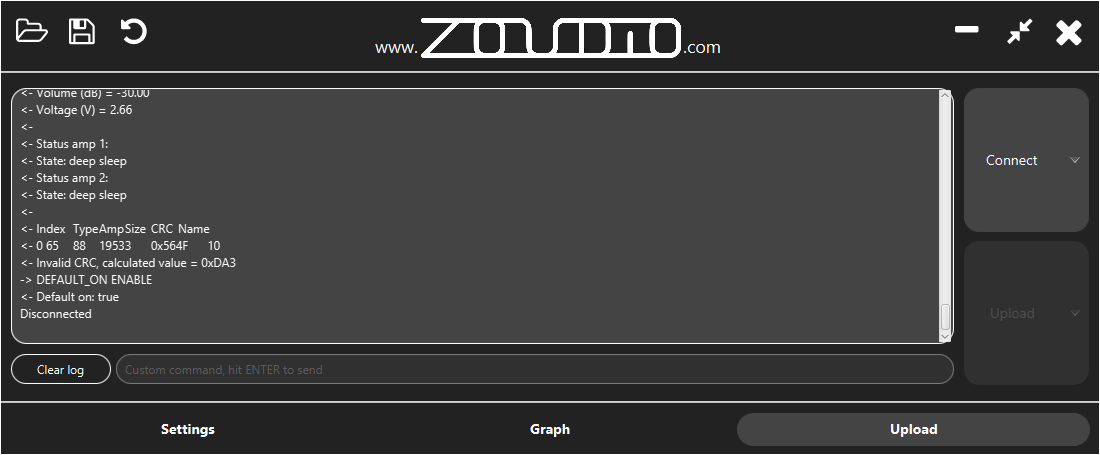

In your screenshot the DSP is not loaded. Is this the state of the amp after a regulor upload using the V2 tool?
Regarding visualization: you have filters loaded, but when pressing the high volume / EQ button checkbox nothing happens?

You mean you cannot even find it while browsing or it gives an error while trying to upload. If so: what does it say?
It does not even find the directory on my NAS. Every other program including the old Config Tool can. Old config tool didn't needed to be installed and was fine running from NAS directory and could import from NAS. New tool must be installed on C and used with admin rights. If not started from installed version on C/Programs, also save and store ribbon are missing. New tool should not have be release in that state in my opinion. Did you even test it? Windows even notices that it does not run properly when copied on Desktop for example. Only installed version works IF you use admin rights.
It is not even connected. It's only for showing you that visually both tools seem to interpret the saved settings the same but if I upload new settings my whole amp is programmed wrong. Please provide a swift solution to that. You didn't even answer all my questions. Can I undo the fimrware update? Please help debugging, do not answer side questions. My boombox is broken since, do you understand?In your screenshot the DSP is not loaded. Is this the state of the amp after a regulor upload using the V2 tool?
High volume is visually shown in V 2.2 I cannot test if it works because boombox is broken since firmware update. All kind of issues, see last post. Please help me ASAP.Regarding visualization: you have filters loaded, but when pressing the high volume / EQ button checkbox nothing happens?

I am talking about the screenshot in post #726. Here it says 'invalid CRC' which means it could not load the DSP settings. My questions was if this status log was done right after uploading new settings. Firmware updates (even if you want to roll back to a previous version) can be found on the Github posted earlier.

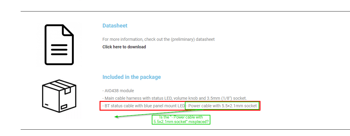

@lutkeveld: I think there are a missing line break on the product page (see attached picture). Fetched from this page: https://zoudio.com/product/aio438/
