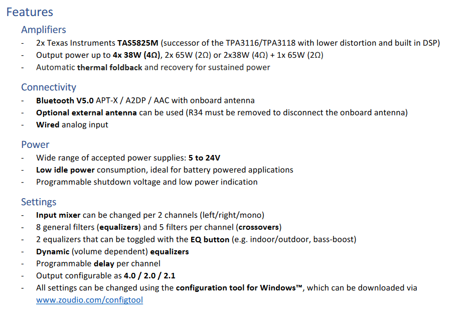

Why do you still keep things in the preliminary datasheet you can't provide to this day? E.g. delay, EQ button? This is false advertising. Me and my customer still wait for the EQ button and TWS since day one. 🙁
The firmware was not meant to be public, but I agree that a changelog at least would provide some clarity on changes over time. Some commands like the default on mode are for example introduced as a temporary way for some customers to enable an experimental feature, but there is no way of knowing when its introduced without a changelog.
TWS and EQ are both mentioned to be not implemented at the current date in the datasheet. EQ is on the todo list for the near future, but TWS is on hold until I can get in contact with a suitable developer. The firmware is unfortunately too complex for me to implement myself.

I still don't know how I use the command. Because there is no manual or similar I can find on your page. In case you didn't get what I meant: I want to know how to enable the "default on enable" command. I also want to know what else I can change via commands... I ask for a proper documentation. I think not for the first time. Is it asked to much? Where is your manual? When do we get it?The firmware was not meant to be public, but I agree that a changelog at least would provide some clarity on changes over time. Some commands like the default on mode are for example introduced as a temporary way for some customers to enable an experimental feature, but there is no way of knowing when its introduced without a changelog.
Simply not true: https://zoudio.com/wp-content/uploads/2022/04/AIO438-datasheet.pdf Look for yourself. EQ button is mentioned (since beginning) so it should work.TWS and EQ are both mentioned to be not implemented at the current date in the datasheet. EQ is on the todo list for the near future, but TWS is on hold until I can get in contact with a suitable developer. The firmware is unfortunately too complex for me to implement myself.

@subkultur
Oh yes, I see. It is mentioned in the button description but not there. Sorry for the false claim
Which version of firmware are you running? You can request it by sending 'FIRMWARE' when the amp is on.
The default on command is added in version 2.2.0 of the firmware.
