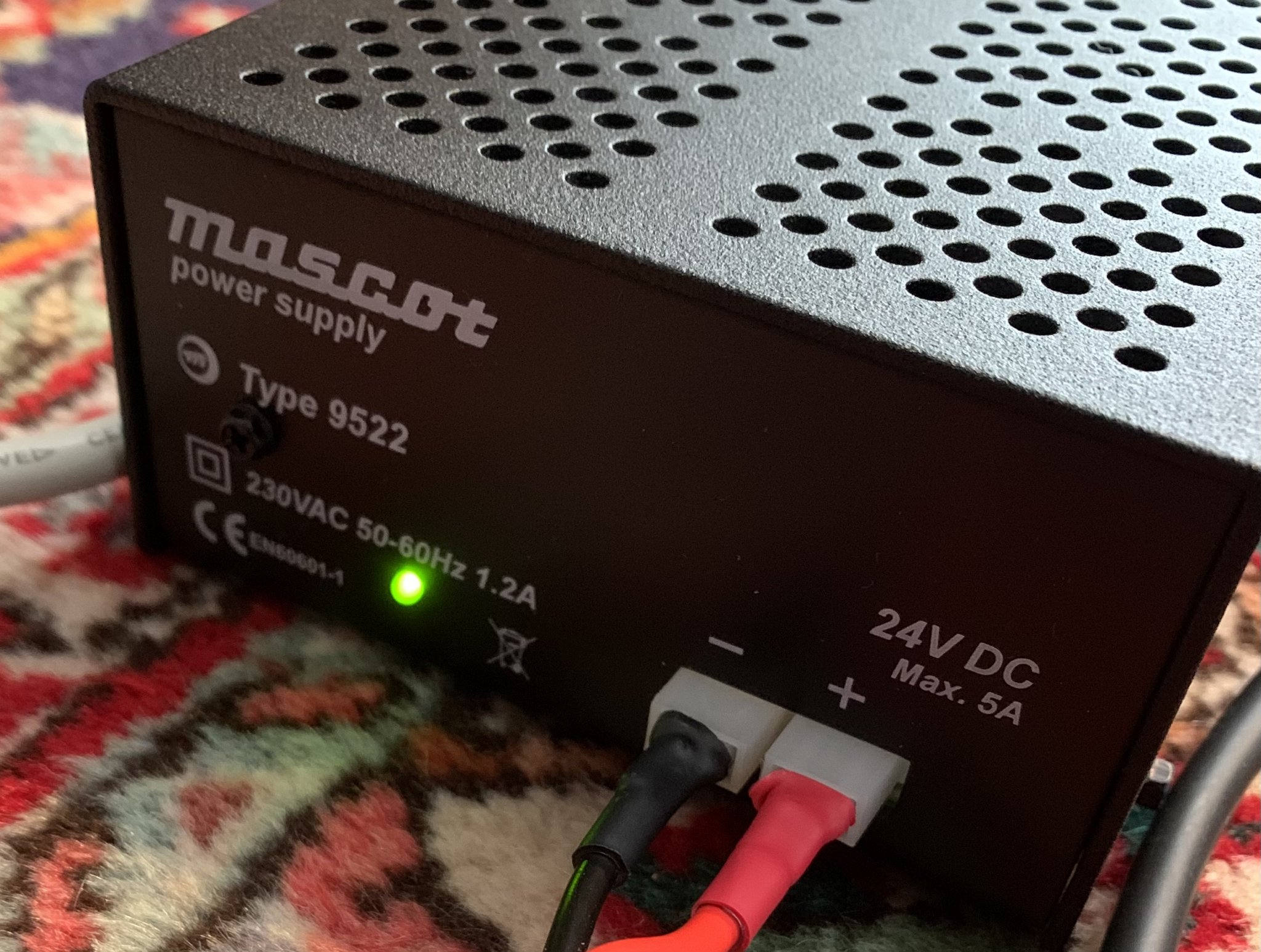

@tommus et al. I have a lot of first hand experience with sensitive electronics causing problems when fed slightly higher voltages, I have seen some devices that are approved and working fine at 24.0V for years, but if you try to feed them 26.0V it can fail within a few months, I've seen even quite basic locking mechanisms can also fail prematurely if you just provide 1 Volt more than what is supported in the datasheet.It's not a problem at nominal voltage, only when fully charged.
In the old days 24V was anything from 20-29V, 12V anything from 10-15V and nobody understood why some things lasted while other things broke down fast.
In modern electronics where it says 12-24VDC or 12-26VDC: 24V is 24.00V and 26V is 26.00V, and for 12V it's never a hair above 13.2V, I've seen some circuits fail at 14.5V but work fine "forever" at 13V.
Ofcourse there are circuits/devices that do work perfectly slightly or sometimes a lot over voltage, but it's not wise to blindly assume this is always the case. In most scenarios, and especially involving devices with IC's, the voltage limits should be seen as absolutes.
So for these circuits by lutkeveld/Zoudio I highly recommend to stay below 26V and view that as a "hard limit" that should not be crossed.

I have a battery pack consisting of two, 12V 8AH gel cells. I charged it up using the charger for a 24V electric lawnmower, having two 18AH, 12V batteries. Using my brain, I took the time to measure the open circuit voltage across after the charge; 27.3. I decided "better not" and, that wasnt even the Zoudio amp I was considering connecting it to, just some $12 class D job I got off ebay.
(Battery power makes things easier to test; no earth ground and its loops, no power supply noise - and all the current in the world...)
What I need is a charger that'll take the batteries up to 26, then stops providing any more current into the battery. I havent tried such to see what actually happens and when I do, I'd still measure before plugging it in - to avoid getting tricked by some unanticipated battery chemsity thing. Unsure how charging to just 13V / cell effects the battery, when it perhaps wants that extra 0.2V to be "fully" charged.
There's also the possibility of designing a circuit that drops whatever the battery is at to 26, then the 0.005 Ohm RdsON pass-element turns on hard from that voltage on down. I'm sure someone could design it such that a 9V battery would last essentially its 10 year shelf-life powering the device, with the super low power actives available these days.
Why complicate yourself so much? Just build a 6S pack with 18650 cells. That will give you 25.2V (4.2V x 6) when fully charged and the charger won't go higher than that. Need more capacity? just add a cell in parallel making it 6S2P, or 3P if needed. 25.2V chargers are cheap and specifically made for this application. Don't forget about the BMS though. And speaking of that, your two gel batteries in series might not charge/discharge at the same rate and go out of balance, another thing to look out for with your method.
Edit: You don't even have to build the pack yourself, I just checked aliexpress and some even sell packs with the charger included. Example: $56 for 6S3P 10Ah pack + charger
They do that with the lawnmower... :'(And speaking of that, your two gel batteries in series might not charge/discharge at the same rate and go out of balance, another thing to look out for with your method.
Yes indeed, the easiest way to drop voltage a little bit is using a couple of diodes.Why complicate yourself so much?
I let the batteries rest for a couple days and the voltage dropped to 25.4. So I connected it. No magic smoke.

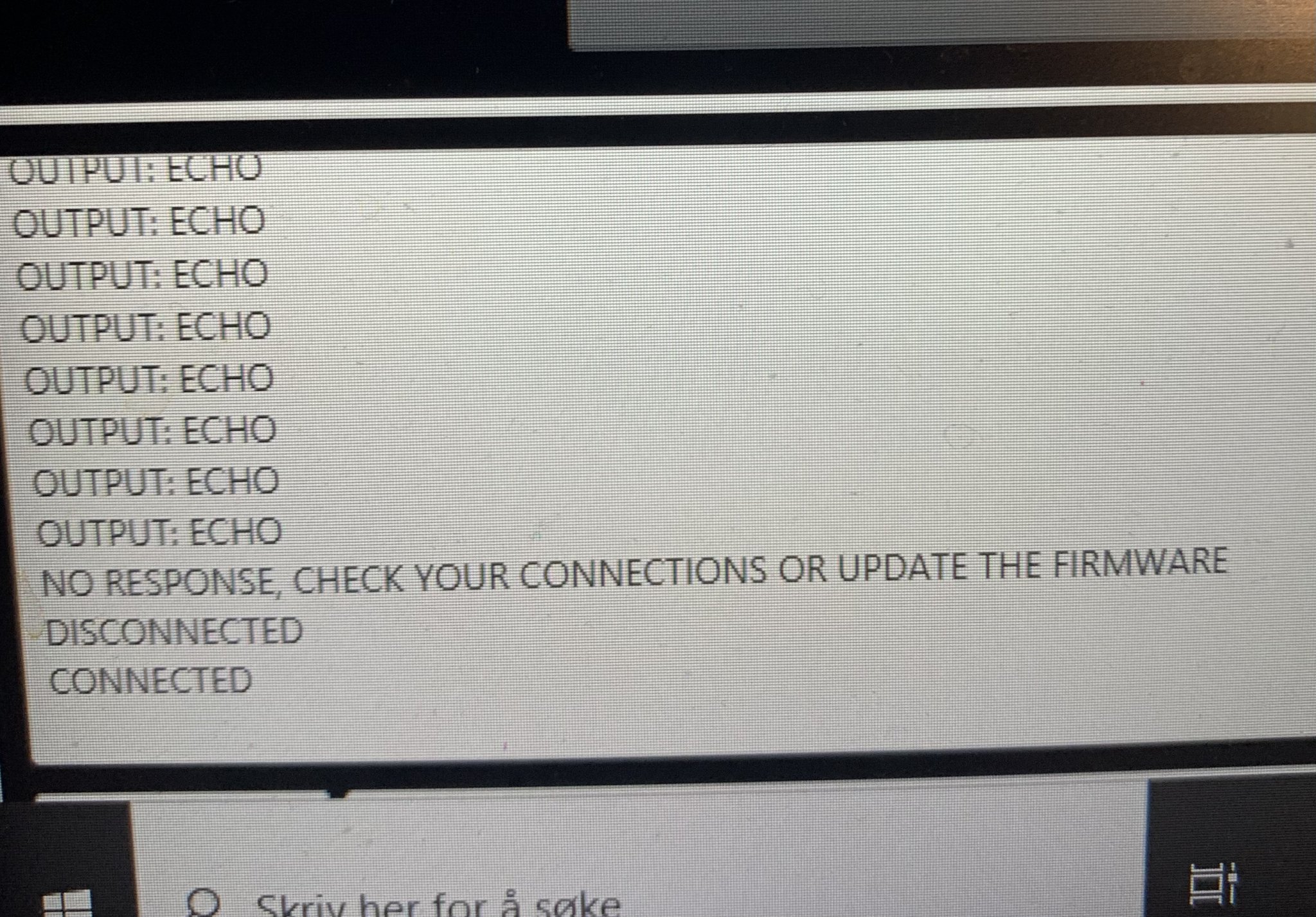

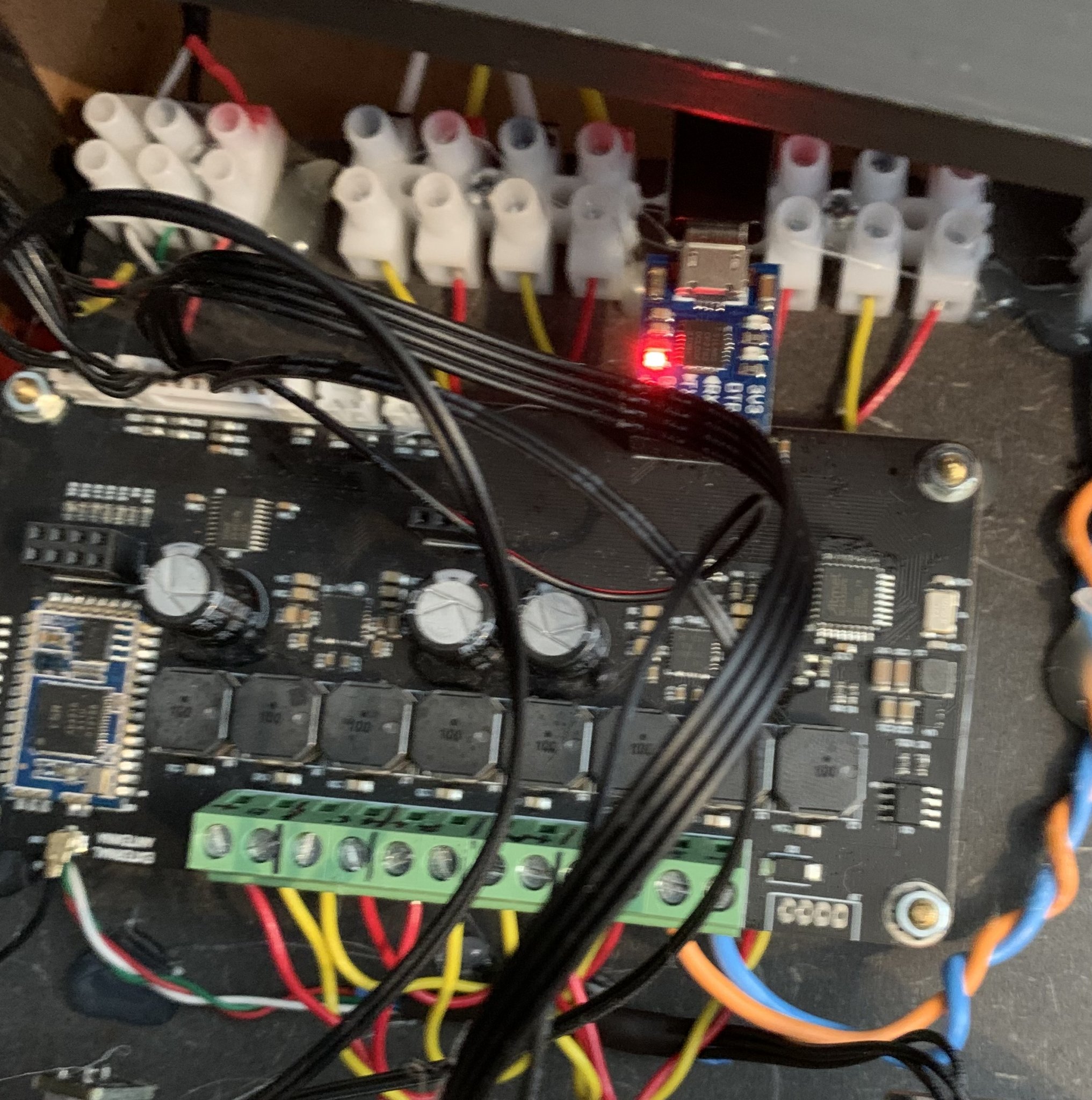

Back on the bad track again 🙁
it powered up with blue light for a short time.
now its dead except the red light on the red light on the usb interface
One of mine became unresponsive after I thought I could reprogram it on the fly, i.e. while playing music. It didnt like that and I had to get the bootloader reflashing program from Lutkeveld and with running that, I was able to bring it back to working again.
Since the board will be powered via the USB for reprogramming, I always disconnect the main power - physically - when updating filter parameters. I've never had another bricked board issue again. Unsure if this is what happened above, but I think the chances for recovery are good.
'Bootloader reflashing' is probably 'eeprom wiping' 🙂 The bootloader stays in place always.
In most cases where the AIO4CH is unreponsive it was a memory issue, which could be solved by wiping the settings and uploading again.
The AIO4CH supports uploading during runtime, but it might just be that the error occurs less often when doing it while the main PSU is off like Jjasniew mentioned.
Anyway, @superlian You can send me an email and then I can send you the memory wiping instructions, and if that does not fix it we will have to look at a different option.
