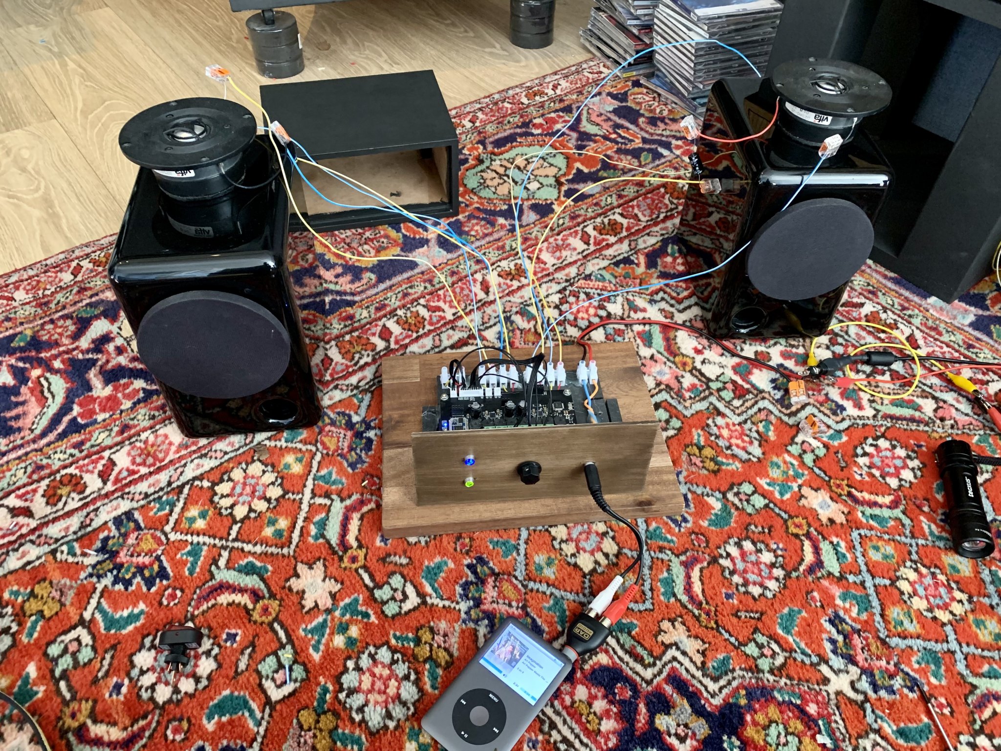

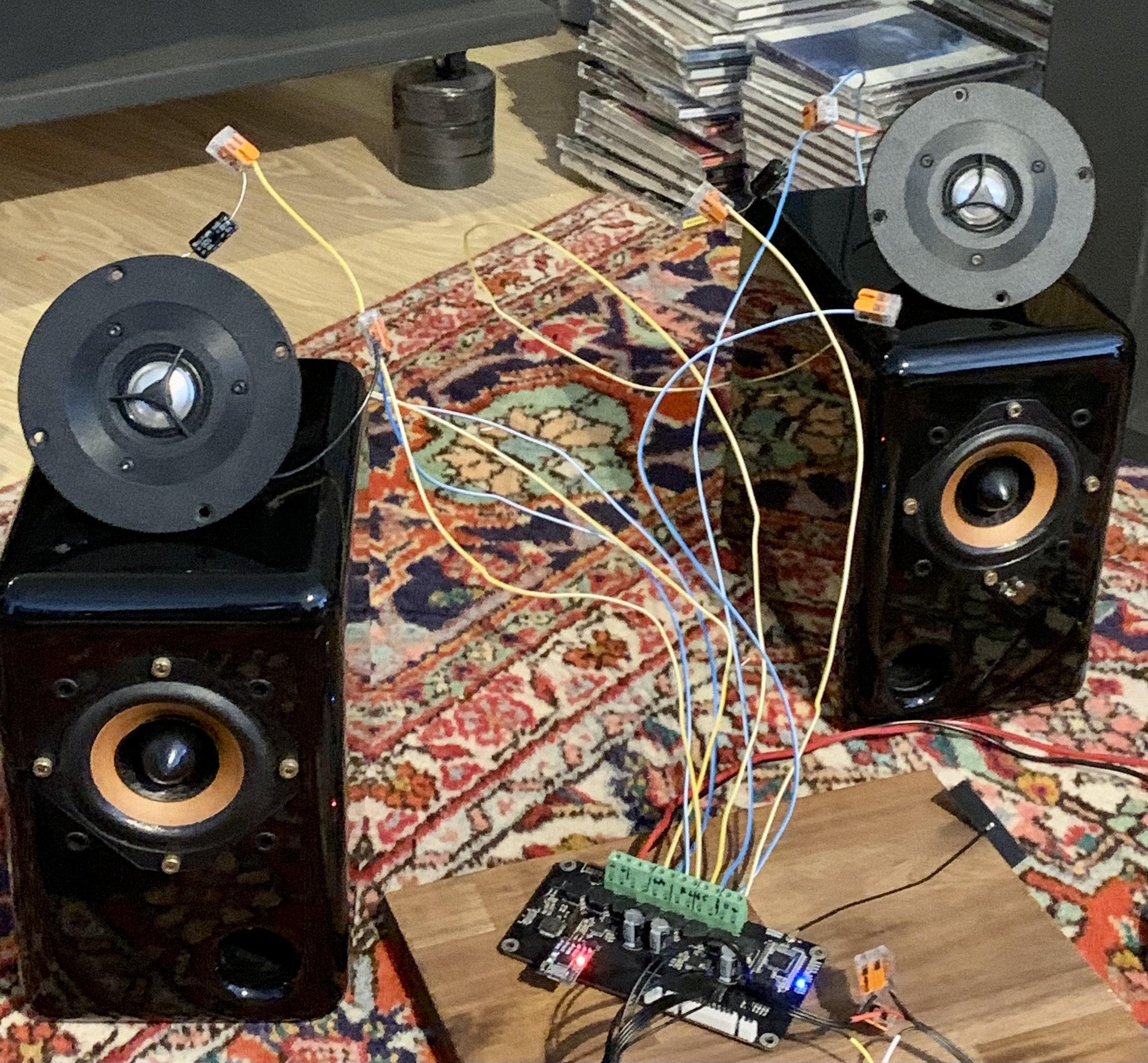

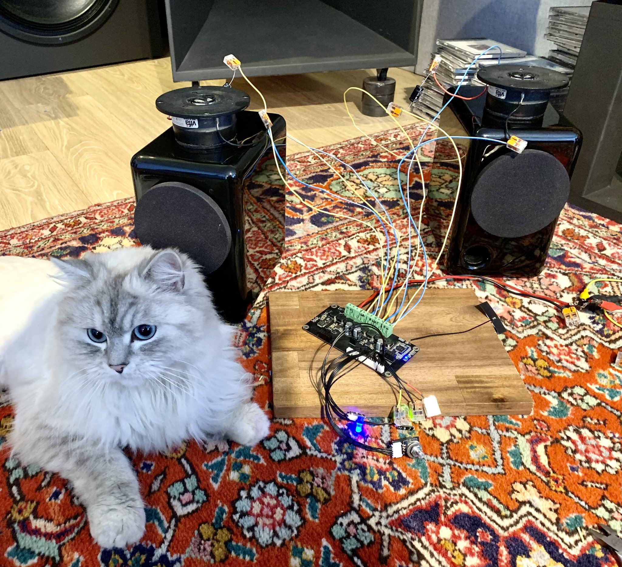

If it was me, I'd pull all the output wiring and just go across the output terminal pairs, one by one, temporarily touching the screw heads with a test speaker leads. Just to debug to the amp board level.4 channel
3000 Hz crossover
Thx for quick reply 🙂
The amp doesnt seem to mind driving into an open load. I'm listening right now with 2 channels capacitively loaded to ground through 2K of resistance on just one "side"; the opposite "pull" output not loaded at all. (A small SE tube amp buffers the sound after line level conversion...) So you should be able to do the above test without issue - as long as you dont short the channel outputs when touching wires...

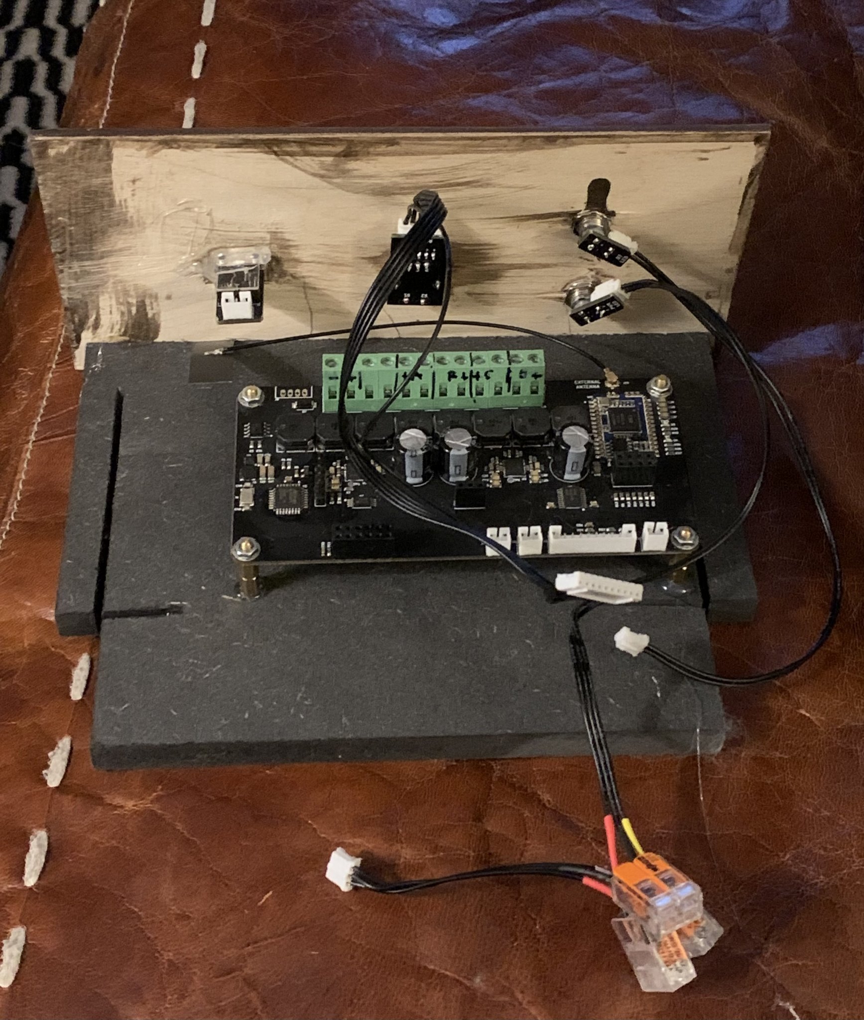

I notice your amp is hard electrically connected to the chassis, versus using the plastic standoffs provided in the kit. Not that that has anything to do with it, unless the particular output connectors, unknown to me, also bolted to chassis are making some kind of unanticipated connection. Has anyone else done this particular mounting?

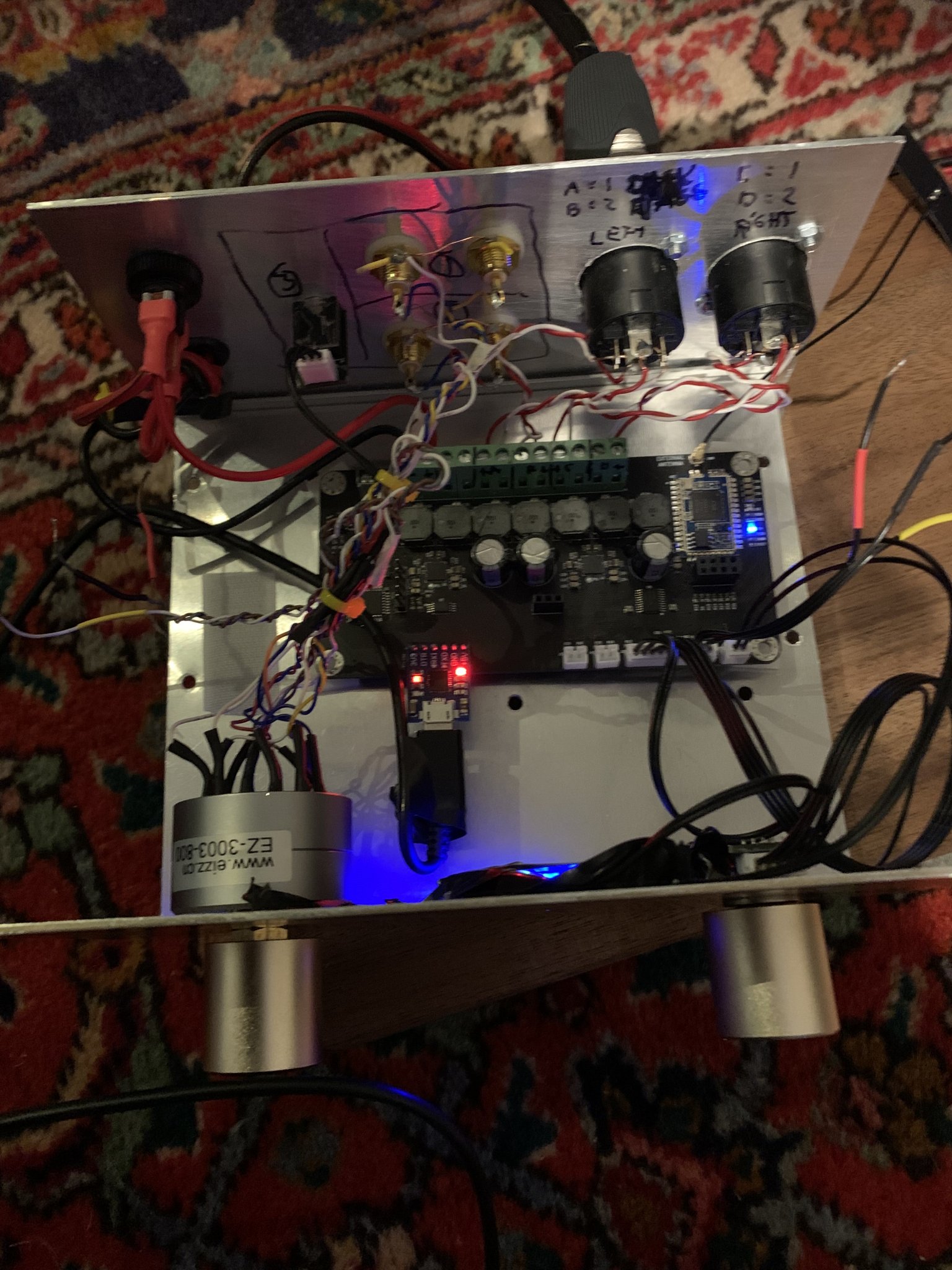

Checked all the wires and they are Ok.
Now it doesnt work again in the cabinet.
The amp board is on plastic pads, i removed the metal stands.
The analouge input is not connected.
Should i upload the standard firmware again?
My gosh, that little amp implementation is a fighter. I'd definitely upload the latest firmware.
You said (above) that it passed the test speaker touch to terminal test, but again doesnt work when in the chassis, amp on the plastic standoffs, analog input jack disconnected, output signals going through the 4-pin output connectors?
Now I'd really go nutz and ohm-out each wire to an extra speaker plug inserted into that output connector, for both continuity and isolation to the other 3 wires and chassis - even if any possible issue with those connections has to be practically impossible. Or connect 4 speaker cables directly to the AIO4CH board's screw terminals, bypassing the installed output connectors, see if all 4 channels work then.
Sorry to read your assembly is giving you such a hard time. Any chance the V supply negative connects to chassis? I see the input RCAs are nicely isolated - but I'm just grabbin at straws now! Hate to see someone have to go connection-by-connection, starting with the naked amp board on a tabletop...

Your firmware is functionallity not different from the standard firmware. It's only one byte set to 'true', which will make the amp power on by default instead of powering off.
You say "Now it doesnt work again in the cabinet."
Does that mean it only works when not mounted in the cabinet?
Try to introduce as little variables per step as possible.
So if it works, slowly mount it, then attach speakers, then attach the 10 pin connector etc...
If you want to use the external antenna you indeed have to remove a 0 ohm resistor.
It will be clearly noted in the documentation, but you could not have known since it is not online yet.
@superlian
It must be some kind of ground shorting issues with my cabinet?

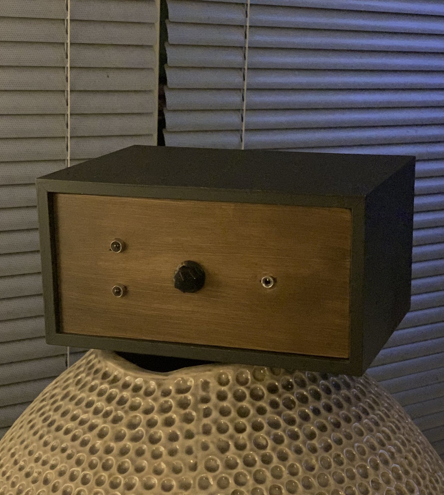

Now its working perfect with blutooth.
I dont understand how i turn analogue signals on?
My assistant loves music 🙂
My, what beautiful blue eyes s/he has!
Just plug in the 3.5mm analog input jack / cable assembly back into the board connector, connect your music source to it - and the amp should auto-detect and switch over to the analog in.
Crazy making, those grounds...glad to read you got it working!
Yes 👍 Its working and finished😊
