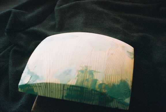

Oh ye of little faith,
It turns out that the big plano lens will be the easiest lens to get by making it by hand. It will be the other lenses that will be hard because I would like them to have at least 150mm diameter. If it turns out that the lens can only be made for a reasonable cost by hand I will be making the lenses more like 250mm in diameter.
Perhaps you have not seen my other thread on the large hand made lens. The large plano convex will be hand made at a relatively low cost.
Here is a picture of the mold blank in it's current state.

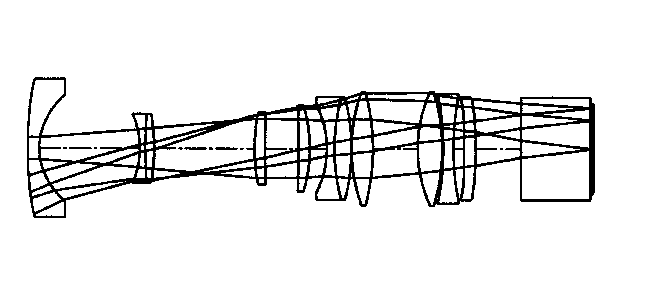

Guys,
It is unlikely that any optical engineers are going to sit down with us to design a system of this complexity and a zoom lens system with high resloving power is far more complex than you might think. Here is a picture to give you an idea.
There are however a few differences in our design that can relax the design requirements considerably and that is that we don't need as much resolving power as a photographic zoom lens.
We only need to be able to resolve an image the size of the smallest pixel on an average LCD screen. Say .23mm.
In photographic film the lens needs to be able to resolve each minute dot which is several orders of magnitude smaller than we need. This is why photographic quality lenses are so expensive because the finer area the lens must resolve the more complicated it is because it must have lots of abberation correction.

I'm sorry hezz... but I really dont see your lens working anywhere near a high quality cut and ground lens. There is just too much involved in making a good lens and now you say it's easy... your hopes are way too high friend. Then theres coatings... which your lens wont have and is far from easy to do... and even if you did it yourself it still would be a sub-par lens.
Giant PCX lenses arent found anywhere because they are anything but easy to make!
There are other ways that would work better. Making your own giant lens... isnt one of them.
I hope you prove me wrong... but I doubt it 🙂

How do you think the highest quality lenses are finished?
By hand. In fact PCX lenses are very cheap to make in large quantities because they are injection molded from plastic. But what keeps them cheap is the fact that they don't require much final finishing. The mold is made to such high standards that the final lenses need only a small polish.
The only reason large PCX lenses are not made is because plastic is not a stable enough for higher mass objects so a large PCX lens would have to have extensive grinding and polishing done to it. Due to shrinkage and other factors. However my manual method overcomes many of the technical factors which make mass produced large lenses impractical.
This raises the cost to where it has little advantage over glass.
The amature telescope makers routinly make hand ground mirrors which are superior to machine made lenses. The only setback is that they are work intensive to make.
The machines follow specific grinding and polishing procedures which can be duplicated by hand in many circumstances. The only lenses that we can't make by hand are aspheric lenses.
Besides if you don't wish to make the large lens you still use a fresnel which will work in the same way however with reduced imaging properties.
