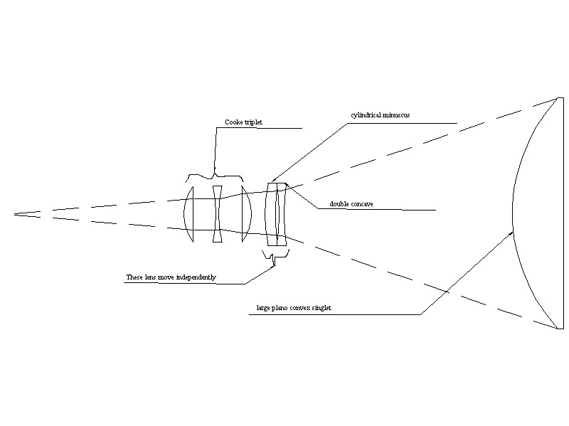

Here is the lens system information. With this anyone should be able to reconstruct the lens system and a lens manufacturer can make up the correct lenses. I will try and reoptimize the lens system using plastic lenses for at least two of the larger lenses in the near future.
By the way in this lens system model all of the lenses are AR coated.

I made a mistake, the above lens has a 400 mm FL. The 481 is the total track or distance from the fist lens surface to the focal plane.
I have a microsoft word document that has production drawings for a 450 mm FL version of the lens in glass. If anyone wants I can e-mail the files to you along with a self executing solidworks e-file that contains a 3D viewable model of the lens.
