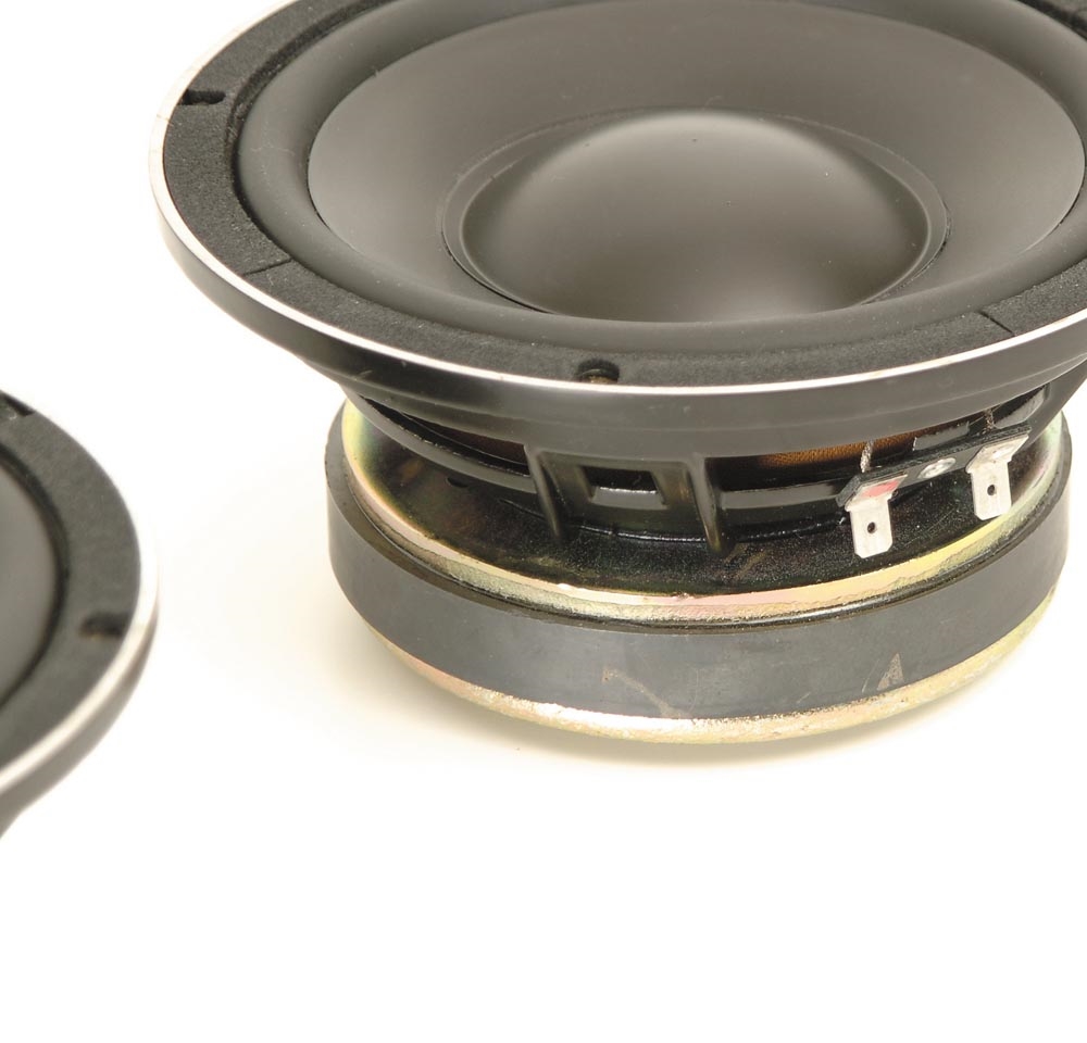

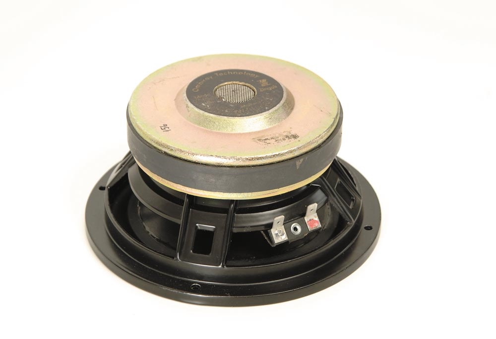

Thank you Earl, that is really useful. Today for a change I have been making a small brick wall in the garden. This evening I have opened up the Overture 2 and have put the values into Xsim. The actual resistance of my bass and horn units is 5ohm, so I’ll have to hunt for something more realistic. I made up the 1mH inductor value.

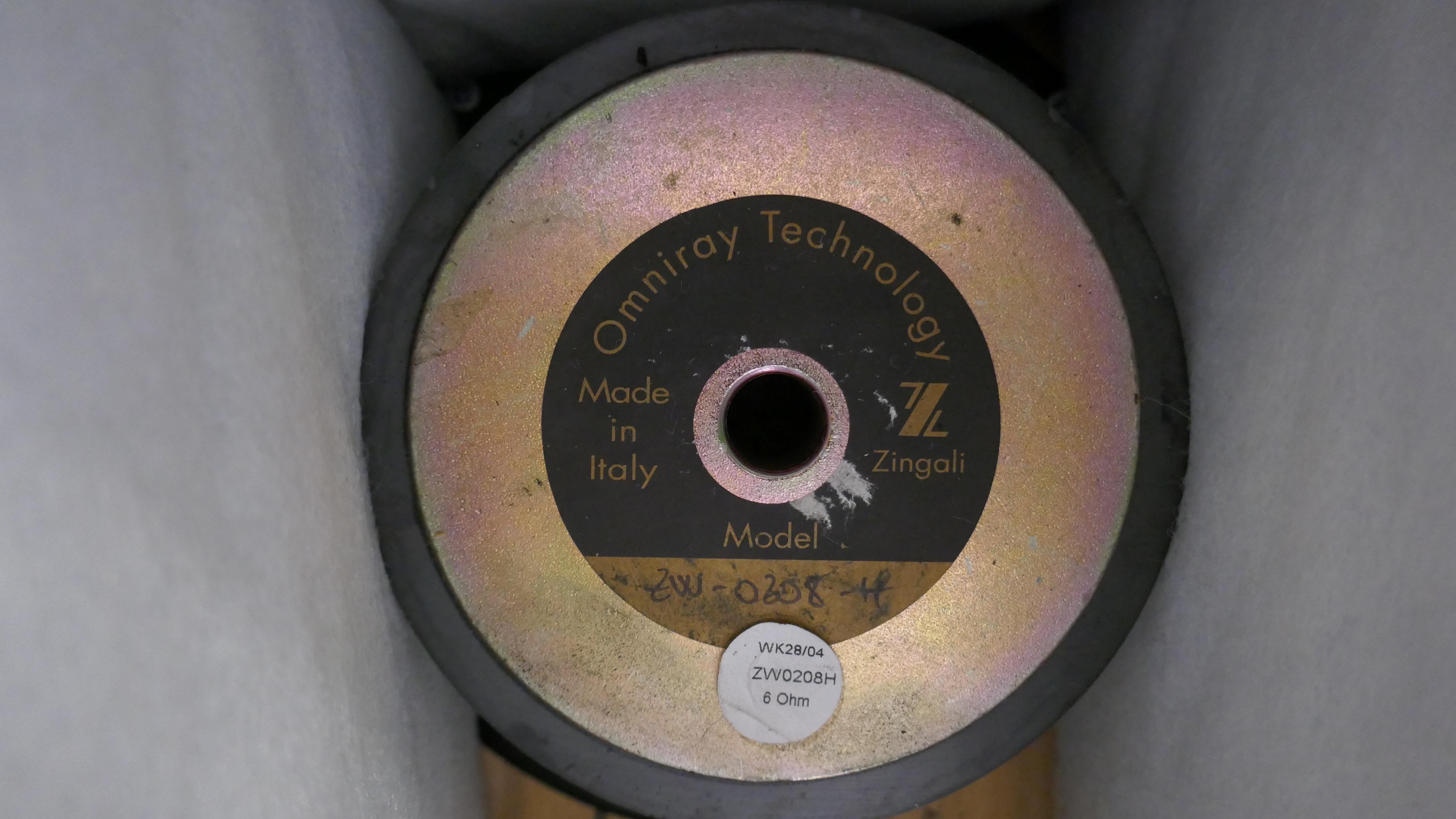

The drive units are about 15 yrs old. Last year the bass unit foams disintegrated and I got them re-foamed. Bass magnet is 130mm dia, horn 90mm.
I would post some more pics but my files are too large. Try again tomorrow.

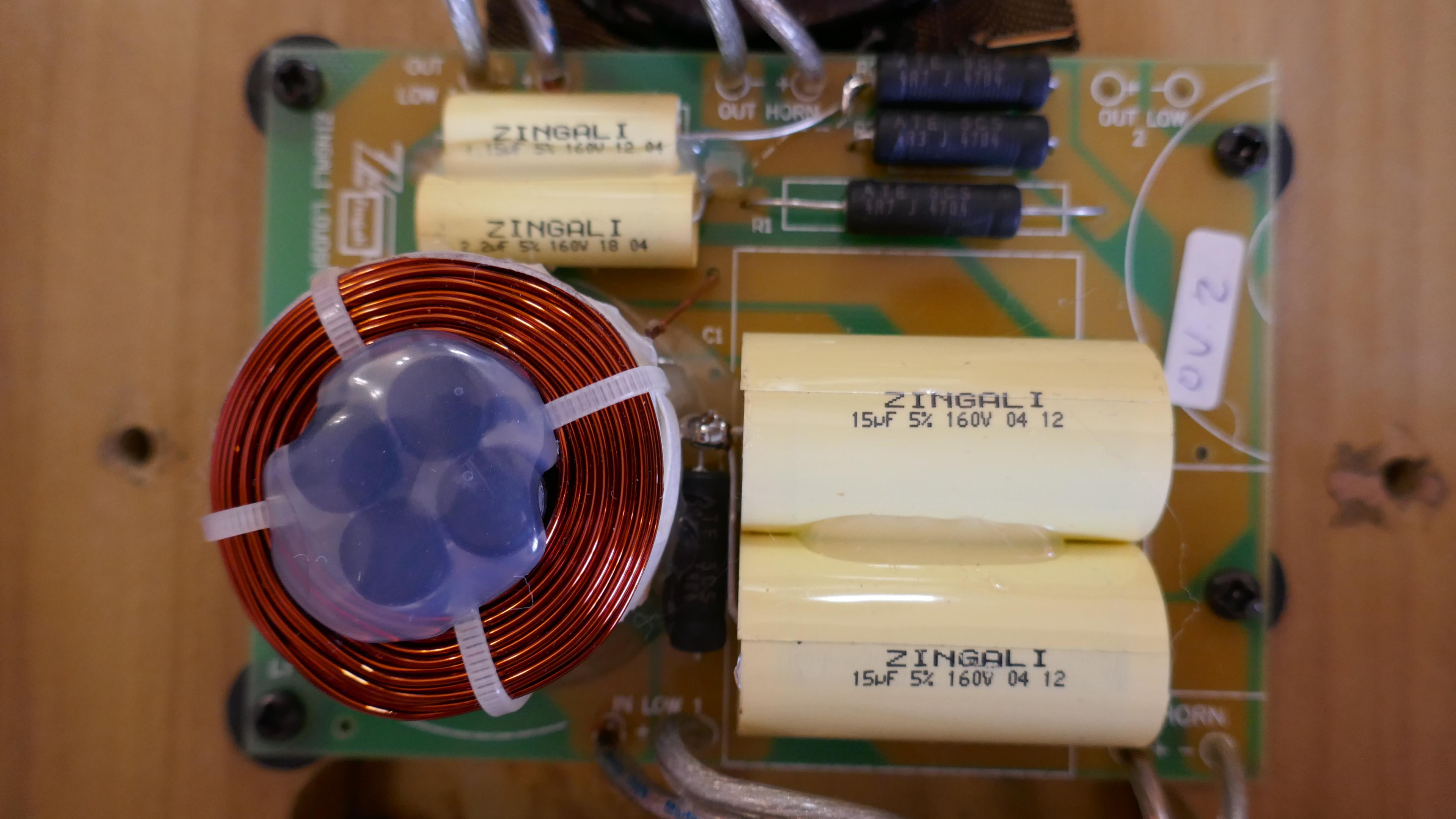

FYI, the dcr value of the B+C de10 is just over 5 ohms ( and has a 90mm diameter magnet ).
I suspect that your woofer was custom built for Zingali.
I'm confident that the pictured inductor has a value quite a bit more than 1mH.
- It appears that Zingali wound their own air-cores and then added ferrite rods ( inside the air-core ) to raise the value of inductance.
- The 4 ferrite cores that I see ( under the silicon goop ) should more than double the value of the original air-core coil.

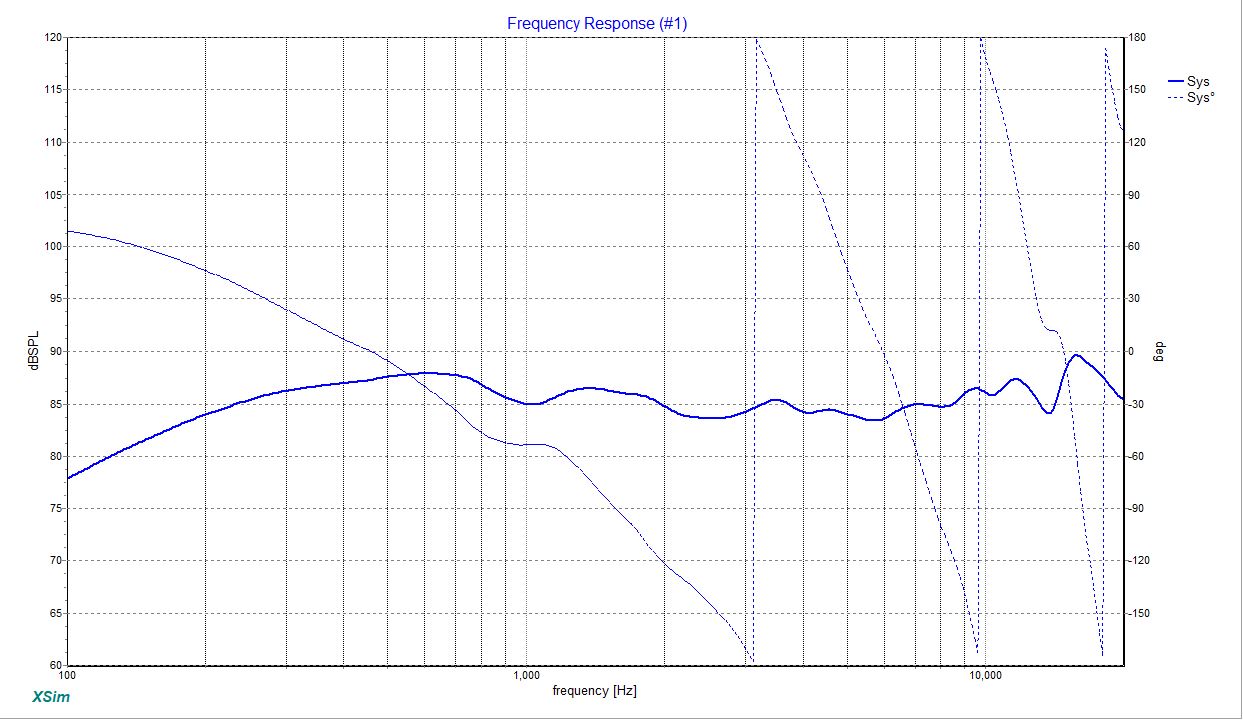

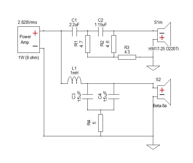

Using Xsim (although I do not have a true driver model) to see what I could mod to tame the high end a tiny bit. C2 being the likely candidate first.

( Looking at your posted XSim schematic ), simply make R3 smaller in value > to bring down the horn level to a more desirable balance ( resistors being much less expensive than audiophile caps ).
In fact, one could wire a 30 ohm variable resistor in parallel to the existing 4.3R wirewound ( and then adjust to taste ).

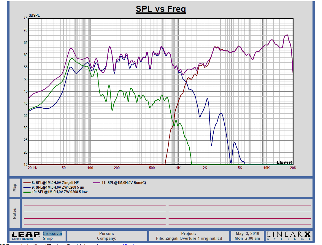

From looking at the overall response of the Overture 4 ( within the pdf I posted earlier ) , I suspect your Contour 2 also has a bit of a jacked up driver level ( due to sharing the same family name + most likely using the same compression driver ).

- Additionally, shorting R4 ( the 5R resistor ) will bring back even more midrange ).

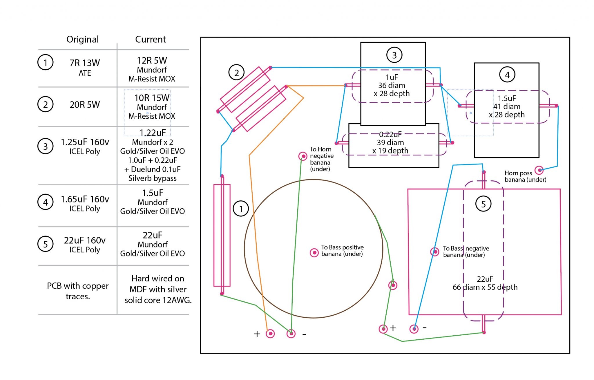

Here is the circuit, sorry for my basic stick drawing. Hopefully you get the signal paths.
I have marked the original Zingali values, then my values. I got some help on here on how to increase the horn level by changing the

So I need some advice on what I need to alter on the resistors, to reduce the horn gain a bit. Is it resistor location 1, or the pair at location 2?
Once I can get the horn gain down a bit, then I can see if I need to tame the upper treble a bit. I also thought about trying a pot on the R1, if that is the location, to tune it live, them add a fixed R after I know the value.

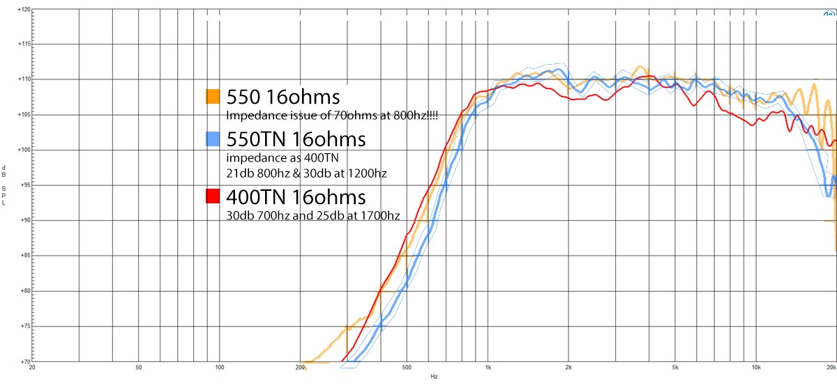

On my Zingali Client Name Evo 1.2s, they use a DE400TN 16 ohm 44mm 1 inch throat (mounted) compression driver by B&C Italy. 107dB efficiency. It comes in at 1200hz right up to 20K! It actually starts to tail off after 10k, indeed loosing output from 5-6k.
SO.... I am thinking I can extract even more performance out of these speakers. As luck would have it, B&C make a DE550TN 16 ohm 51mm 1 inch throat compression driver which has more power handling, up from 100W to 140W. And the FR is slightly better in the crucial 5-12K region. Rest is the same, very close to the DE400TN model. So should work ok with the existing crossover, and will fit the mounting as well.
Imagine I will need to adjust the T pad values a bit, as the 550 has 108dB. And being new may have bit more output?
The bigger driver will possibly be less stressed and more dynamic, a step up from the DE400 I am thinking. Zingali never used this driver, but it is new, so probably why.
The existing Zingalis are really good, great sound. If I can get even more out of them, maybe bit more midrange details, and smoother treble roll off, I can then reduce the T Pad down a bit, and bring up the mids a bit. That is my idea.
Thoughts?
