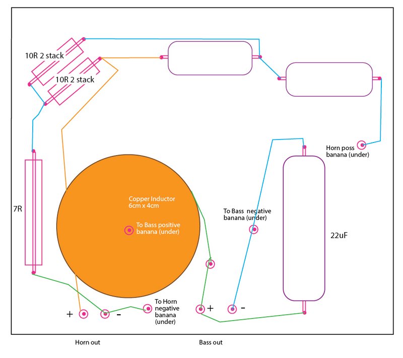

It would be helpful to see the other side of the board, and the labels showing where the wires go.
I will show the PCB reverse shortly, when I remove it. The HF is top right, LF top left.
Are you going to post a pic showing the backside of that network?
Once you do, I'll post one likely network layout.
Yes I will do that. Do you think it is possible to de-engineer this, so I can build a new one?
I don't hold much hope of getting a schematic or BOM from Zingali.
I can measure resistrors for values, in fact I know everything except the inductor value. No idea how to measure that.

Hi Guys
Here is my graphical representation of the crossover PCB layout. It is a 2 way 8 ohm, 95db efficient. 12 inch bass, 12 inch horn compression driver. crossover frequency is 1000hz. So the horn does pretty much all the range.
The horn is probably 104dB and the bass driver 95db. I think the 7 ohm resistor and the 10R 2 storey x 2 stack in parallel brings the gain on the horn down to match the 95dB level?
The old caps (18 years old) are probably Mundorf classic, or maybe ICEL as they are Italian and cheap.
I am replacing all those with top Mundorf Silver / Gold in Oil Evo supremes, bypassed with Duelund silver 0.01uF.
Resistors will be replaced with Mundorfs. I would like a bit more gain on the horn v the bass output, so was thinking of dropping the 10R stack to 8R stack, which would give 1 ohm difference I think? Maybe 1dB extra volume. Totally guessing here.
I have made a new board out of MDF and hardwired it with teflon insulated solid silver single core wire about 14 AWG.
I would like to replace the single Inductor but don't know the value yet as my meter doesn't read uF.
Any insight and thoughts on this would be great guys. I am shooting from the him, and have little crossover knowledge so...
It is a 12th octave 2 way crossover I believe.
So my crude drawing shows the banana inputs under the board, and the 2 pads at the bottom connect to the horn or bass drivers.

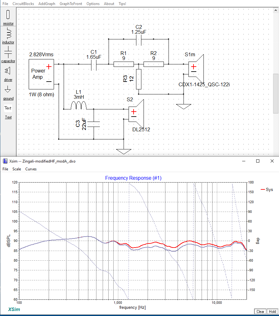

Thanks !! for the pics Astrostar59.
After studying those pics I concur with your assessment of your networks circuit flow ( as seen below ).
Here's what your circuit looks like after it's been entered into XSim.
( Gray line is the original horn response as given by my Celestion/QSC Horn/Driver standin > which is pushing 110db so it's not a bad starting point )
( Black line is the increased horn response accomplished by choosing larger resistor values> it's @ 2db more )
( Purple line is the horn response from the original resistor values )
- The inductor value ( of L1 ) is simply an arbitrary choice ( that works well enough with the 22uF capacitor with a typical 12" woofers impedance curve ) .
One can see that the 95db sensitivity figure ( as stated by Zingali ) is a nice bit of fiction. 😛
PS; Thanks to Zilch ( RIP ) for providing the Celestion & Eminence driver frds & zma's ( used in the simms ).

Wow, thanks for your work on my crossover EarlK, I am super impressed!
I finally fitted it back in the speaker tonight. Seems to play ok of a test amp. I will try properly tomorrow as wake the neighbours up.
You said "Black line is the increased horn response accomplished by choosing larger resistor values> it's @ 2db more"
Did you mean lower values R as wouldn't that increase the volume on the horn? Higher values would increase resistance so less volume?
If I wanted a bit more gain on the horn (more volume v the bass driver) which resistor would you change? I thought the single 7R resistor coming off the horn out minus tab. Maybe try a 6R. What do you think?
It may be ok as is, as I already replaced the 20Rs with 18R, the parallel stack which had 2 x 20R one side of the 1.25uF cap, 2 x 20R the other side of the 1.25uF cap. No idea why it does that? Is there a reason, maybe to tweak the FR curves?
Yes, I bet the Zingali is actually about 92dB, as I can't find a 95dB 12inch bass driver made by the Italian supplier. I will dig out the one I think it is and post a pic / specs.

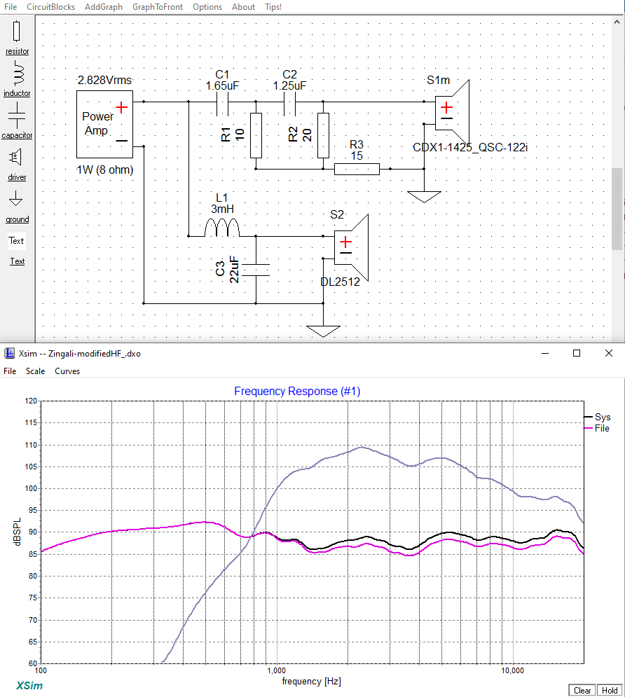

The green single 7R resistor on the HF circuit (left side) I will try lower values in that later, to tweak the gain on the horn v bass driver. I think I need 2dB extra.
Your instincts are a bit backwards here, you need to increase the value of that 7R resistor to get more voltage to flow towards your compression driver.
That 7R resistor "pulls/sinks/shorts-out" the available HF voltage , pulling it down to ground ( essentially denying it from being used by the circuit > the compression driver ).
Try a value that's somewhere between 12 to 20 ohms ( instead of the original 7R ).
12R, will give you the "red" line ( a noticeable increase from the grey line ) as seen below.
PS; BTW, your instincts are correct regarding the double-stacked 20R resistors; making them smaller in value does allow more voltage to get to the HF driver.
Hello EarlK
Many thanks for your advice, I greatly appreciate it. I popped in a 12R to replace the 7R as you suggested. And also dropped the 20Rs x 4 down to 10Rs x 4.
The sound now is about spot on. The horn has come up for sure, more treble and mids. I will leave it like this for 2 weeks, see how the caps burn in and change. If they open uo a LOT I may put 15R x 4 in instead.
It is really close to perfection right now though.

Hello EarlK
I was thinking. The larger resistor I fitted at the 7R position, to suck more current. Does that still do that, as my crossover is biwired and the circuit between high and low pass are separate?
Sorry, I am not trained in electronic circuit, and trying to understand the theory of it.
Also, there was 2 x 20R before the 1.25uf caps, and another 2 x 20R after it (both pairs as parallel), so give 10R resistance. Are they to reduce the gain on the horn? The 1.65uF cap is before that.
Last question, the curve and FR is controlled by the cap value? Or by the resistors? Or both in combination?
Many thanks for your help
Julian
Julian
