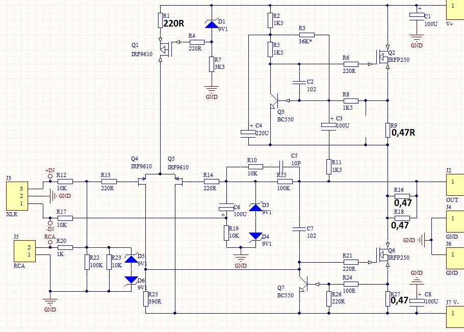

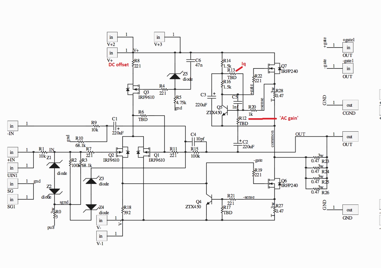

Aleph amps use sense resistor R9 0.47 ohms to fix the quiescent current about 1.27A . Your amp has 0.15 ohms to fix it at 4A. This is the reason of offset which balances the lower stage to much higher current than it is adjusted by the input CCS.
Original circuit.

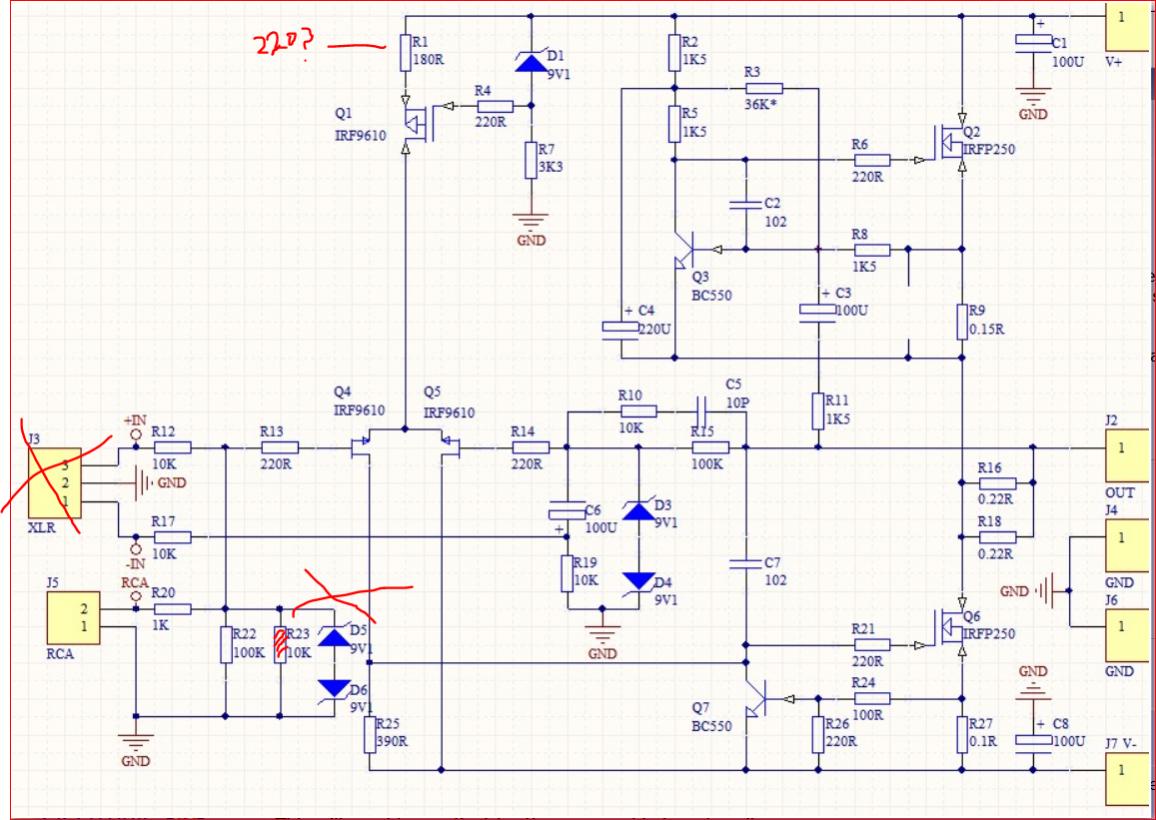

Thank you for your help! Sadly, the schematic is not correct..
I made some corrections on values I measured while fault tracing (might be some errors still).
When I feed it +-14V (desk setup) I have just over 1,5A current. I guess it will be the same current with the 18V supplies too (current seems stable when I vary the voltage a bit).

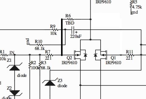

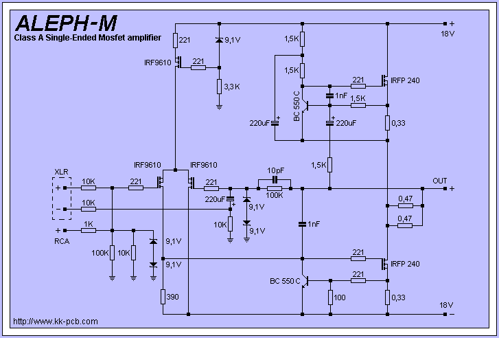

I searched a little bit on Aleph-M(ini) and found another schematic which is not the same but similar. (Mini Aleph, some output problem)

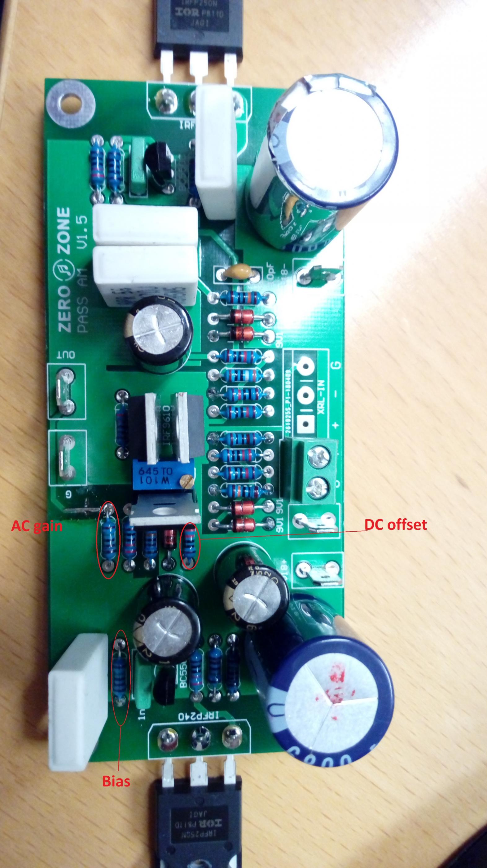

However I guess the adjustment points should be the same for bias, offset and AC gain? A bit curious what R6 is for? Adjusting feedback?
-FOund the answer to that too, DC offset. MOhm-range.

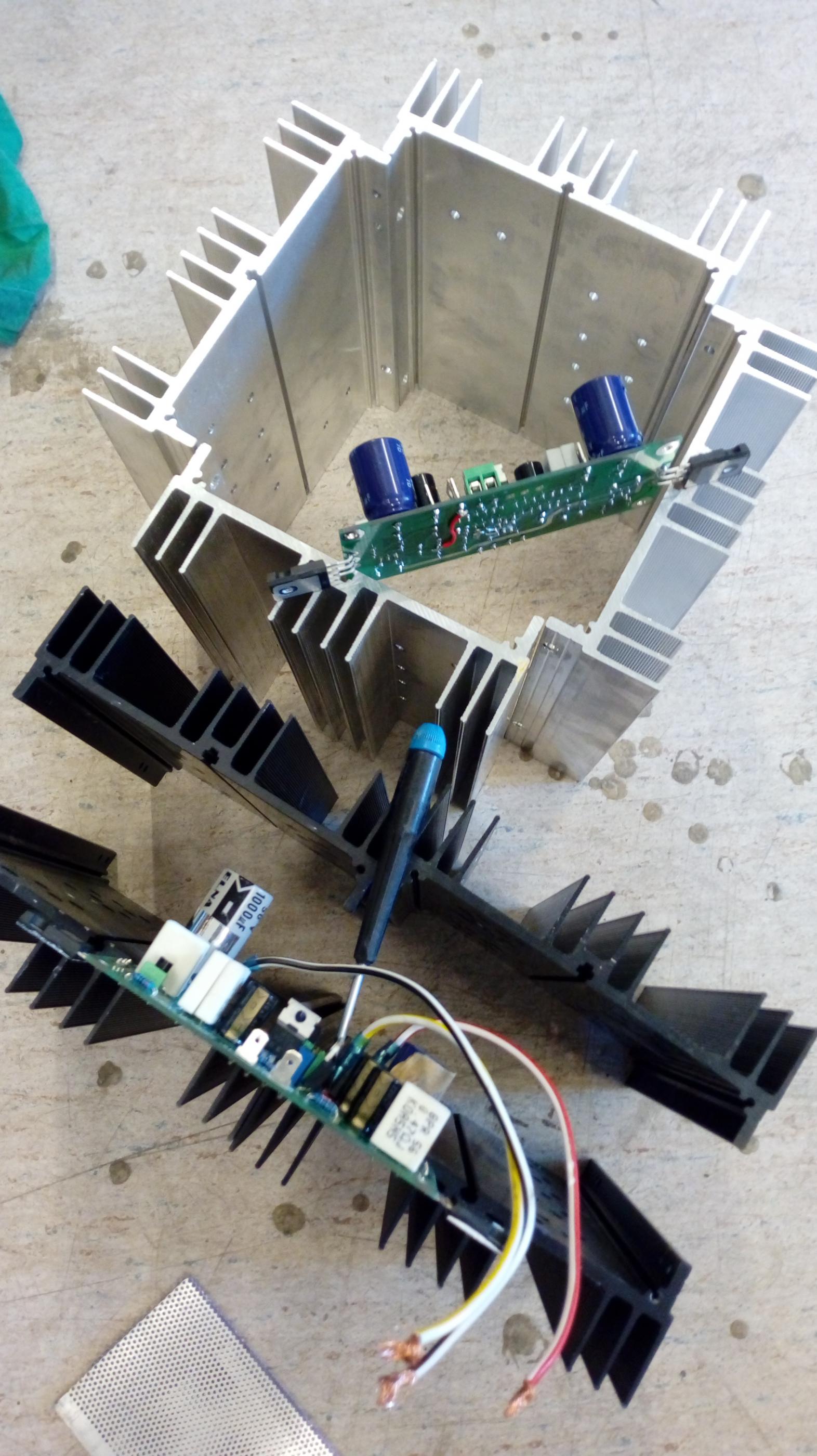

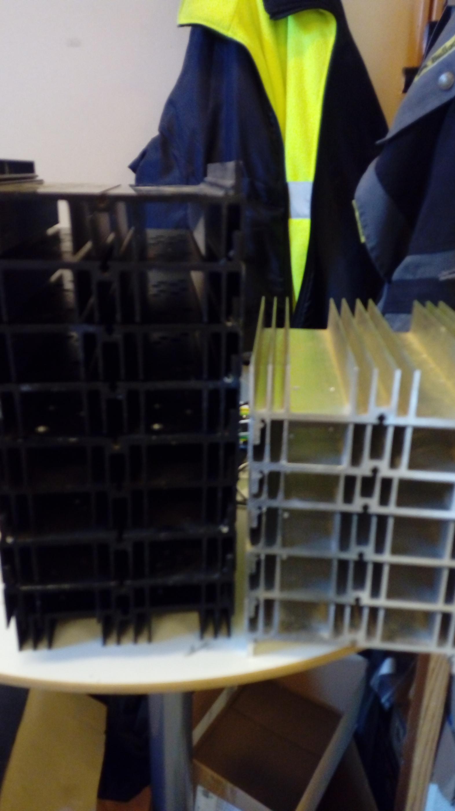

Found some heat sinks in a local scrap yard, I think this should solve the cooling for this and a few other projects 🙂
Trying to figure out the layout, I'm leaning towards the two paralleled-option. Should be easier to access for mods etc, if I can just 'fold up' the two halves with all the connectors and wiring going to the rear. I also want to keep the boards close together to minimize ground loop areas, so I don't want to make a normal box with one amp/heat sink on each side.
I think I will need two heat sinks pet channel (one per fet) to keep temps under control without using a fan.

I moved the 100ohm potentiometer to the input current source in series with a 175ohm resistor (210 to 275ohm), but that hardly did anything.. I have a feeling it would have to be a lot higher (lower current?) I'm not sure how high I could go here until I start affecting performance of the stage..
Adding R6 between S & G on the inverting input fet, as in the latest schematic, seems like an alternative. Should be better than going with resistors to the rails for PSSR I guess?
I have started to build an enclosure for it. To verify cooling, I tested with one heatsink per FET, and they were only 'warm and cosy' after maybe 30min, so there should be margin to play with the bias later.

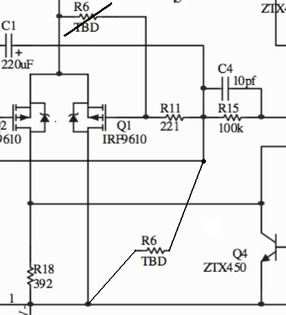

Tried R6 as in the original Aleph schematic, and that made offset worse (more negative), and that makes sense when I think about it since it is the inverting side. So I moved in to the non inverting side, and 700k was not enough. I'm guessing maybe 500k could do it.
Question is if it's bad for the amp performance to put a resistor from current source to the gate of the input fet (non inverting)? Imput impedance will get a little lower, but more?
I'm ignoring the Mohm potetniometer between rails -version, since I can't get one quickly, and would like to assemble the amp in it's new case and test it..
I feel bad about connecting signal path to rails since I imagine it will be bad for PSRR, but maybe that's just me being stupid?
Wrote a lot but was automatically logged out before posting.. I will make a short version:
You could move R6 to the negative side.
I guess 3M3 ... 4M7 will do. With the ~10k impedance there, no need to worry upsetting the cicuit.

Imbalance of LTP
You might need to change the value of R1 which differs from the usual value of 220R used by Pass but leave this until you look at the LTP gate resistor values connecting to ground and theoretical 0 Volts at the output terminal.
The latter represented by R15 is 100k while the former has R22 with 100k having R23 at 10k in parallel. The combined parallel resistance is 9.09k which is a clear mistake. The divider network of R20 at 1k with 9.09k is going to cause significant attenuation of the input signal of around 11%.
My advice is to undo any changes you have already made and go back to square one.
Then try changing R23 from 10k to 100k - It is conceivable a simple mistake was made with so many 10k and 100k components ending up in confusion.
It might be worth knowing the Pass Aleph 3 LTP gate resistors are 22k at the input to ground and 10k feedback connection to the output.

It is not clear whether or not any suggested networks from the gate of Q5 connecting to the supply rails are still in place.
You have measured R1 which is now a trimmer, I suggest you check R25 by measurement too to make sure the value is 390R.
Then measure the voltage drops across R1 and R25 and deduce the level of current flowing through each of these from Ohms law. Also check the voltage at the bottom end of D1 to see this is the +ve rail voltage less 9V.
For the LTP to balance the current flow in R25 should be roughly half of that flowing through R1.

I measured R25, and it is 290ohm.I have no other mods in place except the trimmer for the input current source.
Measurements:
R25:388ohm 5,21V 13mA
Zener: 8,91V
R1: 286ohm 13,47V 47mA
Far from 50/50..
I also tried to swap places on Q4/Q5, and the offset is basically the same (-180mV), so it is definitely the circuit, not fet matching..
I don't understand how the input circuit can be in balance since there is a resistor on only one of them?
Could some imbalance in the output stage also be 'pulling it out of balance'? Just wild guesses..
