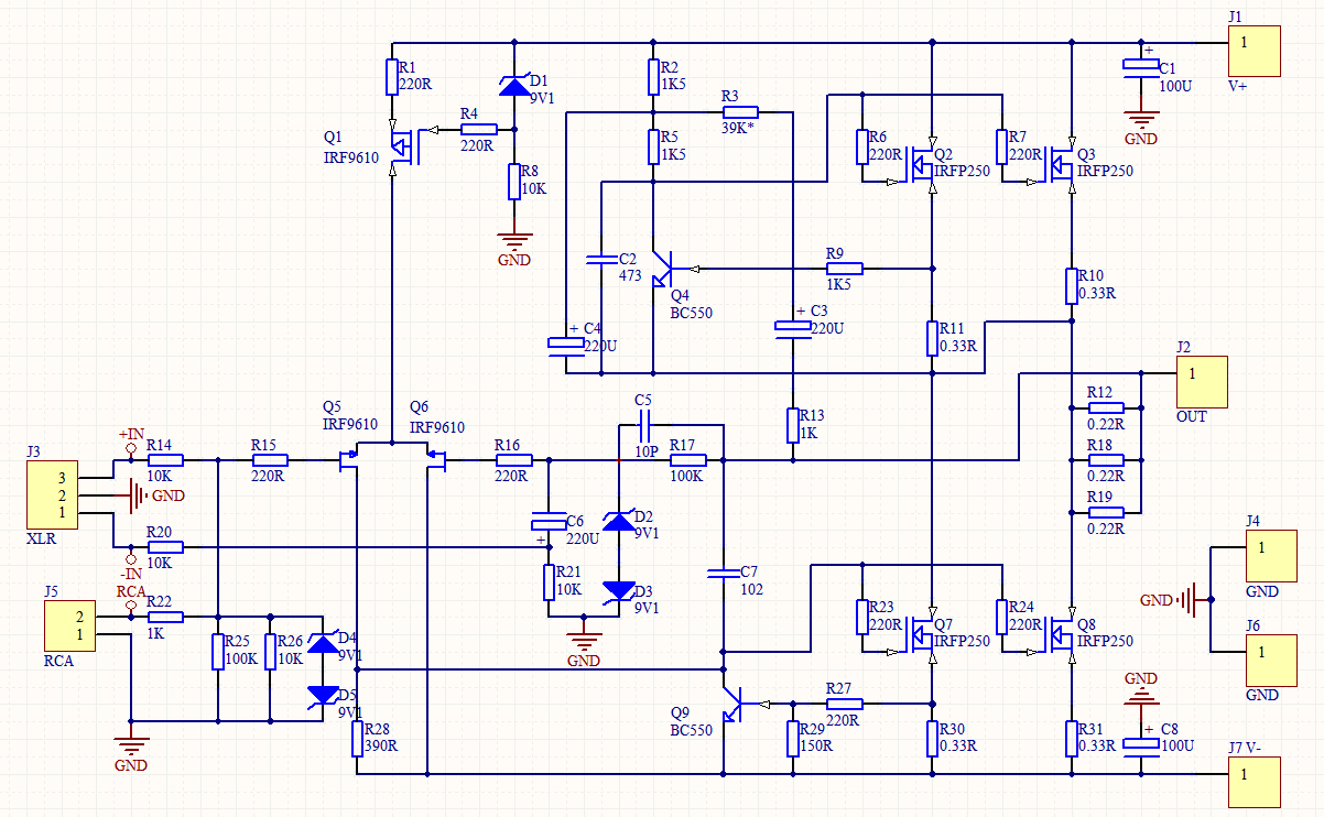

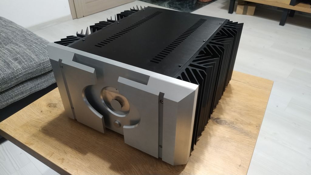

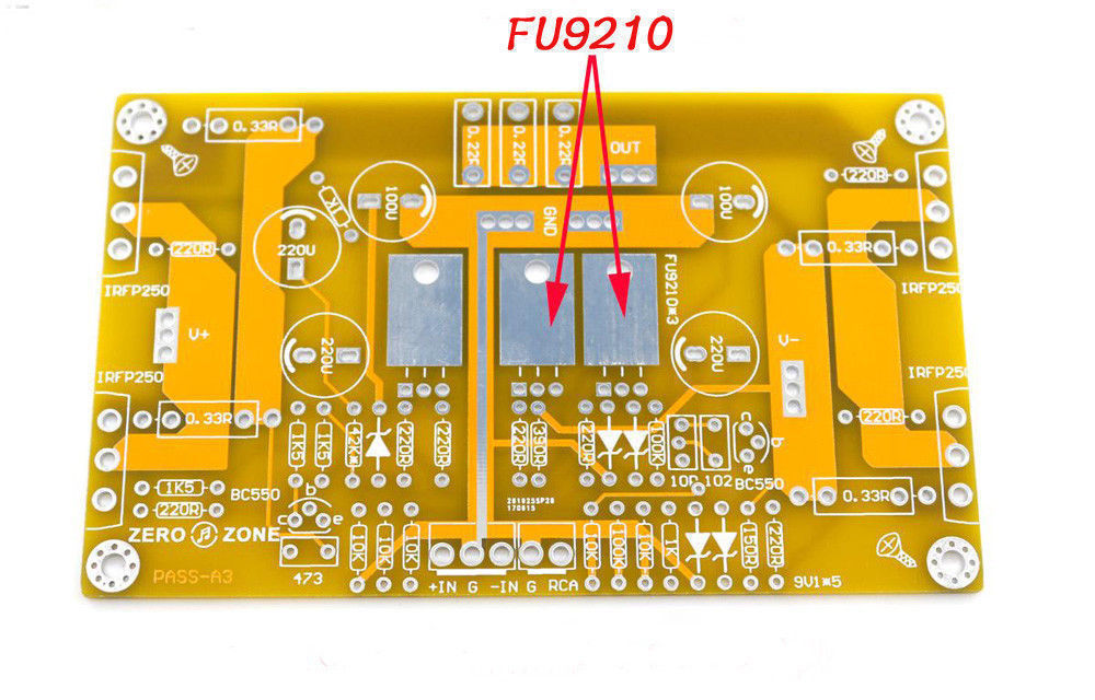

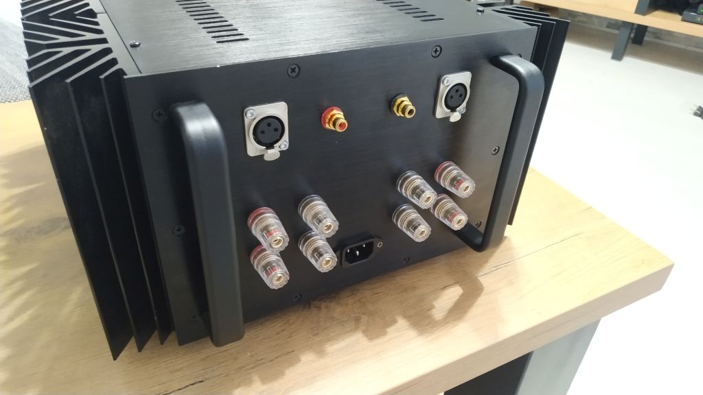

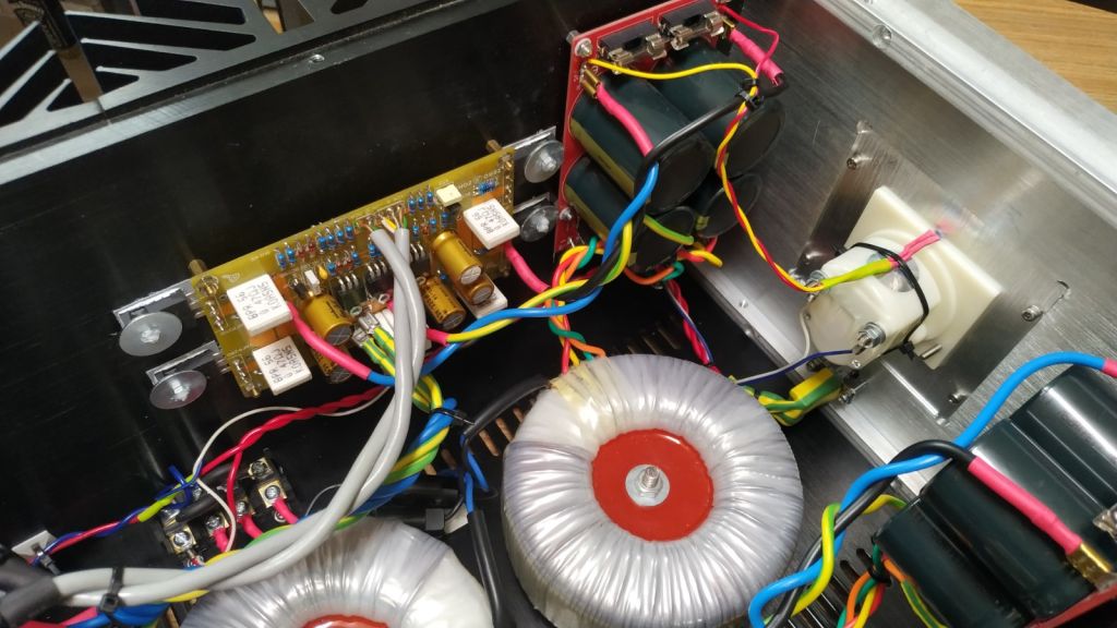

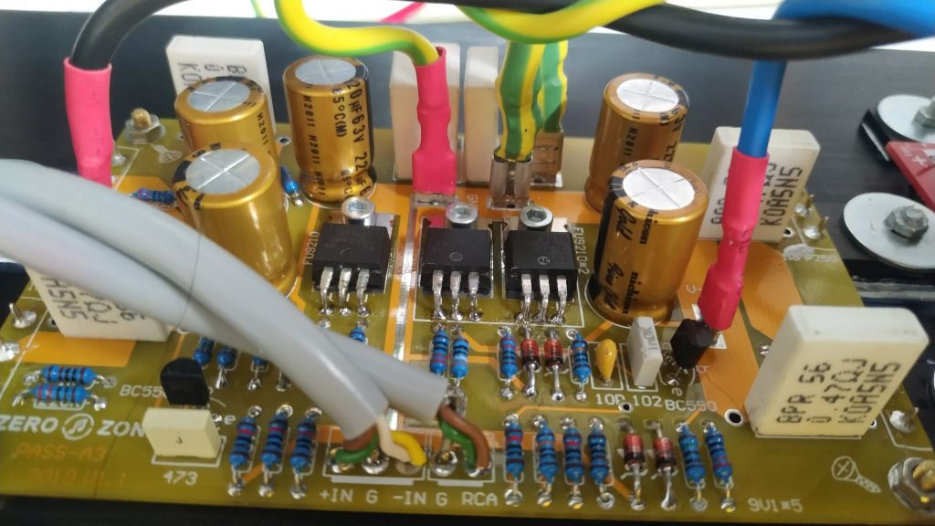

I also bought a pcb from zerozone. Aleph 3. I replaced all the transistors and capacitors.I got FU9210 for IRF9610.I paired IRF 9610 to 5mA.
for example
3,542
3,538
3,540 etc.
Bias 1,2A DC offset less than 20mA.Everything works great
