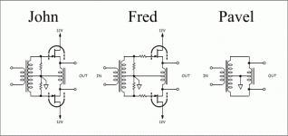

I would probably look at using a standard MOSFET to give a reasonably regulated 11.75 volt supply as the extra couple of volts will make a big difference to the output watts possible.
Note from my VMOS schematic that the gate zeners are reversed in polarity. And here should probably be reduced to 9 volts.
Also don't forget the current capability of the transformer windings, as with these high biases there will be some heating.
One of the problems seems to me to be the package as it isn't overly big for the types of currents and wattages proposed.
I know that it is theoretically capable of 65 watts but once one has derated at higher temperatures e.g 80 degrees C it is only about 30 watts and the package has a thermal resistance junction to case of 1.8 degrees/watt - compared to 0.69 for TO247
But high bias with low voltage is certainly one way to go.
Per STW34NB20 I use 750mA at 34 volts supply in my standard power stage.
Will be interested to hear how this version fairs.

Question on using the FET's: I was planning on using a resistor on each FET source. But what are the pros and cons of a common source resistor on the center tap of the transformer primary? This second method would seem most like the original design, which uses single bias source for both output devices. Using separate bias resistors would seem to make it easier to get balanced output, even if the FET matching is not perfect.
Sheldon
Sheldon
The use of seperate bias ristors will still be tricky as the variations between to make an adjustment will be very small. Sub ohms at an Amp plus!
WIth a single shared resistor there is a virtual ground, which is prefered.
This resistor can be a nice robust wire wound type as it is not moving as part of the AC waveform, and so any inductance doesn't matter.
My VMOS line driver circuit stabilises at 300mA (approx) for the pair between 12 and 24 volts supply variation. (It does go up a little bit as the volts rise, but only a slight change on the meter needle.) This is optimum.

jkeny said:suiraMB,
This sounds excellent - but I'm not a tubes guy - any chance of your take on a schematic?
Just use Susan's regular schematic, but make sure the primary windings of the transformers have enough DC resistance.
Essentially, pick your suppy voltage, then pick an idle current that will keep the device dissipation down to about 10W each. Find the Vgs value that will give you the right current at your supply voltage, and make the transformer so that the primary winding DC resistance multiplied by the idle current gives you that Vgs drop.
In order to cool them properly, I'd recommend the suggestion form someone in another thread, namely putting indium solder on a heatsink, then heating that until the indium solder melts, then using a vice to press the devices against the heatsink until the indium solder cools again. This will give very good heat transfer characteristics.

One approach which will let you bias the devices at high current, while dealing with high supply voltages, at the cost of some added complexity in the PSU is as follows:
Shunt regulated version:
Start off with a regular PSU (CLC, CRC or what-have-you), then feed the transistors through a series resistor that is capable of dropping a large voltage. Put in a P-channel mosfet with its source to the drain of the JFET(s), its gate to the source of the JFET(s) and its drain to the other rail, one for the "push" JFET(s) and one for the "pull" JFETs.
This acts as a shunt regulator, giving a Vds of 2-4V for the JFET. Assuming the P-ch MOS has a Vgs of 3V, you would need a transformer primary DC resistance of 0.2ohm to get 2.5A bias current.
Series regulated version:
Start off with a regular PSU. Follow up with a balanced series voltage regulator, using a 2SK389 or LSK389 (matched 2SK170 or LSK170 will do) Son-of-Zen-like differential stage, and followers on the outputs of the regulator.
Use a polystyrene or mica cap to superimpose the AC waveform on the reference voltage. Make sure the gain is around unity (varying it around unity can cancel some distortion, though, if you have an analyzer).
This approach will dissipate less than the shunt regulator on average, although it does interact more directly with the signal path. It does assure that you will be able to easily select an exact Vds value for the power JFET, though.
To protect the regulator, as well as the output, just add an I/V foldback (or SOA protection) to the regulator. It will not have the same sonic impact there as it would have in the output stage itself.
I could draw up a schematic to explain better, but I don't have any nice CAD software lying about, so it'd be a digital photograph of a sketch on paper.
Of course, both these approaches shift the bulk of the dissipation elsewhere. The series-pass regulator additionally reduces the net dissipation somewhat.
Of course, a properly filtered buck-converter tracking the signal could reduce the dissipation to an insignificant point, although the audio police (who have rarely seen a properly filtered converter, nor one combined with a linear regulator) would probably shoot anyone attempting this.
If you want more power, use the series regulator, make several primary windings (one per power JFET), put one JFET on each primary, and series-couple the secondaries for a very large step-up ratio. As noted, these things can be operated at Vds values from 0.1V and up, and their peak current would allow a fairly massive output if you idle them at lower power (something I understand to work well in this topology).
As noted, a source drop of about -1V at 3V drain-source gives you about 2.5A bias per device, for 7.5W average dissipation. With the mentioned heat sinking tricks, you then have 12.5W to spare, which means you can have very large dynamic peaks without overloading the output devices.
The Sony 2SK60 devices would of course perform better, given their higher dissipation ratings and voltage tolerances, but they are pretty expensive, being out of regular production.
In short, the Lovoltech devices should perform adequately by themselves if you don't need a lot of power, and if you do need a lot of power, you can use a step-up OPT and/or use a PSU regulator to achieve the equivalent of cascode operation, along with paralelling devices. And, unlike MOSFETs, the JFETs work fairly well at lower idle dissipation.

Correct, they can only handle 25V, limiting the rails to 12V. But you can use a step-up output transformer.
With 7mOhm source impedance and the possibility of paralelling several devices (a necessity for high output power, unless you use a fan on the heatsink, as well as the indium-solder trick, in which case I guess you could probably reach 20W dissipation per device), you can use a fairly large step-up ratio.
Note that, while the voltage is limited, the devices can quite easily deal with 100A peaks if their total dissipation is kept within sane limits.
If you need significantly higher dissipation, and have a lot of cash to burn (or a lot of people in a group buy), you could order the devices in chip carrier form (~€2000 minimum), along with some 1200V SIT power JFETs from SemiSouth (~€1000 minimum). SemeLab UK can then package these in a high-dissipation package. This gives you pretty much any voltage rating you might care to use, along with a massive power handling.
Of course, the SemiSouth devices by themselves could probably do the trick. Being silicon-carbide devices, they can operate at whatever temperature the leads can handle (well, up to about 800 deg C).
Wouldn't a step up output transformer raise the output impedence a bit high. I'm assuming something like 0.5-1R for biasing?
suiraMB said:
Correct, JFETs have a more favourable capacitance characteristic. If you want even better high frequency performance, you could try to drive them with an LSK170C buffer at 15mA bias or so.
I believe John Curl also suggested simply adding a polystyrene capacitor to swamp the nonlinear input capacitance to reduce distortion. In this case, 6nF should be enough.
Another interesting idea. My driver has an impedence of abourt 3-4K. To get to about 22Vpp I have to step down about 9:1, which gives me abour 40-50 ohm reflected impedence. Should be able to drive a 10nf cap no problem.
suiraMB said:
You will want to make sure your arrangement does not exceed the Vgs limits (12V, I believe). Not sure this is a real problem, though.
I'll add the protection diodes as shown in Susan's schematic (something less than 12V)
suiraMB said:
Maintain a damping factor of about 25 or so at the driver's resonance frequency. Even midranges need some electrical damping to behave properly.
I'd have a pretty high damping factor at a 2:1 stepdown ratio. Even 1:1 would be fine I think. Or am I intrepreting the bias resistance incorrectly for calculating impedence, as the follower acts more like a current source? I have to think about this one some more.
A step-up OPT raises the impedance of the secondary, yes, which is why you want to wind it for a low secondary resistance. The AC impedance (given a low DC resistance) is negligible, as the LU1014D has 7mOhm Rds(ON) and 20S transconductance. This gives a 57mOhm source impedance for the transformer primary, I think. Although it's 6am here now, so I could be wrong. 🙂
Indeed. Although with modern signal sources you routinely get 2-3Vrms at low impedances, so you could just drop the driver stage and turn your 9:1 around. If your source is higher impedance, a 2SK389V or LSK389C buffer would probably distort less with the same drive capacity.
The damping factor is based on the DC resistance of the secondary, and the reflected AC impedance. Primary DC resistance does not figure into it.
The reflected AC impedance is RdsON + 1/Gm, divided by the turns ratio, and for a 4 ohm driver you need a reflected impedance plus secondary DC resistance of 0.400 ohms or less to maintain a damping factor of 10 or better.
0.057 ohms reflected through a 1:4 step-up would be 0.228 ohms, leaving almost 0.2 ohms for the DC resistance of the secondary.
suiraMB said:Actually, the maximum operating/storage temperature is 150 degrees Celsius, so anything that melts at less than 120 C or so should be fine. In fact, a higher melting point allows you to run the devices hotter without the solder melting 🙂
I'll chase some up.

Watch this version carefully. The separated windings will enable small mismatches between the mosfets to take off and the whole thing will oscillate.
This can be cured by putting low value resistors across the paralleled sources, something like 1 or 2 ohms, on each side.
For my 6C33C tube line driver I used 4R7s but that was with the line transformers not the output ones.
As you correctly identify it is not going to work for the above reasons.
The voice coil will overheat unless you use very low biasing and the inductance will not be enough for full range.
What would work is turning the speaker motor around and using a bifilar coil instead of a permanent magnet and then magnetizing the voice coil with a low(ish) level of DC.
