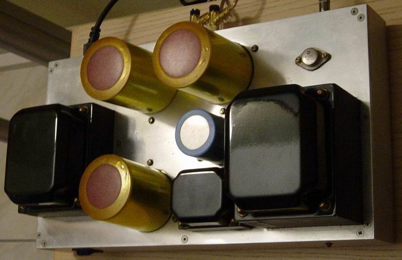

On the other hand, while I am sitting here listening to Norah Jones through my Nemisis monoblocks, I wonder why one would need per channel no less than 2 transformers and two transistors, when half of that would be perfectly adequate...😉
But, Susan, seriously, are you familiar with the Nemesis? Do you hasve an opinion on how your amp would compare to that, soundwise?

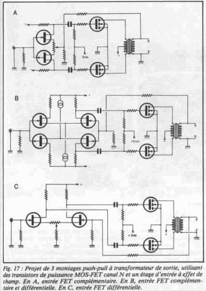

Speaking of single-ended amplifiers, it's worth noting the work of Paris-based Jean Hiraga at L'Audiophile over 10 years ago. He developed a single-ended, transformer-coupled transistor power amplifier called Nemesis, with no other active devices whatsoever other than a single power device (namely a 25SK 135 power FET). The Nemesis's utter simplicity helped it achieve a sound that closely approached that of a classic WE 300B single-ended triode amplifier.—Martin Colloms
Audiophile n°34, janvier 1985
Audiophile n°35, printemps 1985

dimitri said:
http://www.stereophile.com/amplificationreviews/740/index6.html
... which makes interesting reading.
However the Nemesis is a valve design with the power fet instead of a tube, and the gain stage is the FET transfer characteristics, which as Eva has pointed out are a bit shakey.
These single ended designs by their nature have an ASYMETRIC output impedance, which will affect the reproduced sound quality. They can only drive in one direction, the other direction is dictated by the back EMF of the transformer or by the current sink.
Again this is not necessarily good or bad, it's just how it is.
My amplifier uses an impedance gain stage, which does not add any noise. It is literally "wire with gain". To do this voltage amplification I trade off a low impedance input for a high impedance output.

Hi Dimitri,
Thank you for the schematics.
dimitri said:
push-pull projects by J.Hiraga
I note the following.
1. Uses negative feedback.
2. Has capacitors in the audio path.
3. Uses MOSFETs as amplifiers.
Remember that a transformer couples ALL ways, so load effects not only get fed back round on the feedback to the phase splitter, but also directly into the mosfets themselves. Wibble, wobble!
The Hiraga circuits with mosfet amplification in the final stage (without the feedback) in RF power amplifiers can self destruct if fed into a mis-matched load.
In my amplifier design using followers the mosfets have a gain of just below unity. This is a "good thing" in my book.
It is therefor very tolerant of miss matched loads - which is why I was looking to use it as a wide band RF amplifier for driving CDN units for EMC/RFI compliance testing as the resultant load is anything but a nice stable 50 ohms.
Many thanks for the time digging these schematic out for me, these are all of interest even if not the way I am doing things.
Best wishes,
Susan.
