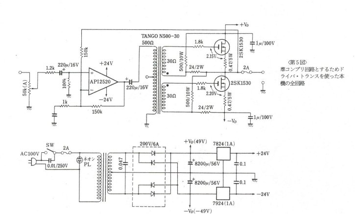

If the sources are in voltage swing, should the gate driver looks like this?
Thanks for the schematic. However...
Nope! I only have a single supply rail so the two halves of the transformer cancel out any supply ripple (whichcan get to over 2 volts in the amp in operation) 10,000 uF caps are cheep, and do not put severe current spikes back onto the mains ac supply - otherwise I would have to do power factor correction.
One supply rail = 1 bridge rectifer, 1 = smoothing cap, and low i.e. below 50 volts DC power running around inside the box. Okay, the output transformer generates the negative power rail, but that is ac and so far less dangerious.
I would also avoid caps - particually electrolytic - in the audio signal path.
