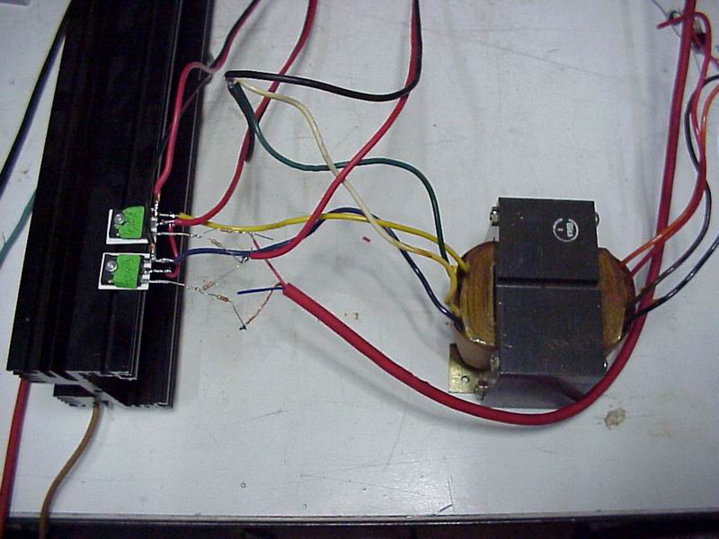

I took what I had at hand and what was lying around and build a very preliminary prototype of the amp.
Missing the input transformer I took bobo1on1’s schematic, two power supplies, one for the 12V, one for the bias voltage.
Power supplies are limited at 30V/3A.
I used an 100V transformer from a peavey amp as output, the headphone output from the cd player as input.
I have no idea what the connections from that transformer are. I’ve got four wires at each side, both sides split.
I connected the power ground to the center tap.
Mosfets are IRFP240, remains from my Aleph-X.
So, one monoblock is working, playing music.
Again, for those who remember, Tori Amos is the lady in charge
There is some hum from ground loops.
As Susan states, an input transformers would probably solve that problem.
I used my headphones and switched between the output of the cd player and the amp’s output to hear the difference.
It’s very hard to tell because the player’s output is stereo, the amp is mono.
So I will not come to any conclusion for now, the thing is just too crappy.
One thing is sure: As long as I keep the bias in control so my second power supplies doesn’t run out of current it seems to have a very smooth and detailed sound.
This is a very nice little amp to build, and because of it’s simplicity has lots of possibilities to test and improve on the very few components.
Thanks again Susan, for such a nice project.
/Hugo 🙂
