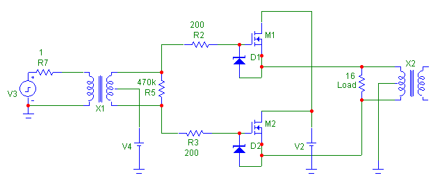

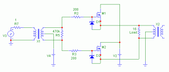

All this talk about fancy output transformers and winding techniques and core materials can be swept away in one stroke...
Earlier in this thread I posted a comment http://www.diyaudio.com/forums/showthread.php?postid=488524#post488524
about a conceptually similar topology to the one we are talking about here, but perhaps some of the finer points of it were overlooked.
In Susan's amp cct, as one mosfet source pulls up, the opposite end of the transformer goes down as a result of the coupling of the two halves of the transformer winding. You can connect a loudspeaker to a secondary winding on this transformer, or if the drive capability of the mosfets is sufficient, connect the speaker from source to source, i.e. across the full transformer primary.
In both situations the audio signal has to pass from one winding, through the core and thence to the other winding and then the load. Depending on how good the transformer, the signal wil suffer certain indignities along the way.
In contrast, the topology I spoke about has the advantage that for a given drive polarity, one end of the load is pulled up by a mosfet source while the opposite end is pushed down with an equal "force" by the negative end of the cross-couping capacitor. The point is, provided it doesn't saturate at the lowest frequency and highest level of interest, the quality of the transformer now matters not one bit. It is relieved of the task of transferring audio. You can wind it yourself (as I in fact did) from an old power transformer bobbin and stack and not have to worry about leakage reactance, stray capacitance, horrible quality iron and whatever else. It will give *very* good results.
I see this topology as a natural extension of Susan's.
... and the more detailed explanation.
I prefer to use secondaries as this allows one to match up against the speaker load, and ensures that in any failure mode - no matter how unlikely (we all make perfect solder joints and never short anything out when probing a circuit after all) full DC cannot be generated across the speaker. One should of course also have a fuse in the supply line - after the smoothing capacitor.
However this is my personal preference, and for higher impedance speakers, i.e. 16 ohms, or headphones the direct connection should work fine.
I do not see it that way, but again this is my personal preference. It is important to use M6 grain orientated steel, not pig iron, but M6 isn't anything special or esoteric as it is a standard (albeit better quality) mains transformer material.
Any measurements for this - distortion versus level and load perhaps.
I of course think my amplifier sounds perfect, but as unlikely as it may be it has been gently pointed out to me that I might just be ever so in error in this supposition 🙂
I see capacitors in the audio path, particularly electrolytics, as a "bad thing". Again this is my personal preference based only on my meager 30 years working in electronics. Compared to the thousands of years total experience represented by the viewers of this list that is less than a grain of sand on a beach (chose a beach that you like to complete this analogy).
I did try a circuit configuration with an additional pair of mosfets to produce a constant voltage to the drains of the main mosfets. I used 12 volt zeners plus poly-something caps so that they followed their mosfet keeping a constant voltage on the drain of the mosfet below.
The constant voltage bit worked very well. It is always gratifying when something works first time - rather than going flash-bang and letting out the magic smoke.
And the results?
No real difference at all to the distortion figures - particularly in consideration of taking the measurements on different days.
You could show me the two figures side by side and the only way to distinguish the two is that the headroom of the amp with the additional constant voltage supply mosfets is reduced by four or so volts (unsurprisingly).
I must have got this wrong somehow as I have been told that supplying a constant voltage to the mosfet drains will liniarise them.
Perhaps there is another factor at work here in which the transformer - for all it ills plays - it's part?
Best wishes,
Susan.

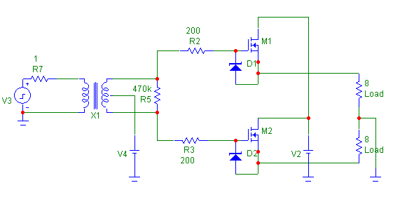

bobo1on1 said:
So I connected the speakers directly to the fets and the problem was fixed.
Like this?
I tried to get rid of the output transformer (same setup as in the picture) but then the mosfets don't turn on because there is no reference to ground. So I didn't omit it but put the speaker across the primary.
I also tried to connect two loads (voice coils) in series between the mosfets with the ground in between the loads.
Would that work in practice?
From the sim all I got is very distorted figures because transformer models are probably completely wrong.
/Hugo 🙂

Hi Hugo,
Netlist said:
Like this?
Nice drawing.
That will work, but see my previous post about impedance matching.
No.
But would probably let the magic smoke out of the speakers.
The two primaries HAVE to be magnetically coupled on the same piece of iron.
/Hugo 🙂

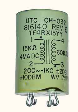

Susan: I connected two more audio transformers, the primary windings in parallel and the secondary windings in series to double the voltage, the amp still distorts at low frequencies but at a slightly higher volume level.
I found out that the distortion sort of shifts up to a higher level when I increase the bias voltage, so there is a good chance the audio transformers are getting saturated.
I am going to rewind the output transformer, but someone thought it was a good idea to weld the laminations together so I can't get them apart.
Do you think think two of these audio transformers wil do the job? the specs are: 15Kohm-60Kohm,200c-1kc size:23-36 mm,audio level:+10dbM.
Does anyone know what kind of value c is?
I've also included a picture.

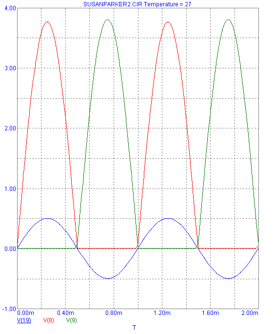

Without transformer:
With a 1kHz sinewave the blue line is the input sinewave,
The red and green are the mosfet sources.
So this is clearly a no-no.
However, the differential offset is only a few millivolts.
See you all tomorrow and thanks for the nice evening 🙂
/Hugo
