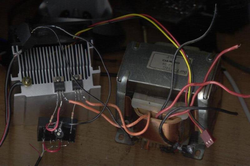

Hi Michael.
Thank you for your question...
I have found that fiddling around with extras doesn't seem to help as it starts getting complicated and swings n' roundabouts kick in.
Matching up a second pair of power devices and the power supply ripple stuff is probably not going to be quite so good. Also it will eat up the power supply headroom, which would then mandate uping the supply volts from circa 35 to 40 plus. Not a problem but then the bias circuit needs a few more components.
However you are most welcome to try and I would be intersted in any sucess, as anything more than a switch and a light bulb is obvioulsy too complicated for an air-head like myself.
If you had a specific circuit configuration in mind, with component values, then I might be able to try it out should I have the time.
I am ordering a set of nice non inductive power resistors so I can get the full power curves as Bear wants to see (pitty there arn't any specs on his triode mosfet amp available - but I am sure it sounds just as good as eva's).
Distortion levels drop BTW as the load impedance increases and even at 16 ohms is very much improved - however that isn't "real world" currents and core fluxes now is it.
I will post as and when I have anything further to add, and update the web pages at some point.

Hi Terry,
You suggest that the multifilar transormer is wideband, but does the standard core not absorb energy above 100kHz, and is this not why ferrite cores were developed ? On the other hand, transformer loss might fortuitously compensate for reducing load current due to loudspeaker driver inductance.
Hi Susan,
I've gone kind of quiet since I saw your figures and 'scope traces.
1.7V @ 4 ohms and 2.7V @ 16 ohms means that most conventional multi-driver cabinets could sound quite different to what the loudspeaker designers intended, especially around crossover frequencies. This output could however sound good with full range drivers which otherwise tend to sound 'forward' with conventional low impedance voltage drive.
Also your distortion figure starts low, increases, and then falls again. Is this due to low output biasing being overcome and currents/flux not varying linearly with input voltage, thus operation is gliding between class-A, then Ab, then aB on a per cycle amplitude basis. And, all of this with varying imbalanced gate capacitance acting upon the input transformer, which will modify the known resonance that Eva outlines.
Distortion might be reduced if the input transformer secondary were more resistively damped but then voltage follower buffered, and the output devices then run in genuine class-A from the low impedance buffer output. This should prevent 600 ohm signal generator (or any source ) waveform from being amplifier modulated as presently occurs due to varying output device/input transformer reactivity.

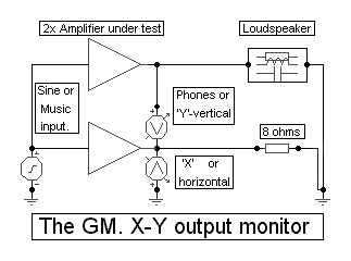

Hi Prosit (Acenovelty)
My article has been published in the Nov 2004 Electronics World, and with it my suggested differential method for examining how amplifier output becomes modified by amplifier performance whilst simultaneously dealing with loudspeaker generated back EMFs. See attachment.
This will give a 'live' indication of amplifier linearity with either sinewave or music drive. Just make sure that your 'scope ground is floating and not connected to the line/mains earth.
Why did I not come up with this before ?, for it has illustrated that many 'normal' measurement derived specifications tell us little about how an amplifier distorts when driving a loudspeaker, whether simulated or real-world.
Phones or a tweeter will be quiet, or a dual-beam scope display will be near horizontal to within a few millivolts at 10kHz for a good (class-A) amplifier, but 100s of mV oval with a too reactive output stage, spiky with output stage crossover distortion and all over the place in different ways that are understandable if internal path capacitance/bias/drive currents are overcome when the NFB loop attempts to maintain output voltage irrespectively of dynamically phase shifted loudspeaker current flow.
I have used this arrangement to simulate many designs, and observed weaknesses that designers are not aware arise.
There is much more in the magazine text, including some representative differential error traces, but it really is EW copyright.
Susan, your amplifier does not have NFB, but does it sound 'good' when compared to earlier amplifiers because it does not introduce NFB induced distortion affectations that are avoidable in better designs ?
Cheers for now ............ Graham.

Graham's comments dovetail with where I was headed when I asked you to check where your operating points are (I think your wrote ~300ma per device) re: the class of operation...
And Susan, you don't need non-inductive resistors to test at 1kHz! Everything will be quite close enough at 1kHz. for these tests - we don't need several decimal places to determine the general power transfer curve vs. load impedance! 😉
Graham, Your differential test is quite nice... I think that it is similar to a technique that has been around for quite some time. Regardless, it is a very nice way to check the differences between a amp driving a load and a resistor...
Actually, if you used simply a two channel scope with one channel inverted, you'd see the difference signal...
Meethinks one has best to do the first test with identical dummy loads first, since there may be interchannel diffs either due to bias, DC offset and/or outright problems?

I just built this circuit with some components I had laying around, I used a 230 to 2x 36 volt power transformer at the output, I tested it on my JVC amp and I didn't really notice a change in sound, its probably not perfect but it works.
The fets are IRF511 and for the input I used two 600 ohm audio transformers, the power supply is al 120 VA torodial transformer with a 16 volt 55000 uF capacitor.
I can't turn up the volume high right now to test it, but it does have a distinctive sound, it may sound like a tube amplifier but I never heard one of them so I can't really say.
I took a picture with my scanner.

Surely we are all pleased to hear from you that "No one is attacking Susan's idea or design. I surely am not." 🙄
My thanks to Graham Maynard whose "article has been published in the Nov 2004 Electronics World" at least gives one a place to look for an answer to my original question posed to you, Bear. Now if we could get Graham to tell us all how to acquire a copy. His attachment whets the appetite for more.
I for one have already placed my call to http://www.thomas-skinner.com/single_phase.htm
about ordering the tranny. Think of it, an amp with what?, only nine parts! 😎 Enough scakety yak, I'm more interested in building and listening to "Susan's little amp design as-is" than testing it into the ground. The ears will tell me if it sounds good enough.
Prosit
