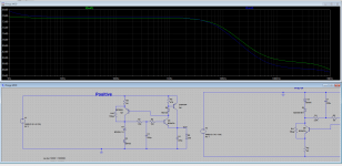

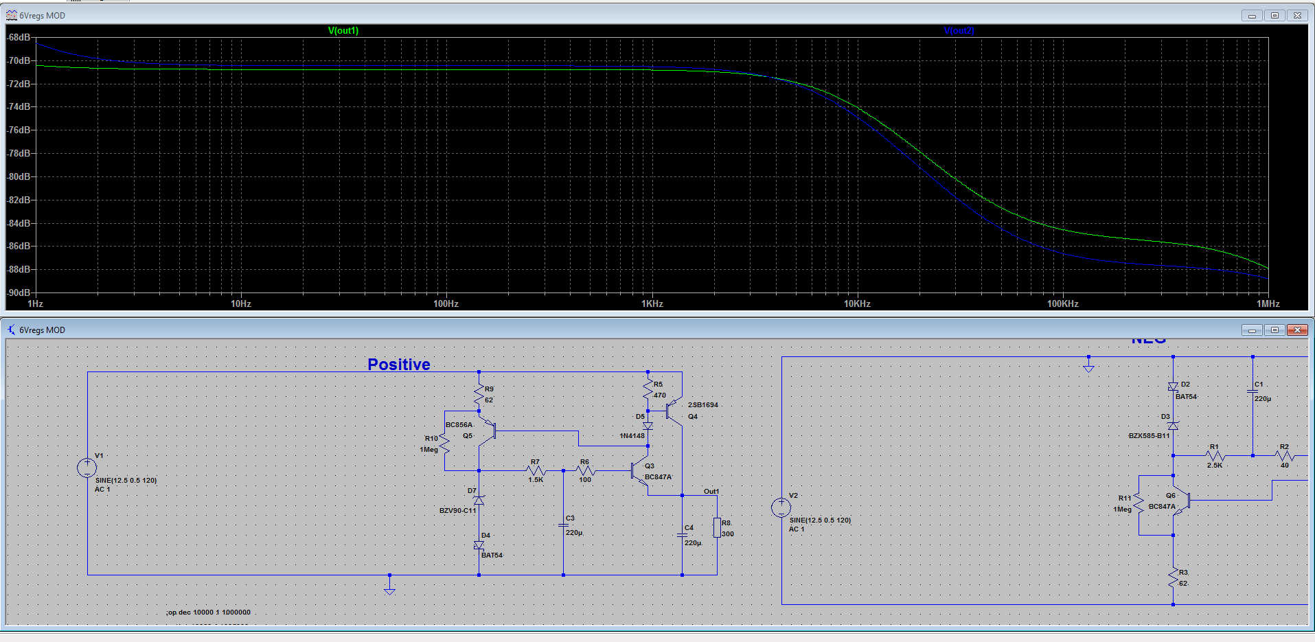

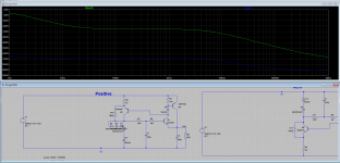

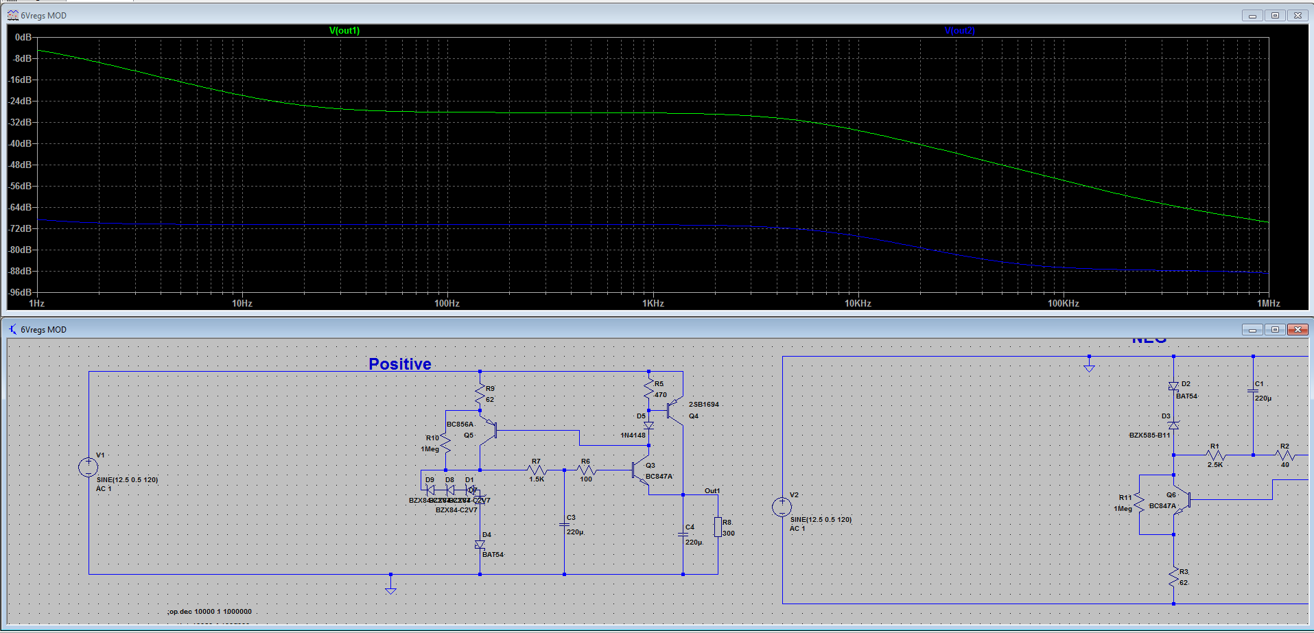

Zener+Voltage follower
Here is the sim with BZX585-C11 and 4x BZX84 c2v7 in serties.
