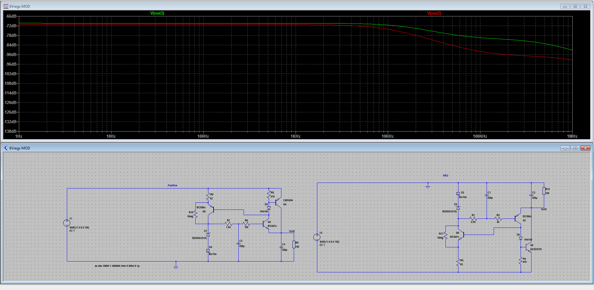

post94 has changed from two isolated supplies to a centre tapped supply.Gotcha,LM2941.Do I need a positive and Negative regulator for bipolar supply?
For this centre tapped supply you must use two opposite polarity regulators.
The previous post87 shows isolated supplies. That has the option to use either +ve, or -ve, or both polarities of regulators.

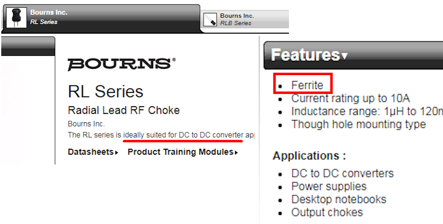

I repeat: this is a ferrite core inductor. It is NOT an air core inductor.
Nevertheless, the manufacturer says it is ideally suited for DC to DC converter applications, where (as in linear power supply applications) the inductor current includes a very large DC component. See Figure 1 below.

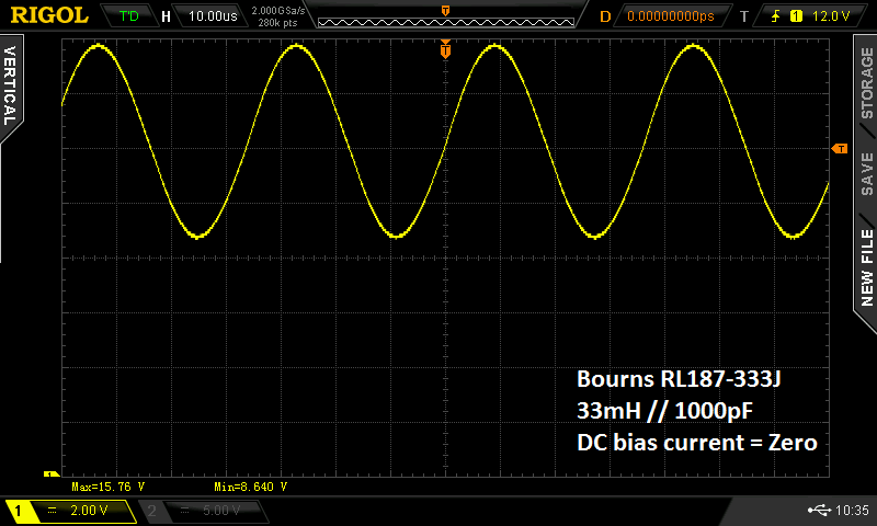

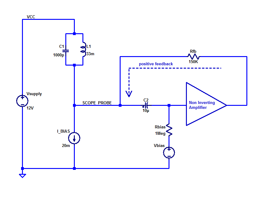

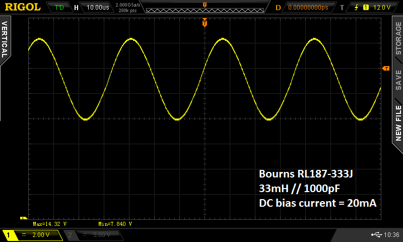

I built a little test setup to see whether this inductor misbehaves when carrying a DC current equal to (2/3rds) of its max rated current: 20mA out of a 30mA spec. My setup is shown in Figure 2. The inductor L1 forms a resonant "tank" circuit with capacitor C1; the resonant frequency is 1/sqrt(LC) = 174 kradians/sec (i.e. 27.7 kHz).
Then I measured it twice: first with the 20mA current source "I_BIAS" not connected, and then second with "I_BIAS" connected and pulling 20mA of DC current through the inductor.
Results are shown in Figures 3 and 4 below.
We see that the resonant frequency did not change at all; therefore the inductance did not change at all. Whether carrying zero DC current, or (2/3rds of max rated current), the inductance remained rock steady.
For the curious: the current source was a bog-standard circuit using two 2N5551 NPN transistors and two resistors. Current equals VBE/Remitter and I used Remitter=33 ohms to get 20mA.
For the curious: the amplifier was a cascade of two CMOS logic gate inverters, from the CD4049UB integrated circuit. It runs quite happily on a 12V single ended supply.
edit: for the very curious: See whether you can figure out the DC resistance of the inductor by studying Figures 3 and 4. The inductor's datasheet guarantees that DC resistance will always be 80 ohms or less; but what is the actual resistance of this particular unit?

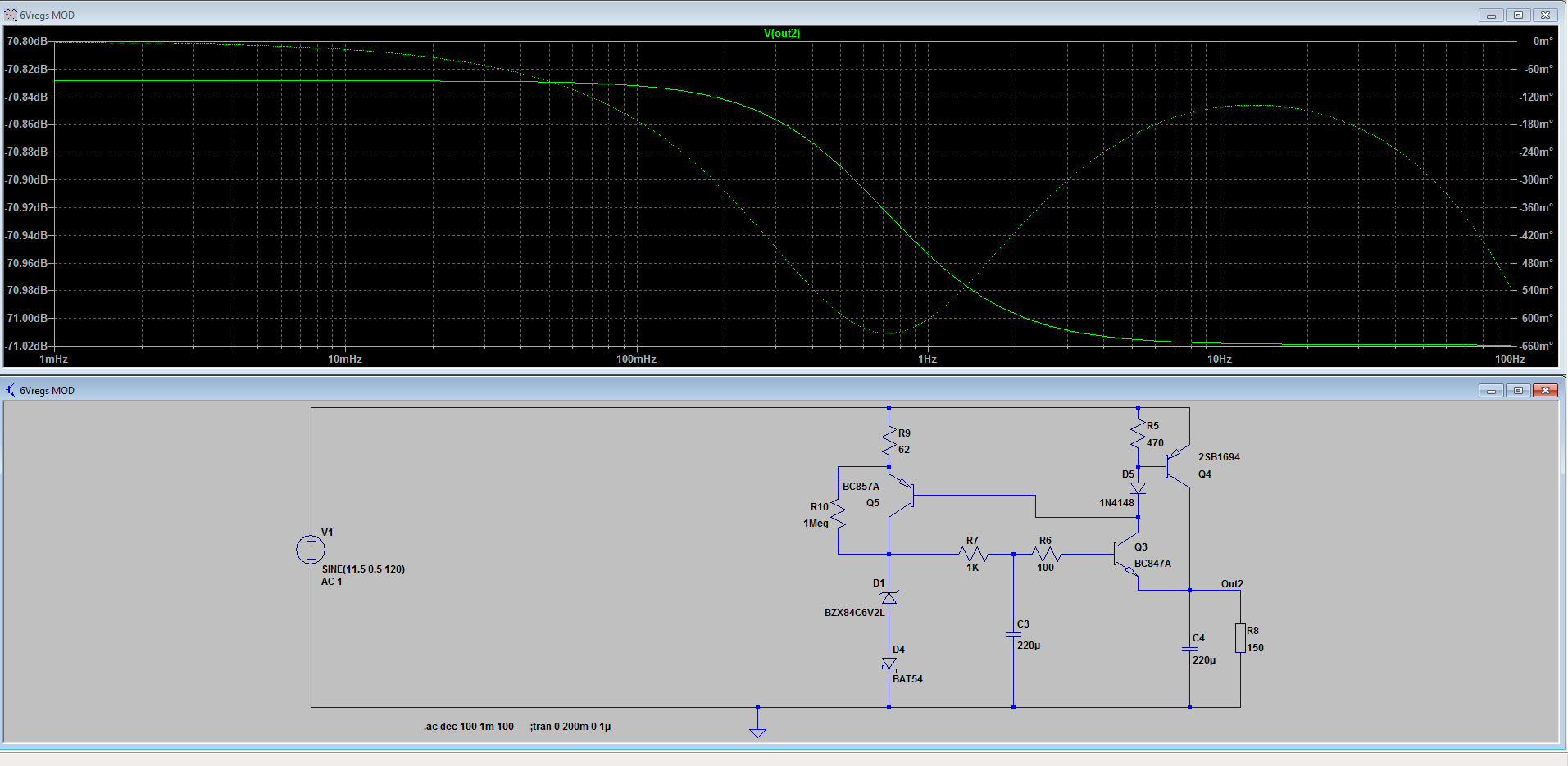

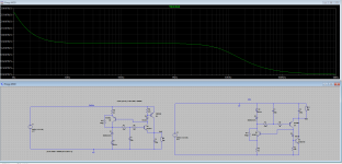

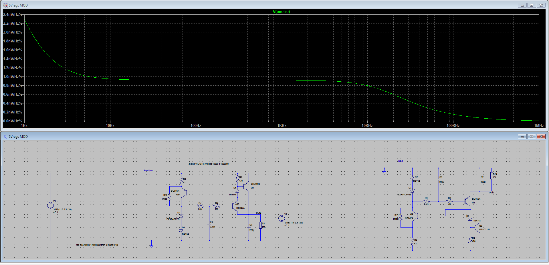

Wondering why the scale in this plot is only up to 100Hz ,should it not be upto 100Khz?To improve the line regulation, you can use this simplistic fix: just replace the jFET CCS with a banal BJT CCS, and you gain 40dB of static line regulation.
The higher frequency behavior remains unchanged because ultimately it is dictated by the Early effect of the transistors.
Note that this mod will also greatly improve the load regulation.
R10 is required to make the circuit start by itself, but it degrades the performances only very slightly

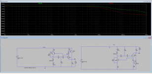

I was playing with your spice file Elvee, adding different transistors. It look better than original configuration to me. Is the attenuation =PSRR?
Because at the time, you asked for a way to improve the line regulation, meaning frequencies close to DC.Wondering why the scale in this plot is only up to 100Hz ,should it not be upto 100Khz?
You can extend the plot to 100KHz, the changes should be minor.
Only at much higher frequencies will secondary effects appear.
Yes. It looks better, probably because the Early effect of your transistors is improved, to the extent that it even "drowns" the increase at VLF seen with mine.I was playing with your spice file Elvee, adding different transistors. It look better than original configuration to me. Is the attenuation =PSRR?
It is also due to the fact that the compensation of Q4 wrt. the other components is less favorable, leading to a diminished cancellation.
It is unimportant anyway, because it will remain better than with the jFET CCS

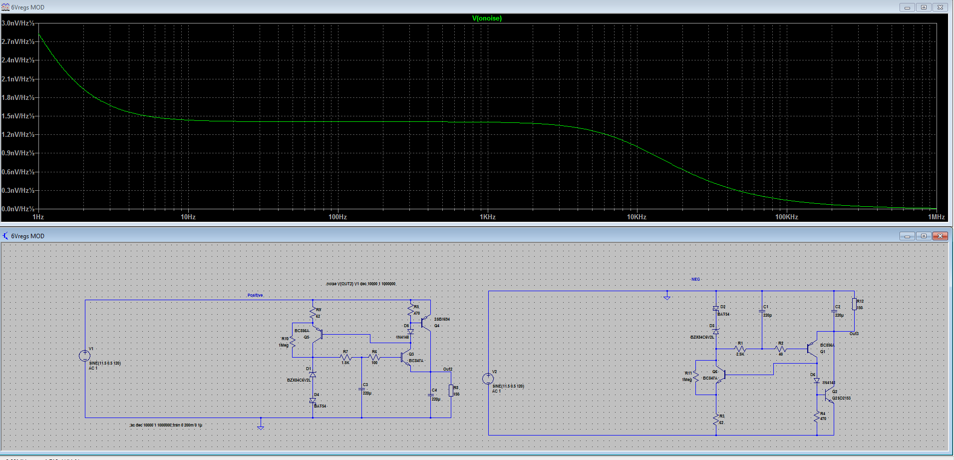

measurements
with both positive and negative supply PSRR. Negative supply PSRR is matching the TPS7A33. Is it accurate?
And noise figures if I am calculating right is better too in nV vs uV?is it real
