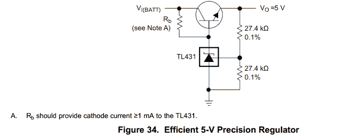

The TL431 integrated circuit was invented to simplify the function you want to implement. For +/- output two positive sections with floating input circuits and series outputs can be used.
Interesting EVA. Do you know the. Noise measurements? Also please explain the part if possible with a schematic -two positive section with floating input circuit and series output.

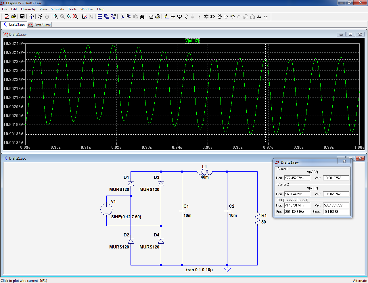

Hmmm, the power transformer's secondary provides 9V AC. This feeds a full bridge rectifier, followed by CLC filter: 10,000uF + 40mH + 10,000uF. Finally the voltage regulator circuit gives a regulated 6.0V DC output.
Input to the bridge is 9V RMS which is 12.7V peak. After two diode drops in the bridge, 11.2V peak. Making a pessimistic overestimation of the load current (200mA), ripple at the output of the CLC filter is 0.2V. Namely, a triangle wave that ripples between 11.0V and 11.2V at 120Hz (USA) or 100Hz (EUR).

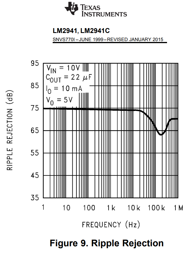

If you insist upon, let's just say, 0.1 microvolts of ripple at the output of the voltage regulator, then its attenuation at 120 Hz needs to be 1E-7/2E-1 = 5E-7 = -126 dB. That's going to be impossible without negative feedback, and damned difficult with NFB. I suggest using a cascade of two low dropout voltage regulator ICs, since they have -75 dB of attenuation at 120 Hz (figure attached). Then a capacitance multiplier (post #1 without the zener) with extremely heavy filtering of the base node, to reduce noise as low as possible. You are making a trade-off, whether you realize it or not: lower noise (cap multiplier) in exchange for higher output impedance (open loop emitter follower). Since you have not mentioned output impedance even once, I conclude it isn't very important to you.

This estimation looks very overpessimistic:Making a pessimistic overestimation of the load current (200mA), ripple at the output of the CLC filter is 0.2V.
With >200mA output current, the ripple looks more like 500µV pp at the output of the filter, or 180µV rms, which relieves the budget of ~56dB

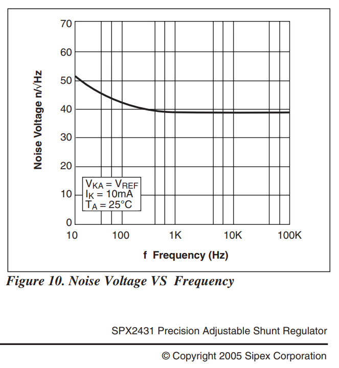

Noise is not worse than a zener, TI datsheet shows 120nV/sqrt(Hz). The reduced part count will take some engineering, no one else can do this for you, or just pay the penalty of high part count.
Some real parameters will indeed degrade the situation, and other will improve it.Rprimary > 0
Rsecondary > 0
Rfuse > 0
ESR > 0
Inductor_Rseries > 0
Basically, it doesn't change the magnitude order:
The raw TL431 will probably have a lower noise than a raw zener, but here, the zener is heavily filtered, which matters a lot.Noise is not worse than a zener, TI datsheet shows 120nV/sqrt(Hz). The reduced part count will take some engineering, no one else can do this for you, or just pay the penalty of high part count.
If you want to do the same with the 431, you cannot use it anymore in a GNFB context (at least without severe restrictions)
Sipex makes an extremely low-noise version of the TL431 that is pin compatible with the TI device. Even so, with the bandwidth you're likely to get from your voltage regulator, the noise of a GNFB circuit like post#41 will be 100X to 1000X higher than a super heavily filtered zener used as a VREF element.
