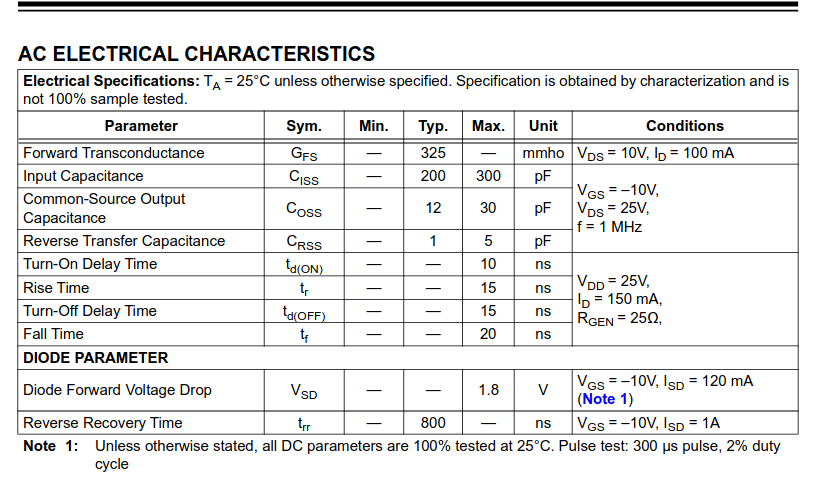

hoping that smaller ones are having slightly lesser interelectrode capacitances than bigger ones
compare DN2530, 2535 and 2540, choose one with smaller cap. figures
How much load is the buffer expected to drive?
DN2540N5 datasheet (https://www.mouser.co.uk/datasheet/2/268/DN2540_Vertical_DMOS_FET_Data_Sheet_DS20006717-3441789.pdf):
