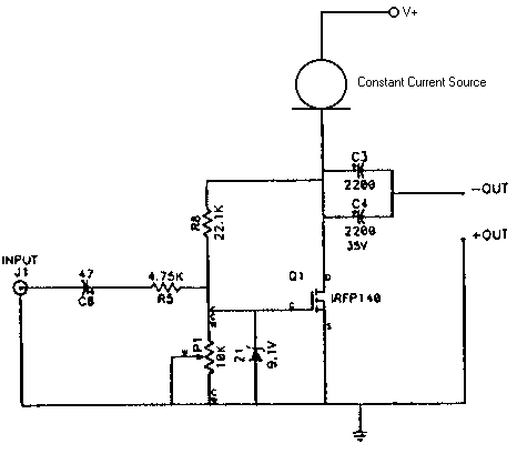

Hello all,
in the original zen amp, p1 and r8 (take a look at the picture) form the feedback loop.
what would happen if i take them out. could i damage my speakers?
i suppose that the amp will have less power (how much?, one or two watt?), much more distortion and probably no damping factor anymore. what else can i expect?
after all, it's not much work to take out both parts, so if i can't damage my speakers, i think i will give it a try. i use the amp for my jbl 2446 horn drivers, so power is not a problem.

The 2 parts you want to remove also set the bias for the FET.
How will you bias the FET to set the idle current?
You could move the top of r8 up to the + power rail and increase it's value. The problem is that now the bias will drift with temp. Not only is the feed back for the signal but the bias as well.
BZ
It works fine, if you want a current source.
The way to go on this is to make P1 and P8 very high values,
greater than 200 Kohm or so, and use a smaller (film) input
capacitor. This will allow some feedback for DC biasing, but
will not allow significant feedback for AC purposes, as the
impedance of the signal source will be very small compared to
those values. You now have a high gain current source. To
lower the gain into, say 8 ohms, I suggest a resistance value
on the Source of Q1 about .5 to 1 ohms (power resistor) which
will lower the gain to a more suitable number.

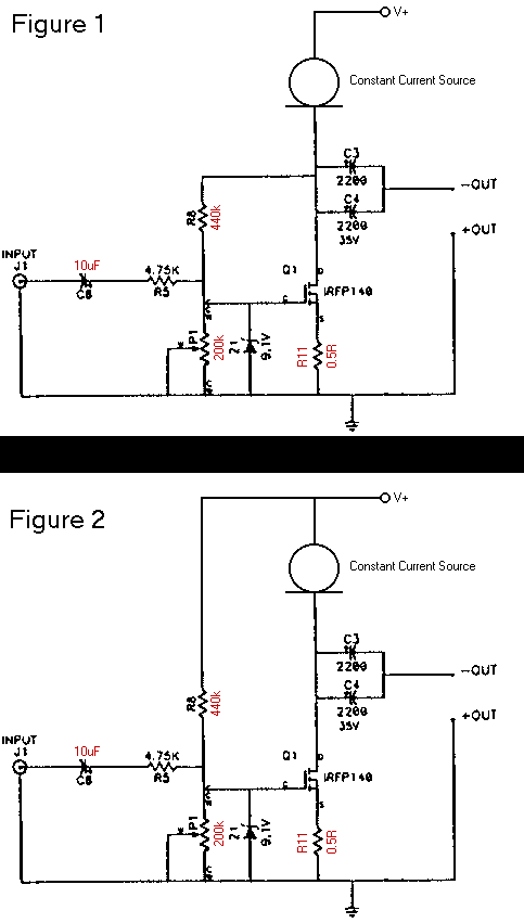

Connect the R-8 to the supplyline (+) and add a 0,47 to 1 ohm power resistor between FET-source and ground. That way you will have resonable gain and lower distortion and very high output impedance. I have treid this and it sounded very nice. The dampingfactor of the amp was very low.
hello,
thanks everyone for your quick reply.
so:
1) deacreasing the input cap,
2) increasing p1 and r8 and
3) adding a source-resistor.
if i do this, the new schematic looks like figure 1 in the picture below.
i am note sure about "moving the top of r8 up to the + power rail".
if i do the things above and 'move r8 to the + power rail', the new schematic looks like figure 2 in the picture below.
what's correct?

Hmm..I'd also be interested to know which one works better.
Fortunately, there are not many permutations🙂
If you try both, let us know which one you chose.
Unless the Master uncovers the truth...😀

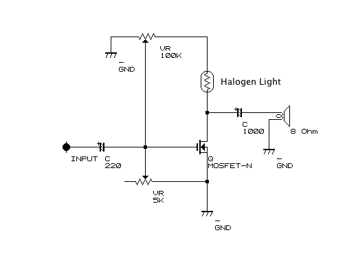

Here's a little variation on the Zen Lite that I throw together on a bread board when i want some music and no working amplifier is close. I have a 300W halogen bulb (used in utility lights) that has two wires soldered onto the ends of the tubular bulb. I just keep it in my parts boxs. Was a bear to solder the wires in place due to the ceramic ends of the bulbs being like little heat sinks🙄
Might be a little unorthodox, but I've always liked this little amp. Usually powered from +20V:

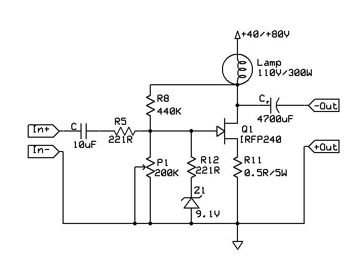

Hi!
Do we speak about something like the attached schematic?
Am I understand everyting well? If it is realy working than it is realy an amazing circuit!

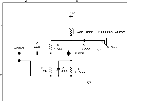

Going out to my work bench I found some Mosfets that I thought were blown. I tested them with a DMM and they apeared to be Okay. Well, I figured I better test them a little better so why not with a variation of the circuit being described here. So, I loaded up the bread board and began tinkering... BTW all the mosfets that showed to be alright with the DMM in fact worked. I had 3 2sj352s and one 2sk1529. I started with the 2sk1529 and wasn't all that thrilled with the sound so I switched to the 2sj352s. These sounded much better with this type of circuit. The finalized Schematic is attached. Note that these are P types, so it is a negative supply of about -24V and the polarity of the capacitors is reversed. I also added a source bypass capacitor which increased the gain ever so slightly (much like it does with a tube). I like the sound of this little amp and may actually build up a real one.
