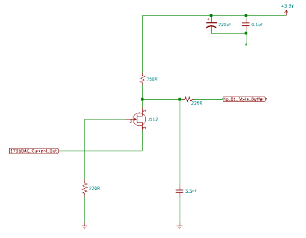

I am still trying to figure how to bias a single-ended common-gate device through the dac directly, this is what I came up with (please don't laugh if it is completely wrong). Would this work?
As a simplified topology it is workable. Presumes that the DAC biases the Fet
as desired, but you can supplement that if needed, Probably want to have a
resistor in series with the Gate and output to suppress parasitic oscillation.
Thanks Papa! I am honored to get a reply directly from the one and only 🙂
Again, my knowledge on circuit design is too limited to know how to complete the circuit. I have added the resistors in series as suggested, and also some power supply filter that I see featured in D1 and other circuits. Is this good enough for actual implementation?

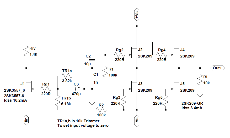

The idea is very clever, I like that.
But you want to have 0V DC and a low impedance at the DAC current output.
That means that you have to use a high-transconductance JFET, such as 2SK3557-6.
Those, unfortunately, have Idss much higher than 3.5mA.
That also means that you need an adjustable negative gate voltage to set input to 0V.
And even then, the Yfs at 3.5mA is somewhat low, equivalent to ~60R input impedance.
But performance is great.
Only thing to criticise, if any, is the poor PSRR to the top rail.
And the need of a coupling cap.
But that can be solved using a current mirror.
This is how I would do it in practice.
The Zip file contains Spice files ready to run.
Very nice performance in sim.
Patrick

Wow. That is nothing short of amazing! Thanks a ton Patrick. It will probably take me ages to arrive at that if I were to learn to do it step by step! I would need to study it carefully to understand how it works though 🙂 . Also a follow up question on the Vs: what would be the recommended rail voltage: would +-18V be OK?

As for the fact finding about PCM1796, from what I found, it seems that most people agree that it is sinking current rather than sourcing current. https://electronics.stackexchange.com/questions/189998/direction-of-dac-output-current. As mentioned by the guys in this forum, and as stated in the datasheet, the center current is -3.5mA, and the negative sign indicates the direction of the current flow i.e. into the current output pin rather than out from it. With that information, I would probably start on a bread board with the current sink version and see whether it works correctly with the dac.
To confirm it before connecting, I guess I could connect the positive output pin in series with a 100 ohm resistor to ground and check the voltage, and if it is negative, then I can be sure that the chip is sinking current, am I right?
Also, regarding the 10k trimpot adjustment, I would have to complete the adjustment of the negative gate voltage and get a 0V at the input, power down and then connect the dac chip, right?
and if it is negative, then the chip is sinking current
Yes. But I would bet it is positive.
Yes, but you need to provide a constant current of 3.5mA to emulate the DAC output DC current (whether sourcing or sinking).
And the rail voltage has to be regulated or your DC adjustment will drift.
And you need to readjust once the chip is connected, because it might not source or sink exactly 3.5mA.
Success,
Patrick
