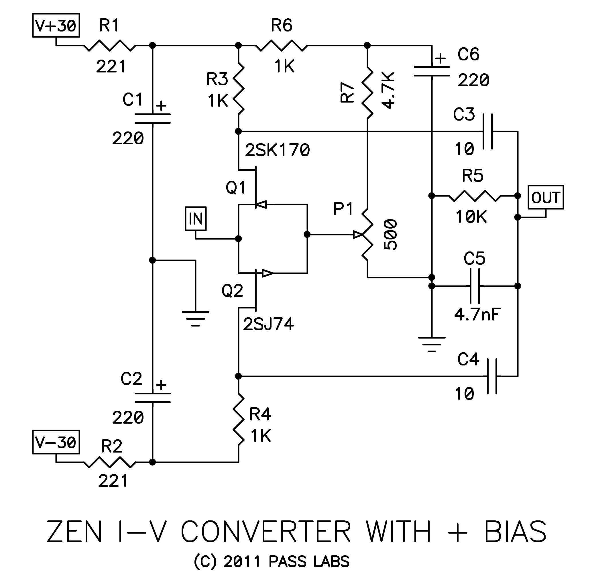

Mr. Full Range asked me about a circuit to bias the Source Pins to
1.65V DC to work with his ESS Saber DAC, so I provided this
circuit:
Great, thanks! Very elegant and simple. I do have two questions you might be able to help me with.
1. Would it be an improvement to have a capacitor on the "wiper" pin to gnd?
2. Could the jfet gates be connected to the reference pin on the dac chip instead of the pot? (I don't know the ESS that well, but many TI chips have a reference pin)
1. Would it be an improvement to have a capacitor on the "wiper" pin to gnd? 2. Could the jfet gates be connected to the reference pin on the dac chip instead of the pot? (I don't know the ESS that well, but many TI chips have a reference pin)
1) You would likely want some resistance in series with such a cap to
prevent parasitic oscillation, so you can just use the pot for that.
2) If you want the Sources to be at the voltage of the reference pin, and
the fets are adequately matched, don't see any reason you couldn't.
Keep in mind that the reference pin may or may not be as quiet as you
want, so RC filtering might be appropriate.
