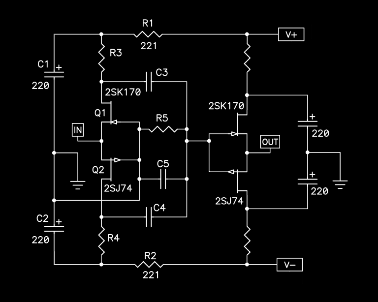

Buffer added
I´m getting some well matched jfets from Woody (thx man!), so this is what I´ll build... this should be nice!😛
-Alex
-Alex
Let´s see...
Starting with the schematic above, considering 1mA peak current from AD186x, I select drain resistors of 3.3K and have an output of (3.3K/2)*1m = 1.65V peak = 1.17V rms.
Using matched fets at 10mA idss, the supply rails have to be at least: 15+((3300+221)*10m) = 50.2V.
The drain resistors for the buffer can be 3.3K as well.
R5 will go up to 680K, so the coupling cap can be 0.1 uF. This makes a high-pass at 1/(2*3.1415*680K*0.1u) = 2.34 Hz (-3db).
There´s plenty of places to put LPF. The buffer can be configured as sallen-key LP. This is TBD by measurements and listening.
Looks good?😎
-Alex

I usually go for a factor of 10, for low thermal noise.
Ans standard CD output is actually 2Vrms, if I am not wrong.
So you should really use 5.6k. Which means even higher power.
Patrick
Patrick
Yes, I´m thinking about that. I might use one paralleled AD1865 per channel, as I can do that in my dac. I would have 2mA peak or 4mA peak-peak.😎
As for balanced operation, I´m not interested right now, adds too many parts.
-Alex
-Alex
Not ok?
Yes, 1mA might be better, since we only have 10mA bias.
Or I might use two fets in parallel. Then the supply would have to go real high.
-Alex
-Alex
The first idea was good already, output of 1.17 V rms is ok for me. My speakers are 88 dB sensitive, my inverting LM3886 is set to a gain of 20.
I´ll also change the buffer on my amp to jfet.
-Alex
-Alex

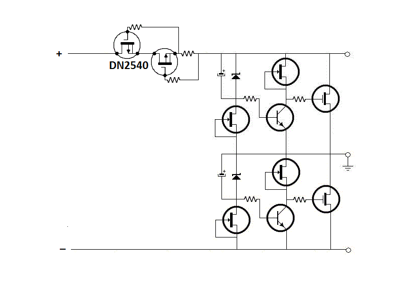

This is an idea for the supply, most of it taken from Shunt Regulation Part 2 - diyAudio
Single secondary, lots of R and C, cascode CCS with depletion mode mosfet, and the ground is set by the shunt regs. One supply for both channels.
What do you think Patrick?
-Alex
-Alex
With 10mA bias, I would just buy a bunch of 9V batteries, a pair of inductors, and 2 good caps, get the circuit to work, and then worry about the actual power supply later. Maybe you would want to stick to battery in the end.
Patrick
Patrick
Good idea, I might do that for testing.
