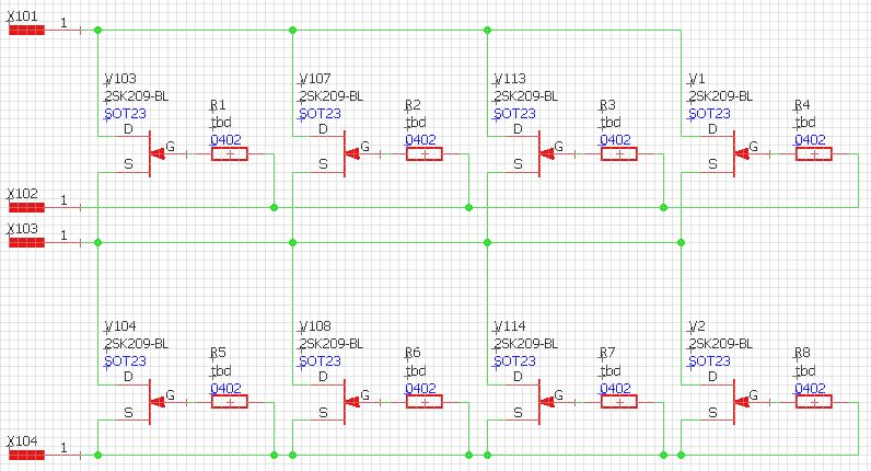

The simplest way to build a SEN today is to use 4~8x 2SK209 in parallel.
Very hard to beat for capacitances, and very tolerant for Vds voltages.
All Idss grades readily available at Digikey.
Just make sure you have gate stoppers for each FET, and thermally couple them.

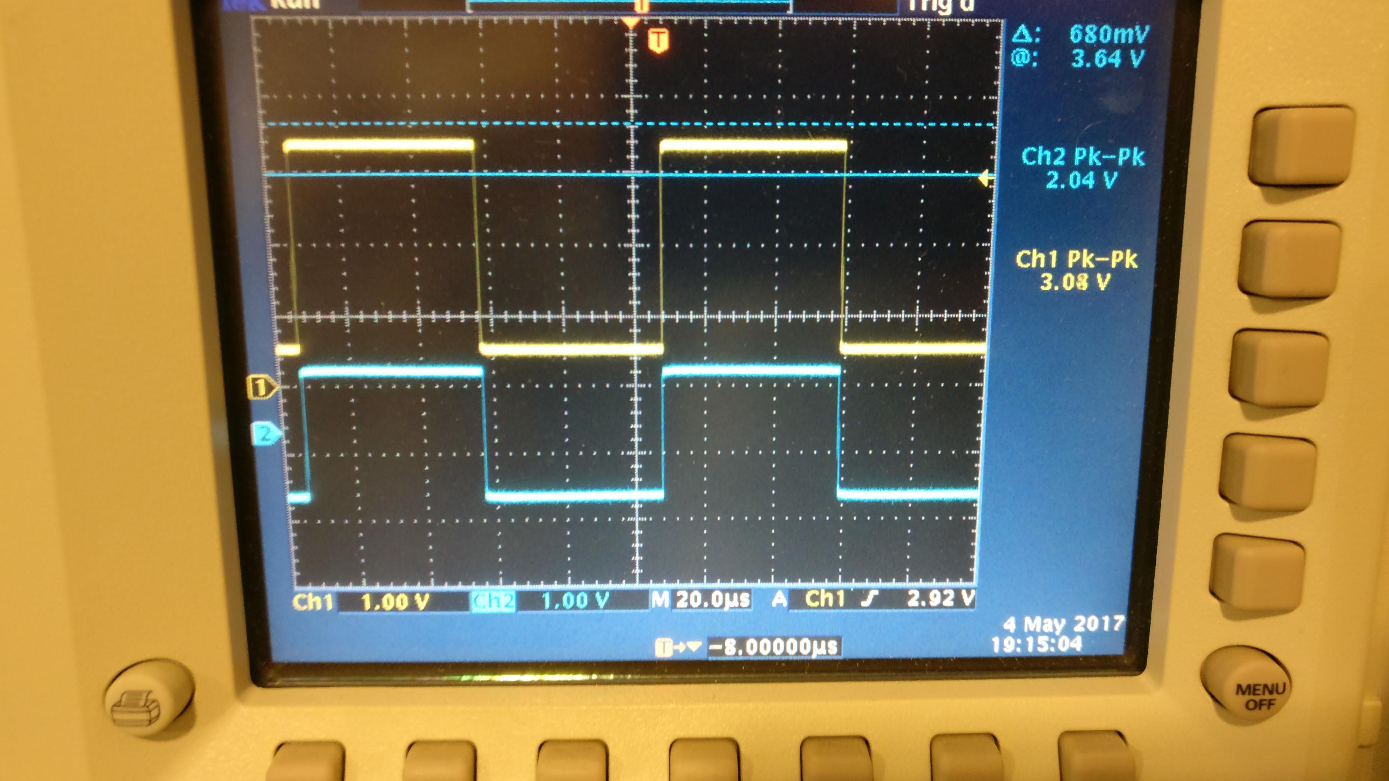

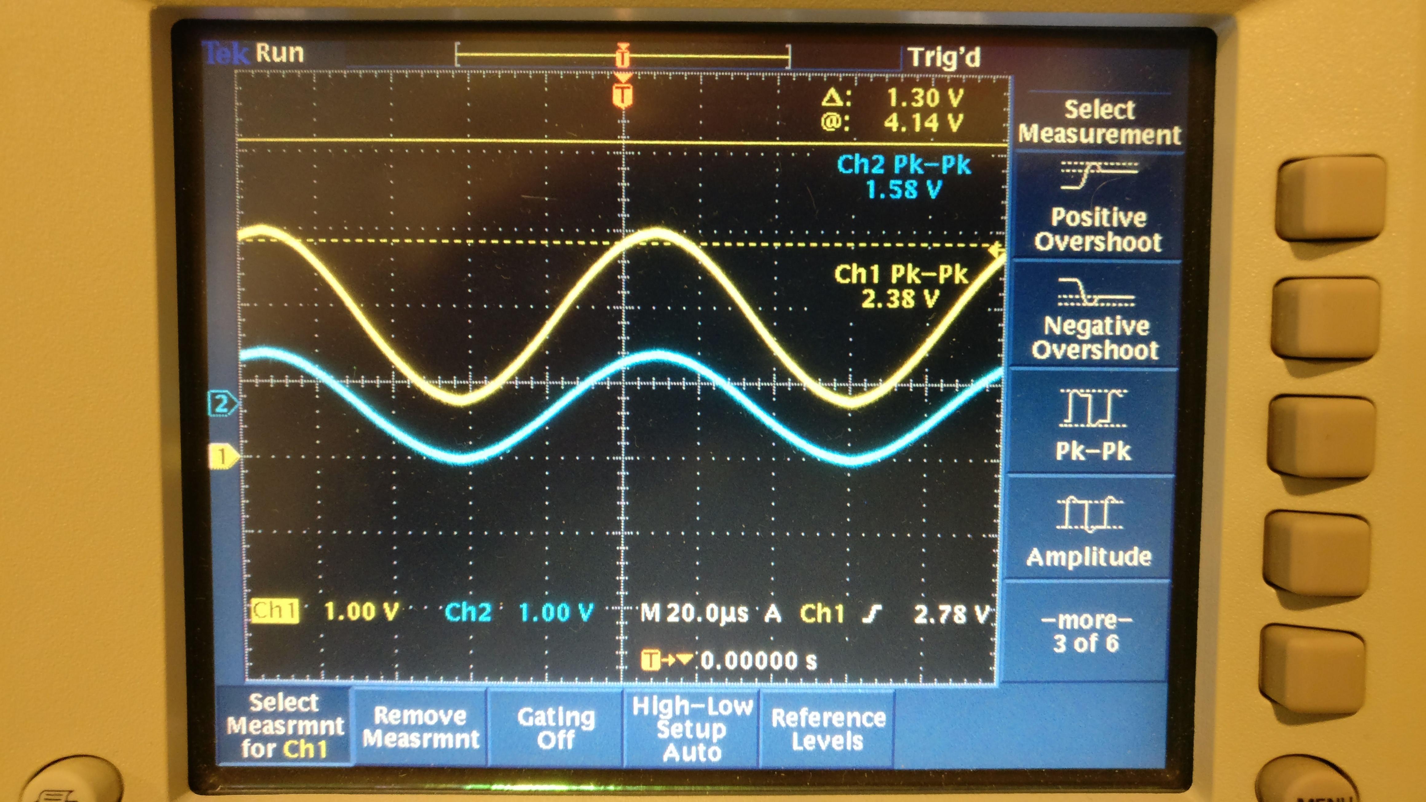

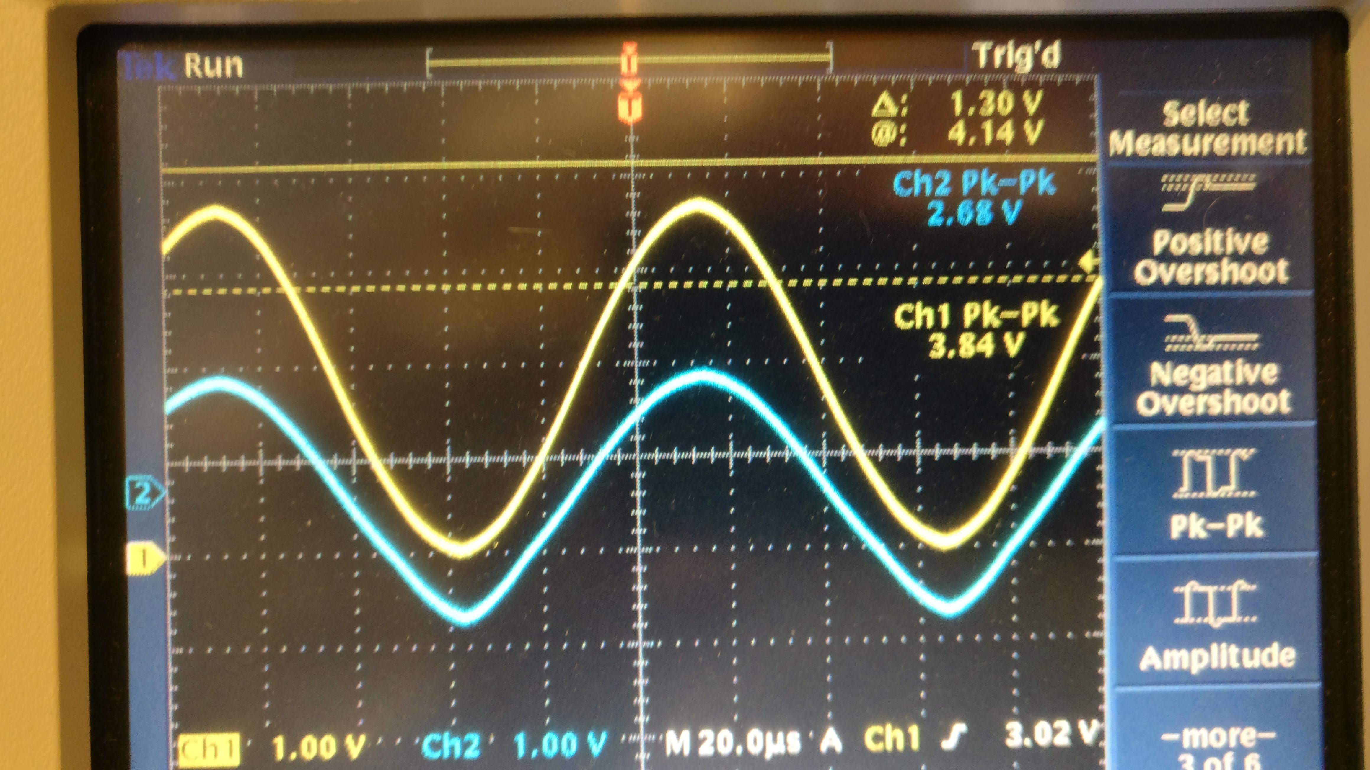

I connected the SEN to a signal generator through a 180 ohm resistor to simulate the output from the es9018 (should be 195 ohm but I did not have any). Vref was connected to 1.6 V to get the offset right. I have attached two photis of the oscilloscope. The first the yellow trace is the output from signal generator and the blue is the output from the SEN after Riv. It looks like the sine wave is distorted in the lower part. I have seen the same when playing a sine wave from the laptop to the SEN via the dac. The second photo shows what happens when I reduce the amplitude of the sine wave. It then looks like the distortion disappears.
I am running out if ideas and would really appreciate some help from you.

How much bias current (> 40mA) ?
Can you measure that between battery and circuit with a multimeter ?
Still the same distortion when you remove the Styroflex ?
Patrick

Maybe I am a little dense, but if a change of Civ from 300pF to 3300pF causes distortion, why do you suspect a perf board or power supply??
Jan

You have a current leakage somewhere in the signal current loop.
This can be caused by leaking caps, or damaged FETs.
34mA is enough, for 10mA signal.
You know the circuit works.
So you just have to trace one at a time.
Patrick

I recently decided to learn how to design my own PCBs using Kicad. As an exercise i figured it could be fun to make a layout for the 2sk209 version you mentioned would be the first choice today. So I am not sure whether to continue fault tracing the existing SEN or spend the time to make a new 2sk209 version instead. If some of the 2sk369s are broken I will probably not be able to find any replacements anyway.
True
Fault finding is a learning experience which will yield benefits in the future.
Patrick
