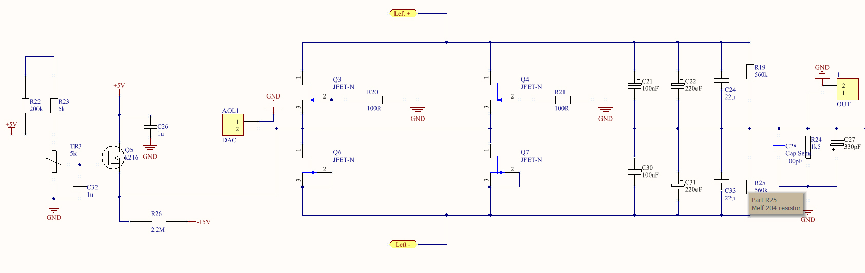

Cen with CCS for TDA1541A
Ryanj, any chance of reposting your schematic? I realize this is very old but getting into this very late...
Here are my schematics that i used to adapt the TDA1541A with the Cen current conveyor.
I've been able to get the DC offset on the DAC output quite stable (+-3mV max) but im still evaluating its performance and letting the new parts to settle in. The NTC Thermistor compensates for about 2 to 3mV drift from what i can see so far. It may be benificial to use a Thermistor with a higher Beta value, i used 3977K. 4570K may be better, not sure yet.

Hi fccn75,
I can't find the original file I posted but here is another one im using for a new PCB design im working on.
The jpg shows a CCS on the left and the SEN circuit on the right.
Ryan
You just need a low-noise, stable CCS from +5V with adjustable current.
So anything from a heavily degenerated JFET to normal NPN CCS will do.
2SK216s are difficult to get these days, and probably a bit overkill for the purpose ?
Patrick
