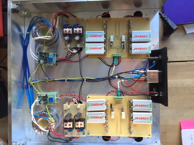

On the PSU side each channel has his own transformer that feeds a Super regulator for the analog supplies of the DAC and a TPS7A4700 for the digital supply. The IV are fed with four couples of 9V batteries. Next to each IV there is an LC filter; this is the big cap you see.
Attention has been put in the case layout. I wanted to achieve the same benefit of a dual case with one box, so I came with the idea of a kind of drawer with the AC part on the bottom and the DC and signal part on the top. All the rectification is done in the bottom layer. The batteries are charged with an external 19V laptop PSU when the DAC is off. There is a relays system that do that.

The digital source is an Amanero board that goes to a I2S-PCM board (Ian). The latter feeds two AD1865 DAC, one per channel to get a balanced output.

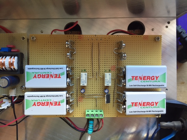

Battery Board
These two pictures are the B side of the DAC and a detail of the battery board. One board serves two SEN, with 18 V or 27 V with two or three 9V batteries. The output goes with wires to the DAC board, without binding post. I ended up soldering the batteries to the contacts for better stability.
You can see two pairs of binding post. The one with the resistors goes to the connector for the Laptop PSU that works as charger. The value of resistor has been selected following EUVL trickle charger posted in this thread.
Basically when the DAC is off the relays are not powered the battery packs are paralleled and connected to the charger. When I switch on the DAC the relays are powered, so the batteries are disconnected from the charger and connected to the I/V. The relays are controlled by the second pair of contacts. On board there is a 7805 regulator, so basically I can feed whatever to control the relays. What's still pending is a system to monitor the charge level of the batteries. From experience it will take a while to realize that the batteries are too low, mostly if you listen continuously.
It's also true that it never happened to me to flatten the batteries in a single session, but it's nice to have indication that you forgot to charge it, or that a cell has a problem. I used a simple circuit (also posted some time ago here) and it does the job. I will probably add it to the board. I was trying to think the best way to arrange it, in a way not to create an antenna to pick all the possible noise around.
Let me know if you need more info. I think that the 18.5V cells for model cars or drones would be easier to implement, but they cost something like 50 euros a pack. So I'll use as ultimate solution.
