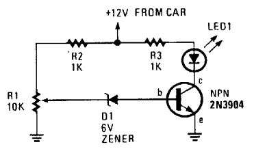

additionally, do you have some fancy way to monitor the status of the batteries ? I am thinking of putting a transistor hanged with a zener between the poles of the batteries, so that a led is on when the voltage is over 14 V and off when the batteries go below. Still have to work out the details, but it should not be difficult and it look to me the only easy way to have an indication with the supply still floating.
D.
Something like this,
D.

There is in principle one possible solution :
You can use a single supply to energise two high power LEDs.
These are then use to generate about 30mA 18V using photovoltaic cells.
The floating photovoltaic cells can then be used to power the IV circuit.
As far as I am concerned, battery is easier.
But Joachim Gerhard has posted a floating supply before (somewhere in this thread ?)
Patrick
