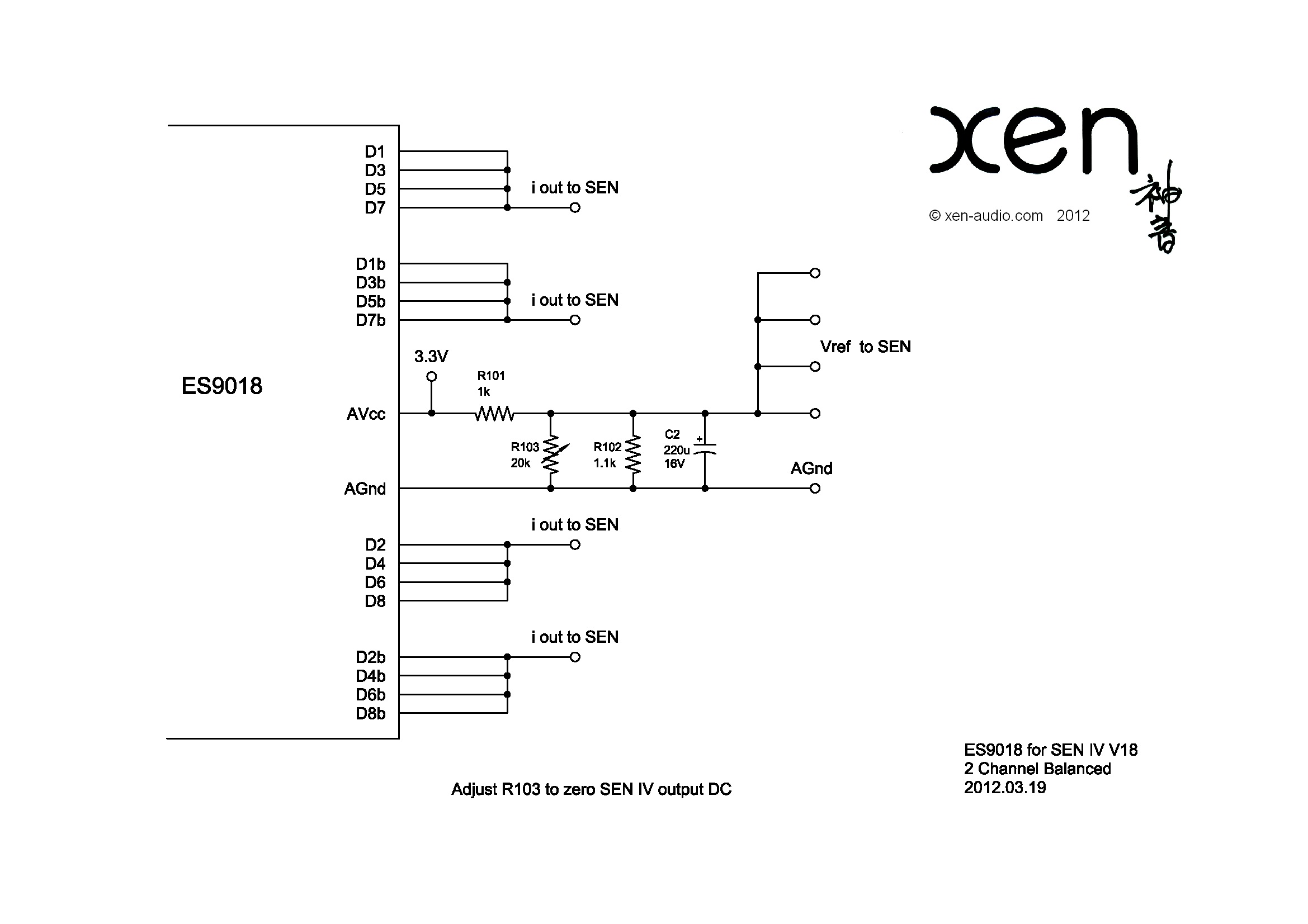

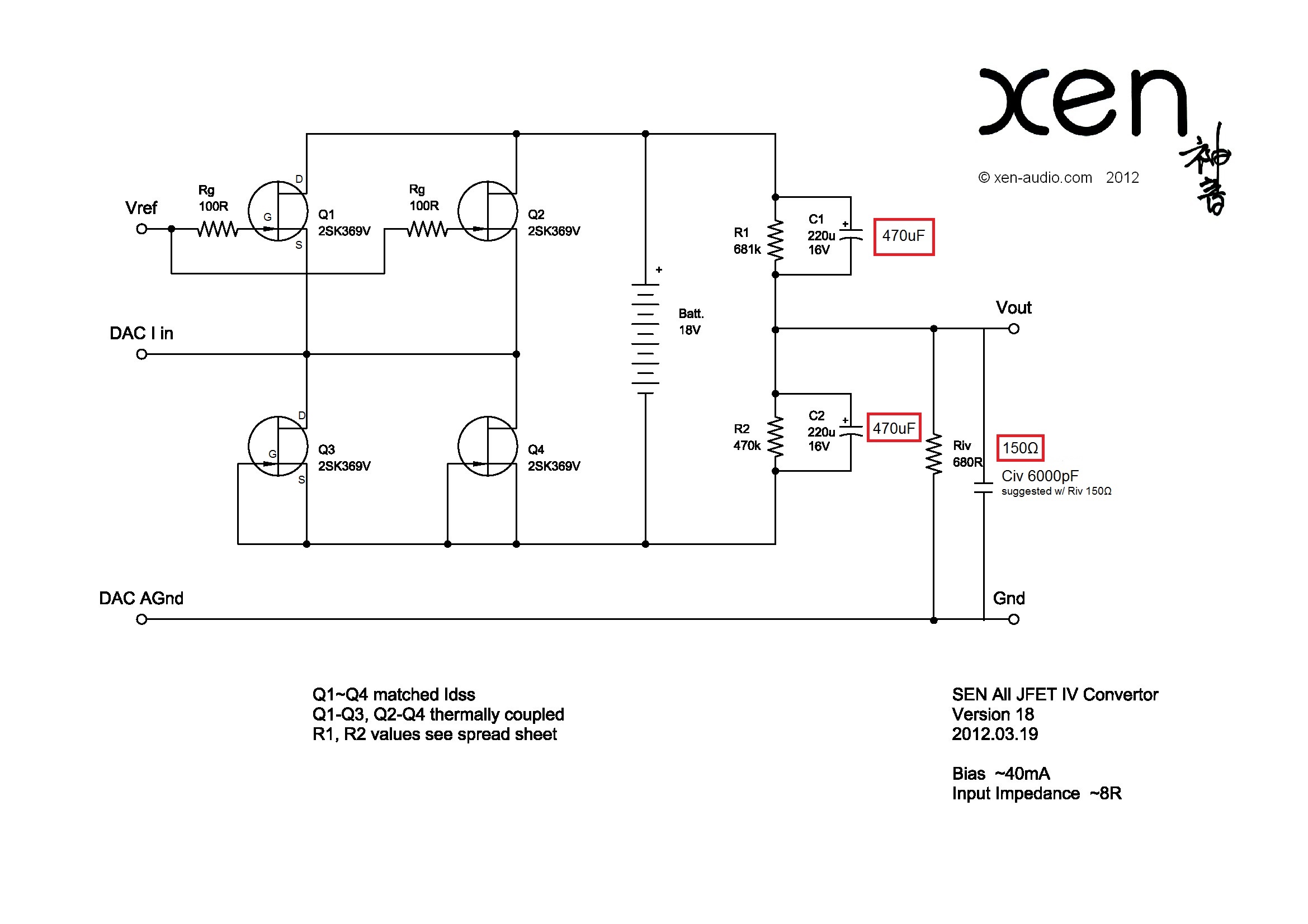

For the first time in years I have had some time for diy projects again. My SEN V18 has been running fine for almost five years now despite some hum which I was able to solve recently. I have soldered Riv and Civ to a small perf board close to the output connector. The quality of that perf board is not very good and last week I lost one phase of the right channel due to that. I thought I should redo that solution and started to think about values of Civ and Riv. I realized I did not adjust Civ for the lower Riv used with the BIII. I am using 200pF and 330 ohm. When looking at the schematic just posted I noticed that the value for C1 and C2 is changed to 470uF while I am using the standard 220 uF. Should I change that?
The es9018 in stereo mode have 16mA pk to pk. With 150ohm Riv that will give 2.4V pk to pk. Which gives an amplitude of 1.2V and 0.85Vrms (SE) if I am not mistaken. Isn't that a little low?
You need 390 ohm high quality resistor for 2V rms, unbalanced for BIII. I'm using 1000uF Nichicon ES capacitors. Capacitors are larger so some of the components should be on bottom side. You can use one of the existing pad and drill another hole in copper free area then bend lead to the other pad after cap mounting.
If you are actually doing dual mono (one Buf III per channel) then you will probably need to do point-to-point as there isn't (or never was) a board for that.
I know that I have to add components to the V18 boards to get it to work with the BIII but from what I under stand when you put the BIII in dual mono mode it parallels the dacs in the chip so I shouldn't need more that two V18 eval boards correct? Or di I have to change values in the ess9018 scematic?
I don't think you will have to do anything differently.
You will have twice the current swing going in and out of the SEN so I think the only thing you need to look at is the SEN I/V resistor to get the desired voltage swing.

If I remember correctly the maximum current output from a dual mono Buffalo is too high to maintain low distortion with the dual paralleled lsk369 fets recommended for use with a stereo Buffalo 2 or 3. You could add two more but, apart from the need for 32 matched devices the input capacitance of the stage would rise unacceptably.
To be honest I've never understood the appeal of the dual mono arrangement. All that extra circuitry for a surely inaudible increase in s/n ratio. Any sonic advantage perceived, if not just expectation bias, must come from separating left and right processing into two separate chips I suppose. And Russ at Twisted Pear has reported that the output level between ESS1018's is highly variable, negating its theoretical benefits, if I've understood correctly.
Apparently the new ESS1038, to be used in buffalo 4, has a much higher output current level, too much for Sen, or Legato or Ivy for that matter. Russ has designed a completely new I/V stage to cope.

You can use a pair of LU1014 triode cell at 200mA (or more) to make up a SEN.
Can swing any voltage / current.
You can also use 16x BF862 cascoded by J111 in parallel.
Very low capacitances as well.
If that is not enough, you can also use the Zen V9 LU1014 triode cell.
I believe the bias is 1.3A.
Patrick
> But you can use a high value R_iv (in TO220) to output say 20V from a 9018/38. And then you can follow it by a normal DAO to drive headphone directly.
Without an additional gain stage (HAGS).
I might try this with an ES9018 as I anyway have a balanced DAO on my plate and Buffalo's in the drawer 😉
No point, unless you have a lot of output current.
The LU1014 has high capacitances, and the penalty is gate current induced distortion.
If you want a high output voltage from ES9018, just cascode the 2SK369s with say a 2SK2013 at Vgs 9V.
You will of course increase your supply voltage to cover 2x cascode plus the high voltage output swing.
Probably something like 60V.
