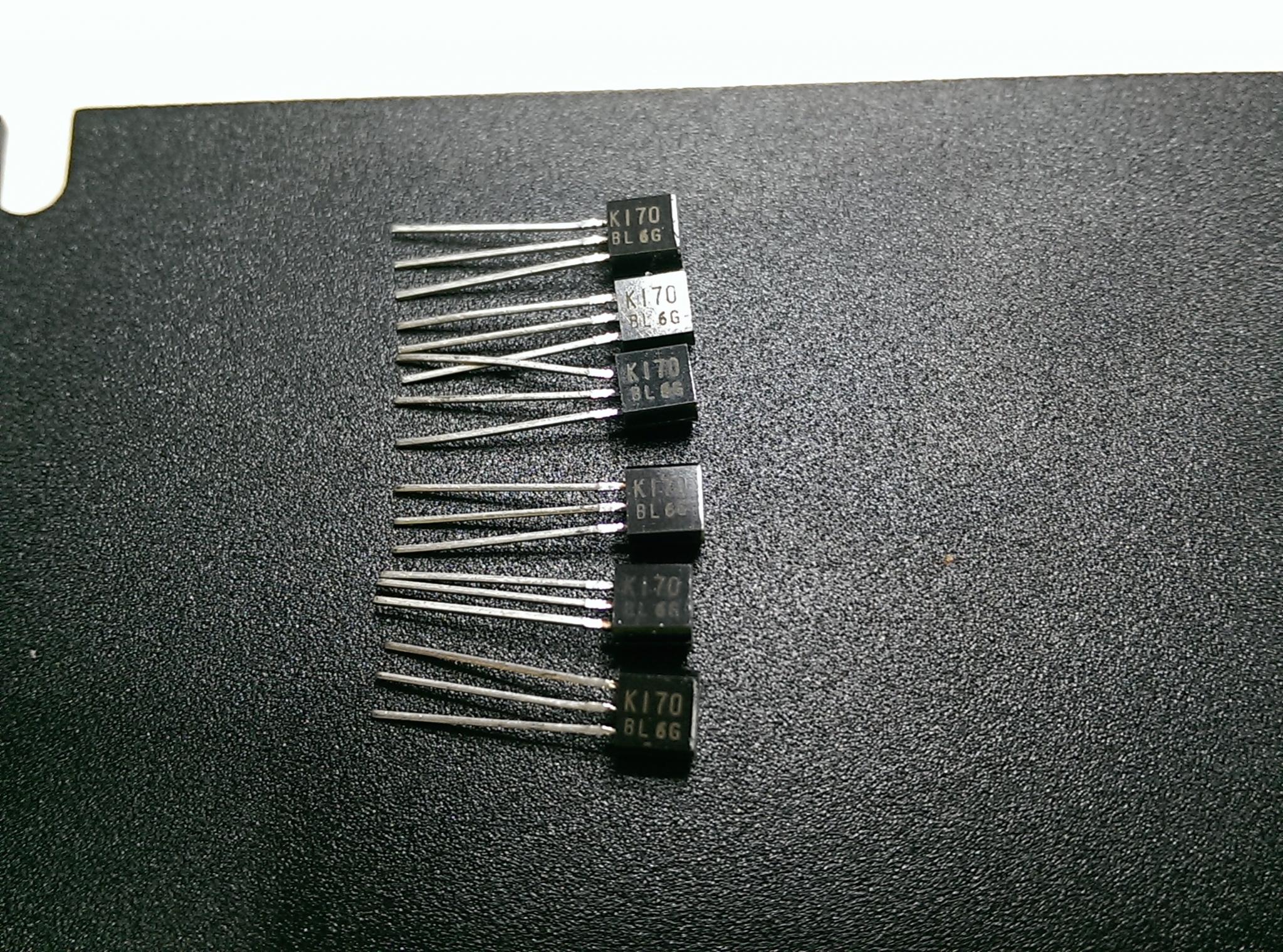

Just to doublecheck:
I am building a SEN for the AD1865 Balanced with 1mA current output. I have 4 pairs of 2sk369 already glued on the heatsinks that I wanted to use. Reading once again the article it sound to me that the need to parallel two pairs in the SEN is not only to achieve higher current, but also to lower input impedence. The input impedence of the 2sk170 and 2sk369 looks the same from the datasheet, so do I still need to have a total of four devices for each phase for my application or can I just get away with one pair of 2sk369 ?
Thanks,
Davide
The 2sk369 is the same as two sk170's in parallell - so one pair of 369 gives same result as two pairs of 170's.
Regardig current. You should look for 2sk369V they are 16-30mA i think. BL grade would give to low current, if you dont handpick the highest rated ones.
